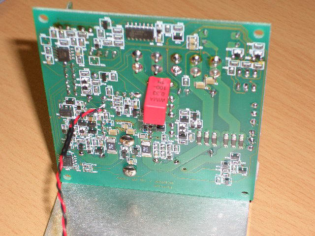

To answer Chris's question. One is mounted on the top of the PCB and the other on the bottom. The one on top fits very nicely in the position of the original cap.
Best regards
Gertjan
Mike2 said:Here is a shot of the Wima's on my v5 boards. My new v6 boards have the red Panasonic caps so I will be able to compare them with the Wima's. Also installed a separate PS and regulators for the Op-amps late last Friday. Only about 50 Hrs. on them so far but the sound is very good. I will post more on this later.
Here is a picture of my PCB. You can see the additional wima cap. I also soldered a twisted wire to the + and GND over the 10uF 100V snubber cap to measure the supply rail.
I will post pictures of that later.

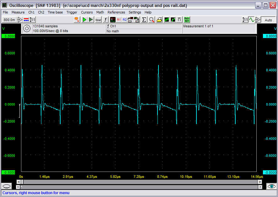

This is the waveform on the + supply rail (no signal at input and 8Ohm dummy load connected) with the standard 470uF caps (Nichicon VR(M)).

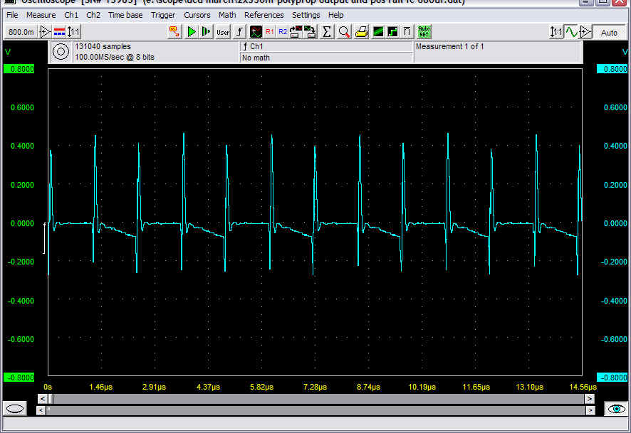

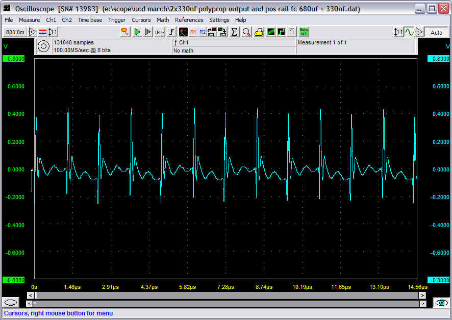

This one is with 100V 680uF panasonic FC.
Not much difference, almost the same. Maybe with an input signal, one can see a difference. May try that on one of my other modules sometime.
What one for sure not should do is putting additional polyprop caps over the FC caps, this gives you a nice oscilating waveform due to the parasitic inductance of that FC cap and the polyprop (330nF WIMA) forming a high Q LC filter/resonator. This could be killed likely with a snubber, but that makes things just complicated. The polyprops also do nothing to reduce the spikes, so no benefit.
