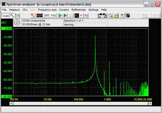

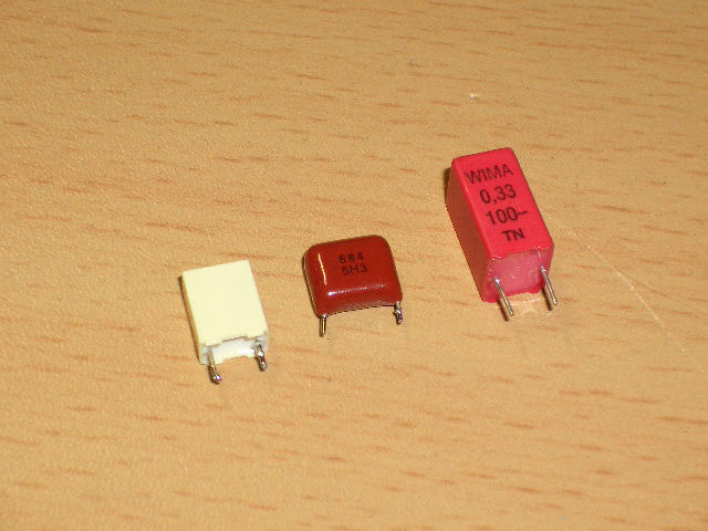

I measured a few output caps
Hello all,
I measured the influence of a few different output caps on the output signal of the UcD.
I used an almost standard UcD400 and measured the output signal of the UcD with a pc-based scope (50Mhz 12 bit sampling, 0.8V range) without applying any input signal.
I tried 3 different output caps.
1. the standard white cap
2. the read cap that comes installed on the newer modules I believe, I think that is a Panasonic ECQV series cap
3. 2 WIMA 330nF 100V MKP2 (polypropylene) in parrallel
Attached is a picture showing all 3 caps
I will show measurements in the next post

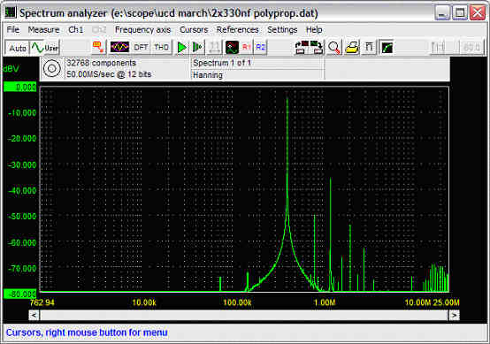

Re: I measured a few output caps
The measurements attached show an FFT using 32768 samples for all 3 caps.
It can be seen that the panasonic cap performs slightly better than the standard white cap as the high frequencies above 3 Mhz are slightly better attenuated.
The 2 WIMA caps perform even better in that respect as the HF components between 3 and 10Mhz are below -80dBV and the components above 10Mhz are about 6dB lower as for the other caps.
Further interesting to note is that the peaks at about 400kHz, 1.2Mhz, 2Mhz and 2.8Mhz are higher in amplitude than for the other caps. This may look bad but is actually better. I calculated that the signal at those frequency components is actually closer to the expected value when you assume a square wave of 400kHz going into the LC filter that drops off with 12dB/Oct. The fact that the other caps show lower values at those frequencies indicates that there is more jitter with the other caps, thus a somewhat varying oscillation frequency resulting in the peaks to be smeared out a bit so that they look lower. So it looks like the WIMA caps behave more like the ideal cap, also nice that the filter out more rubbish above 3Mhz.
I have not listened to these caps yet 🙂. I plan to experiment with the 470uF caps and replace them with others and measure the effect in a similar way, maybe measure the voltage over those 470uF caps.
Best regards
Gertjan

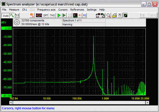

Re: Re: I measured a few output caps
This is with the panasonic
Best regards
Gertjan

Re: Re: Re: I measured a few output caps
This is with the two WIMA caps.
Hi Gertjan,
Excellent work, thanks for sharing.
Do you suppose the Wima perform better and are more stable in frequency due to having two in parallel and thus lower ESR? Also how were they mounted, one on top and one on the bottom?
I'm sorry if I missed it but what was the input signal, or was this done at idle? Might be interesting to step the input/amplitude. Maybe we'd get to see the microphonic effect begin to appear with the stacked film or something?
What 470nF are you going to try?

It takes much care in measurement setup to get good "apples-to-apples" comparisons. To keep the noise floor out of the picture, the basic measurement must be very clean. This is probably best done using a 'scope tip jack (facilitates a "zero" length ground lead) soldered in-circuit at the measurement point and a common mode choke installed on the probe cable (wrap it several times through a high perm ferrite toroid). Also, the fft time window probably must be carefully realigned for each measurement as the UcDs operating frequency will vary slightly with variations in the output capacitor's value and ESR (this could explain some of the subtle differences in the harmonic ratios and "noise" floor prior to the first peak, etc.).
Just a thought. -- analogspiceman

So yeah the two red ones are the coupling caps, get ride of them or upgrade them (you've seen the warnings etc)
Yes the blue cap is the bootstrap cap.
Black ones need to be high ESR, I haven't changed mine.
Blue stripped is the filter cap, upgrade it! Black stripped are the high voltage local supply/decoupling caps, take your best shot with those, they can change the sound a good deal.
Here is a shot of the Wima's on my v5 boards. My new v6 boards have the red Panasonic caps so I will be able to compare them with the Wima's. Also installed a separate PS and regulators for the Op-amps late last Friday. Only about 50 Hrs. on them so far but the sound is very good. I will post more on this later.
classd4sure said:Hi Gertjan,
Thanks,
Chris
Hi Chris,
The two in parallel may actually be a factor, this should lower the inductance and the caps itself have a lower loss, and thus a lower ESR already.
There was no input signal as I wanted to have the FFT as clean as possible, not modulated by an input signal.
With the 470nF, I mean 470uF for the power supply decoupling caps. Thinking of trying panasonic FC 680uF/100V but also have some other caps lying around.
Best regards
Gertjan

Mike2 said:Here is a shot of the Wima's on my v5 boards. My new v6 boards have the red Panasonic caps so I will be able to compare them with the Wima's. Also installed a separate PS and regulators for the Op-amps late last Friday. Only about 50 Hrs. on them so far but the sound is very good. I will post more on this later.
Are those the same WIMA`s as I`m using?
Gertjan
