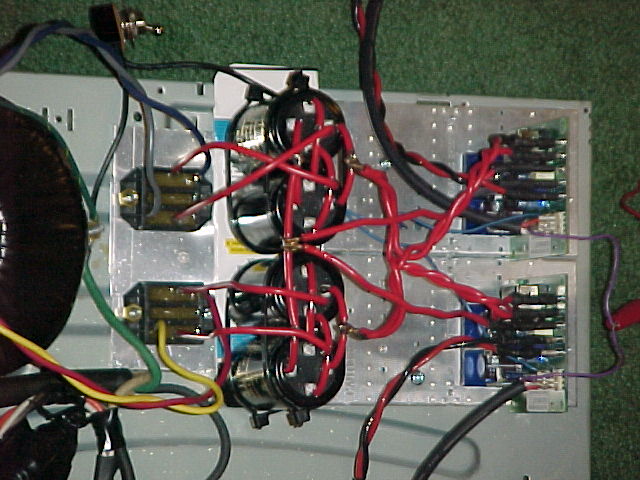

maxlorenz said:Hi Chris:
You tied TX's center tap to safety ground?
Regards
Mauricio
No, what you see tied to ground is the static shield from the transformer, and of course the enable switch.
The supply is fully floating. There really is no center tap at all, only the common point which floats from chassis and serves as power ground for the modules.
Signal input is also tied to chassis. Can highly recommend this kind of supply.
classd4sure said:
Slit foil, no that's unique to BHC. I'm using T networks from Jensen, available at partsconnexion. I do have a pair of the BHC slit foil /T networks, got them from LC audio.
I think you did what I was thinking about. I assume from what I can tell that you have the 4 ports in parallel.
A bridge for each rail, correct?
So you like the jensens better than the BHC split Foil T networks?
I assume you've tried the T networks, right?
thanks
Mike
thanks
Mike
Yeah it's a standard high end supply, not a new concept, but you're right to go that route for sure.
I have two 4 pole caps in // per rail.
I didn't have enough of the BHC's to make a direct comparison, but they are what sold me on the 4 pole technology, and so I got the Jensen caps since they're close to home.
They haven't let me down at all, and I"m very happy with them. It's a sure path to an ultra revealing amplifier with very fast response. Really can't say enough good about either of them, simply must be tried to be believed!
The only complaint I hear from people is they're so expensive but.... they're a steal for what they are. Compare the cost to black gates, or the new auricap.

Anyone suspect the "low voltage decoupling caps"? I have a nasty HF piercing noise that I previously thought was due to one of the many tweaks to my other components. Yesterday I discovered that the base of one of the little caps (wich I think but I'm not sure is decoupling cap) of my UCD180ST V2 has oxide. I didn't had the time to check the rest of the caps. I may put some BG there.
It would be nice to see some diagrams showing the parts from the different UCD versions. I know my UCD400 but my older UCD180 are a mistery to me 🙁
Mauricio
Welcome, BTW I should fairly state that I can't say for certainty whether or not it's the decoupling caps or the stacked film (stock) filter cap that's responsible for the phenomena I experienced near clipping, and due to some bad luck won't be able to tell you.
So you changed the decouplling caps for the input stage to BG's?
That spot uses high ESR coupling caps for damping HF oscillations... might want to change them back.
Also, this could be a direct result of having floated your signal grounds, if they still are.
