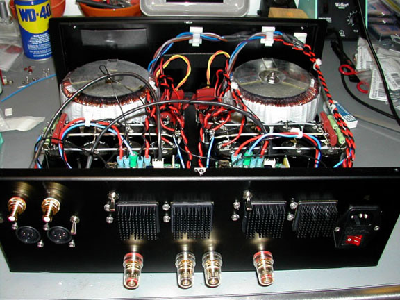

Julien,
That's one of Ken's cases isn't it? I'm going to order a E100 from him soon (he's got the 100 drilled for UcD as well now!)
No dual mono here, Single 500~800VA and a hypex HG PS, no mods. I don't have the stomach to alter the modules, I'm declared a public enemy when I'm soldering stuff :hot:
Julien, btw, on your UcD schematic, bottom-left, there is a circuit with R3, D3, D4, what's that for?
and...
transformer based volume control passive pre, any DC that might be coming from my sources is suppressed
Could the input caps be removed and replaced with 1:1 transformers? Or is better to use higher quality caps?
Yves Smolders said:
Julien,
and...
Hi Yves.
Yes that's the E130 case from Ken. I wanted a bigger case for better ventilation and for future upgrades and experiments.
I'd get the biggest transformer you can fit on the E100 case. The price difference is usually small. 650-800VA should be good.
The circuit you mention is there to lift the earth ground from the circuit yet providing a safety path to ground in case of an emergency. It is very effective in preventing ground loops.
Now, for the input caps, I'd use good quality polypropylene film caps such as Auricaps.
Hope that helps,

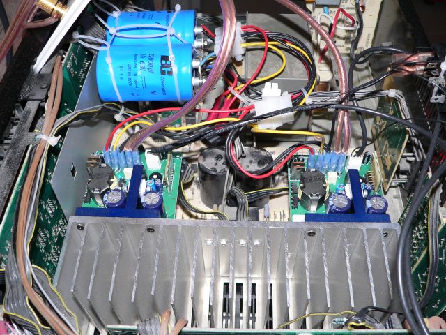

ClassD,
You're right if you look at it commercially, the time spent to find out how to make the amp etc. etc., it indeed took me hours.
However, I didn't research commercially: these hours weren't lost for me, as I now have a nice working amp. Nobody had to pay me for this time, it was for myself.
So looking at that, I could build some amps as a "side-job", and only have to look at material price and maybe the time needed to assemble them. I'd have some money on the side that way, even could do it officially. 😀
About the module placement: Of course with the PCB horizontally, I mean horizontally with the T-sink facing up, that's how I have them now.
The thing that seems to heat the most this way is the transistor at the bottom of the T "leg". One module seems to run hotter than the other.
With the sink I use it seems to be allright though, I can touch it just after turning off the amp without problems.
Let me include the photo and see what you think. (don't mind the other components, it's mounted in an old Akai 80's vintage amp, it has a nice big transformer and I can use it again later 😀 )
As for "upside down T", I was thinking of screwing the modules to an aluminum base plate , meaning that the part of the T were the bolts normally go is pressed against the base plate. I'm not sure if that would be ok, but I would consider it in a small space.
Roger, congrats, I honestly don't think I've been accused of that yet 🙂
Yves,
Honestly I see from your amp you haven't yet been through the experience of ordering everything you need to make one from ground up, there's alot of people with their hands out from start to finish.
...grumble..... dust those caps off... /grumble 😀
You have your modules mounted the right way up, I see I misunderstood how you had them. It wouldnt' be the best way for convection cooling though because the air would have to flow around the PCB and create a little still pocket above it, that's why a vertical pcb is better. Only way to fix that in a horizontal mount would be with forced air or .... drill holes in the PCB.... I dont' recommend that though. But yeah it's not anywhere near as bad as having it horizontal and upside down, high up in a sealed case. The case should really be vented.
A plate about the thickness of that sink you have, less the fins on it, would be about right I think. If you mount it with a vertical PCB then you're doing away with the still pocket of air and convention cooling will be improved.
The more thermal mass you have in it the better though, so instead of just using a plate, consider making it part of a very thick case. Yup, more money, you bet!
Can you not keep your hand on that heatsink with it running? I'm just guessing about 80W going into it. I'm thinking if keeping your hand on it brings tears to your eyes and burns to your finger your mosfets have got to fry, but thats' not very mathematical..
One module is hotter than the other because they're tuned individually at factory for best (didn't say lowest) thd, and with the different parasitics and component variations, having one a little hotter than the other seems natural.
The plate/case method seems what most people use so I'm sure you can trust it, still recommended by hypex, the min. dimensions of such a plate are given my Jan-Peter someplace in the UCD400 thread.
Chris
I know, it's the ugliest UcD alive at this moment without a doubt, still it sounds like a million bucks! Well... at least it sounds like a 2000$ Class-AB 😀
The dusty "vintage" caps in the middle aren't running in this circuit...
If only I had the time... time... isn't on my side! :cannotbe:
The temperature is quite low actually. Just went through 2 hours "Phantom of the opera" in DTS, (amazing sound on that DVD) and my receiver was running quite hot, even just from running 3 channels.
The UcD felt just like it's idling 😱
