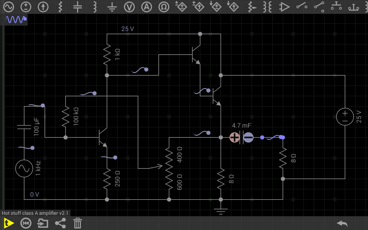

Have taken the liberty of ressurecting this thread. Inspired by some of my earlier lessons from various members, I have come up with a draft for a similar class A amplifier. It is intended that this would be preceded with a preamp stage as it has a low voltage gain in itself. Comments and recommendations are of course encouraged and welcomed.

Well it should work, but, how well....
I should be able to run a better simulation when i get my PC up and running with LTspice, this circuit was simulated with a very basic program / app called Every circuit that runs on my android tablet. There is no visible distortion with a sinewave input, though I have no idea about stability ac or DC, though it is intended that the diode in series with orange led should be thermally coupled with the
CCS transistor, to provide some degree of temperature compensation.
I know it will need a fair bit of tweaking, but this was just a rough draft and I was determined not to give up on what I had started out to do. I have pages and pages of half completed projects / experiments and want to try and see this through to completion even if the end result won't be worthy of any awards!
I must admit I'm still attracted to the emitter follower with resistive load idea that I started out with despite its obvious disadvantages.

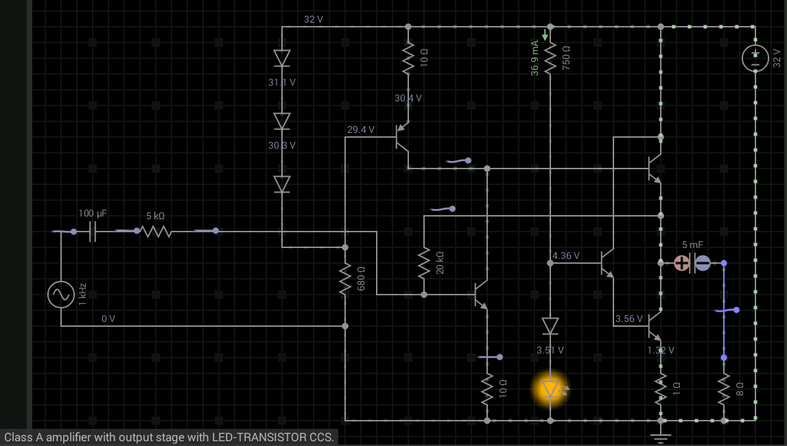

Another variation, closer to the original circuit, but with some negative feedback. Also it is intended to be built with a 2sc5200 as the output transistor which should have hFE around 100 at the operating point. The driver transistor should be a high gain device too to minimize loading on the VAS.
Nothing wrong with this at all. This type of circuit sounds great, just not practical above a few watts.
The second circuit should fair better than the first over all. Might as well throw it together and see what it does.
