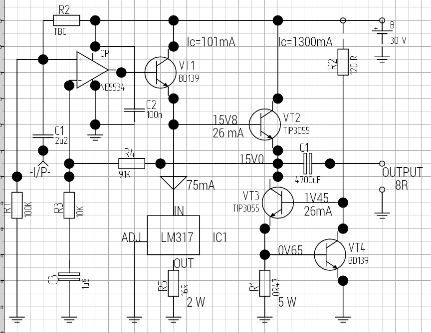

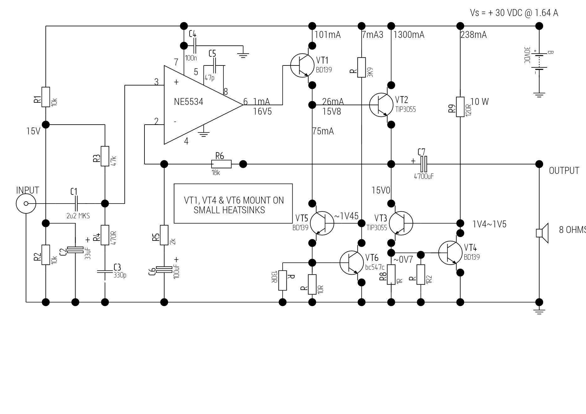

A proper schematic!
Joy of joy, I have found a schematic capture app for my android tablet.
Attached is the latest draught of the amplifier, haven't built this yet but planning on tomorrow.
Again any constructive criticism is very welcome.
Plus:
Include ~470R of series resistance and ~330 pF to ground at the input for better EMI suppression.
Should you find insufficient supply hum rejection, use a somewhat more elaborate filtered voltage divider setup (e.g. 10k/(10k||22µ) tapped via 47k).
R3/R4 are on the highish side, which may result in ultrasonic peaking due to opamp input capacitance (noise and added distortion would be insignificant here). Either include a parallel cap for R4 (~30-ish pF for a ballpark figure) or reduce values by maybe a factor of 5, with a 'lytic (or two polar ones back-to-back) for C3.
'C1' is used twice.
I hope you're well-stocked in terms of heatsinks and/or insulating washers/pads.
The basic design seems sensible though, it looks like something that should work well within its limits. At these lowish supplies, do not entirely discount oldschool power transistors. BD243C or TIP41C may also be worth a shot if you have some floating around.

On second thought, this doesn't seem right. It would have to be more like 0.33 pF.Either include a parallel cap for R4 (~30-ish pF for a ballpark figure)
Anyway, if you really want to keep feedback network divider ratio the same as far as possible, you can always add parallel caps to both R3 and R4 with their values inversely proportional to resistor values. So maybe 5 pF for R4 and 39 pF for R3. Opamp input capacitance tends to be in the 2-5 pF ballpark, and 39 pF should easily dominate it.

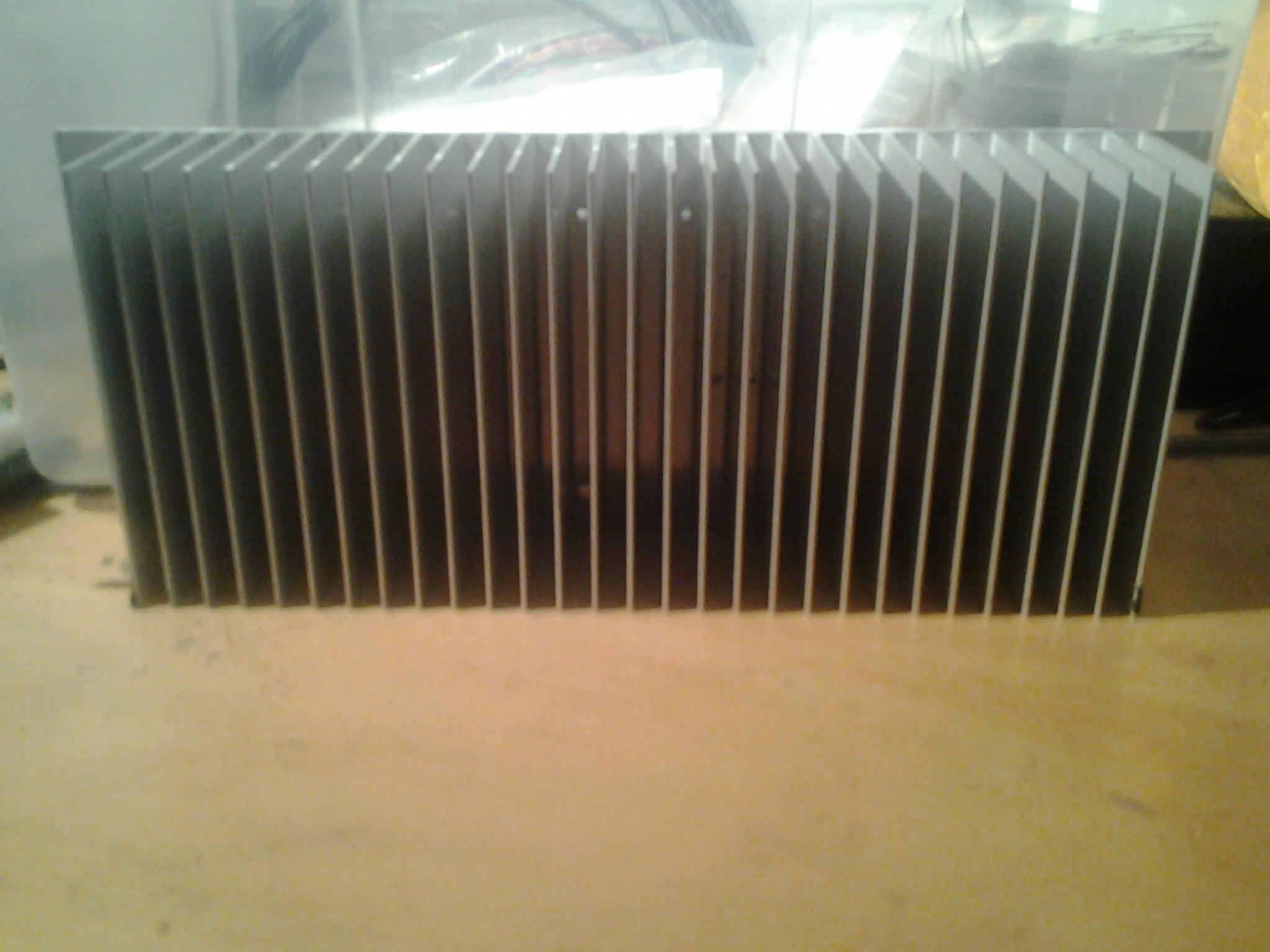

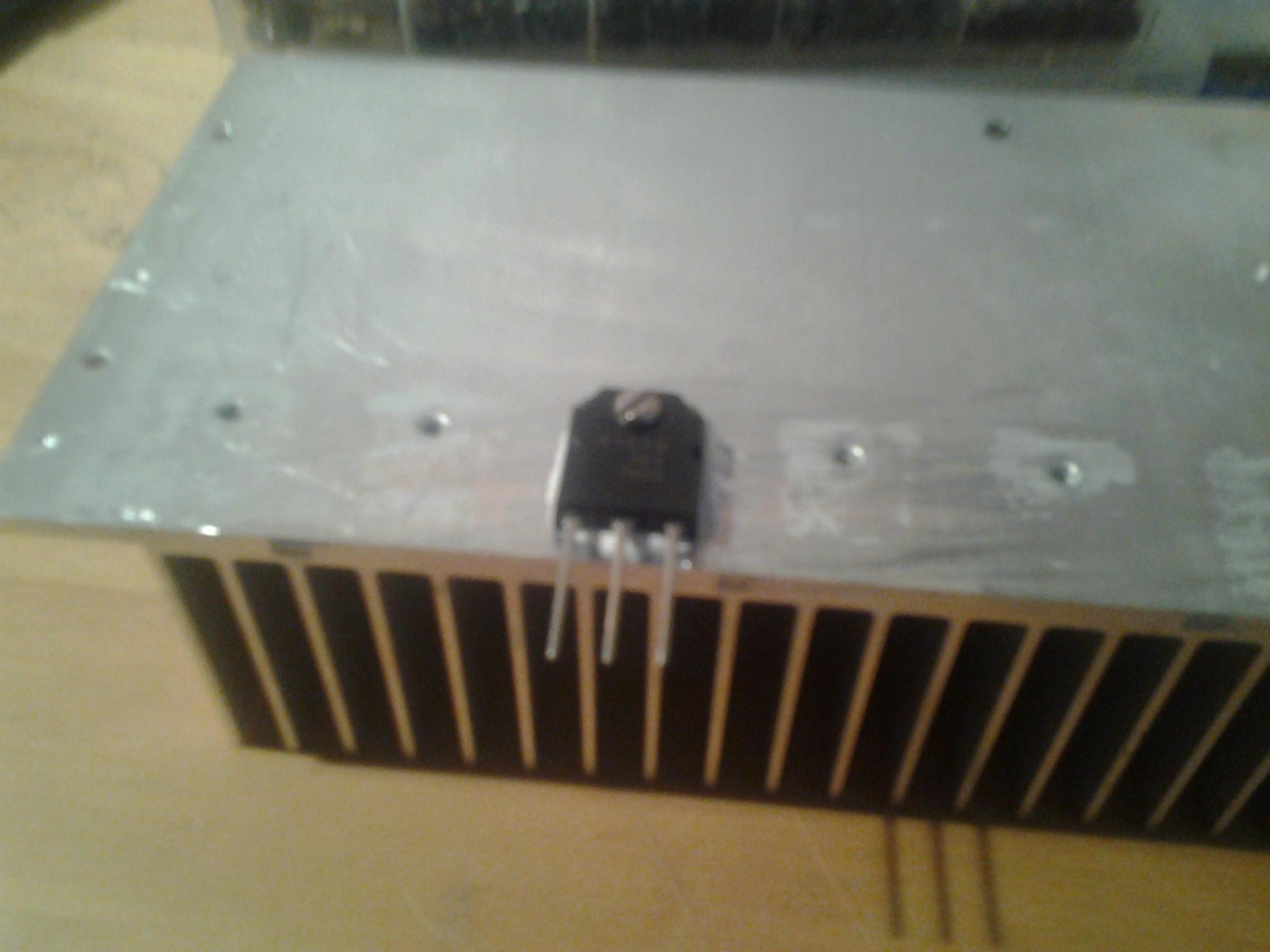

Also, I think that the heatsink is big enough, see attached pictures. I got it used for only 5.00 GBP, about 7.50 USD, so I don't actually know the °C per watt rating, but it was from a 350 watt audio amplifier.

I've attached the two tip 3055's to the big heatsink and put small heatsinks on the bd139's, nearly ready for a second trial run. As per jerluwoo's suggestion I'll start of at 1A standing current and see how it goes from there.

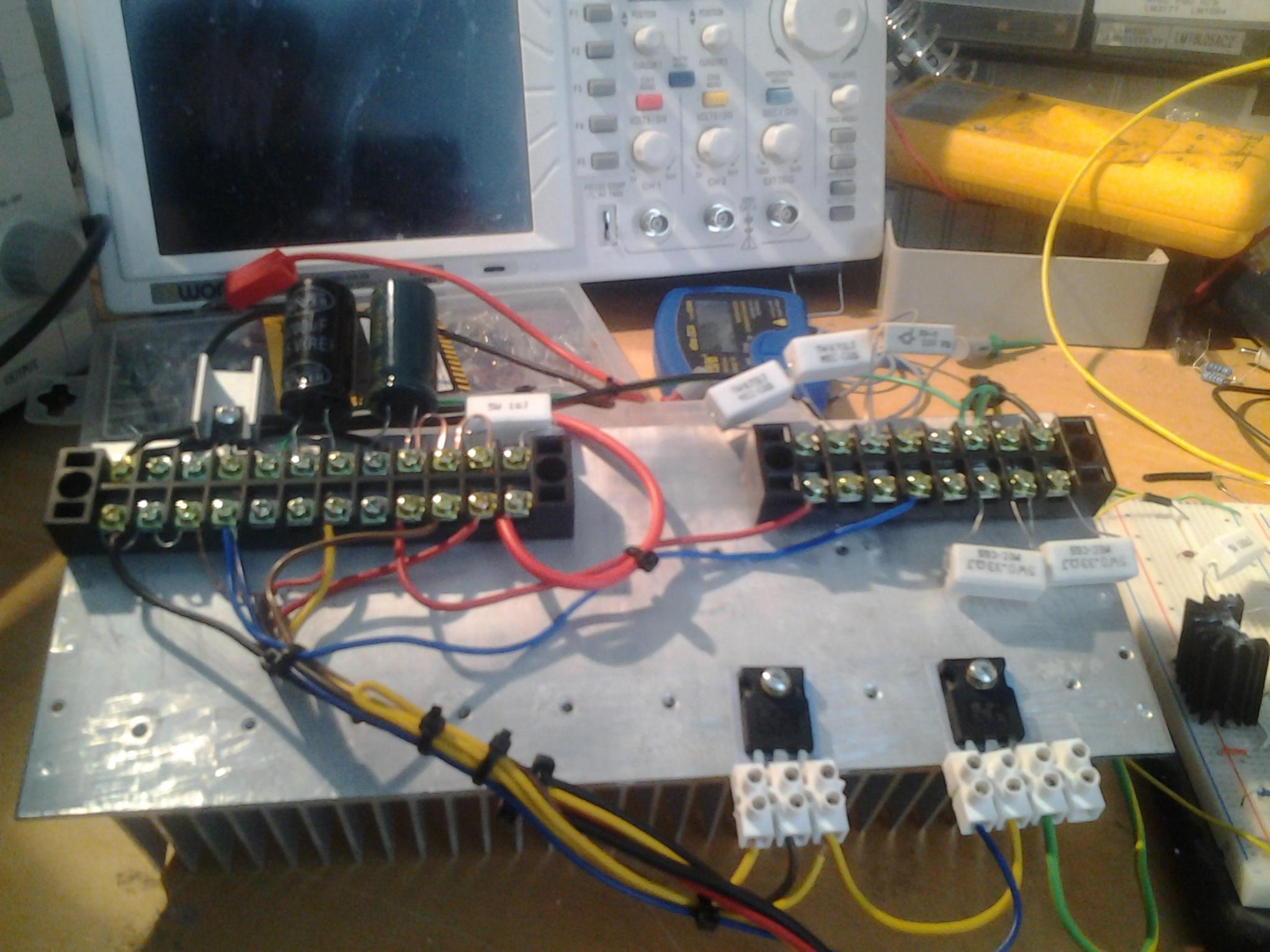

All of the output stage is wired up now, see attached photo.

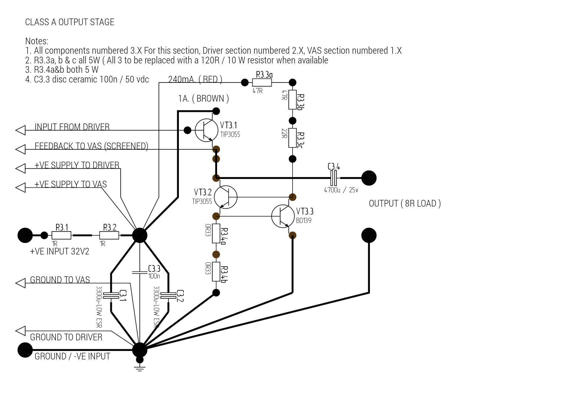

The second image is the output stage wiring diagram, with comments.

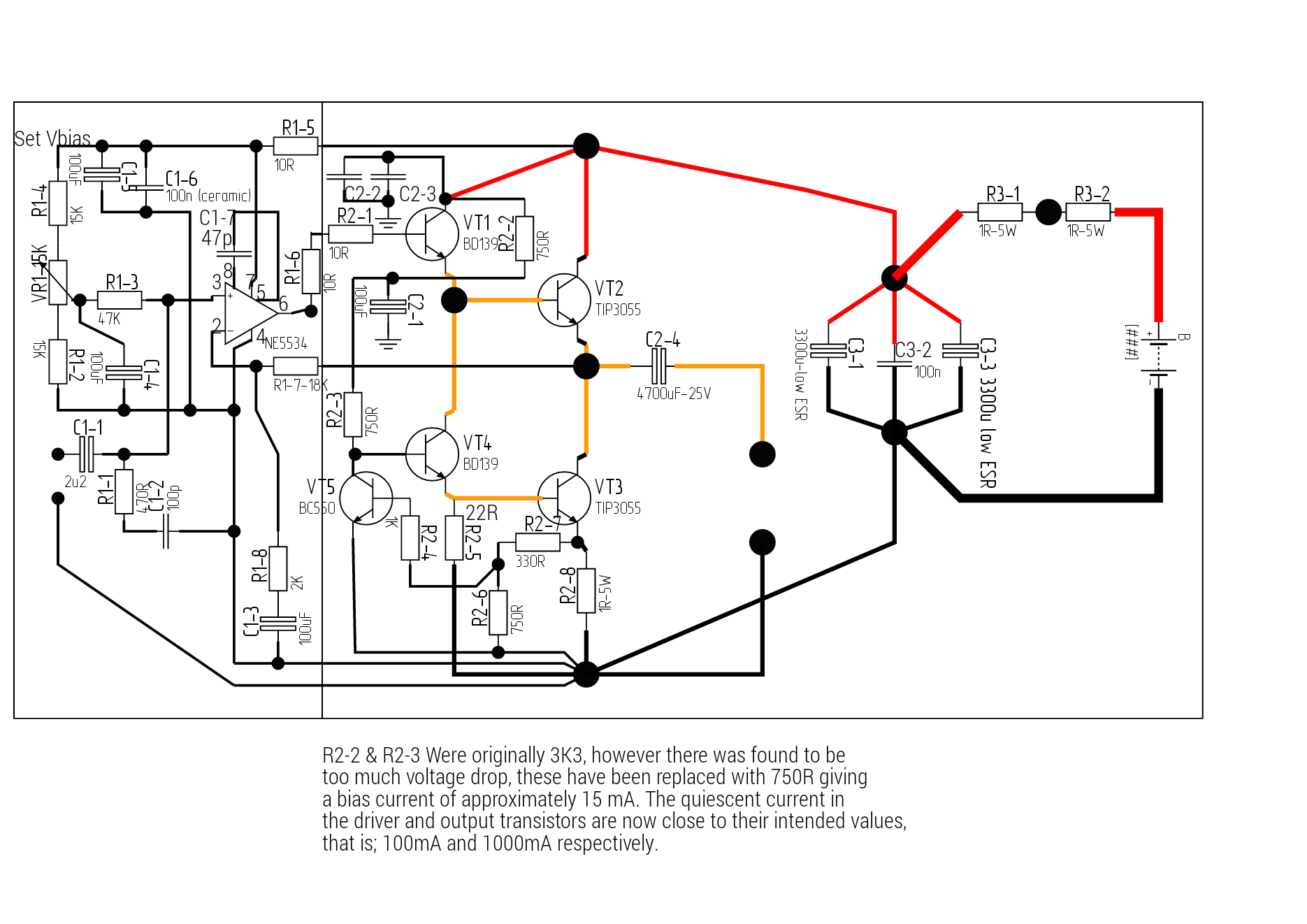

The third image is the driver stage, schematic and layout diagrams. I will build this today ( wed 11th ) after I have slept. 🙂

The driver stage is acting really strange. See attached diagram.
DC voltages and currents kept changing when DVM probe applied to various points in the circuit. I suspect oscillations.
I was unable to locate my 100n ceramic capacitors for local decoupling, so the circuit was built without them. Later I added The red 10R resistor and 150n capacitor ( mylar or polyester ) which did tame the variations being caused by the meter probe.
I need to examine this circuit with the 'scope.
Do you think the odd behavior is due to parasitic oscillations?
?Remedy?

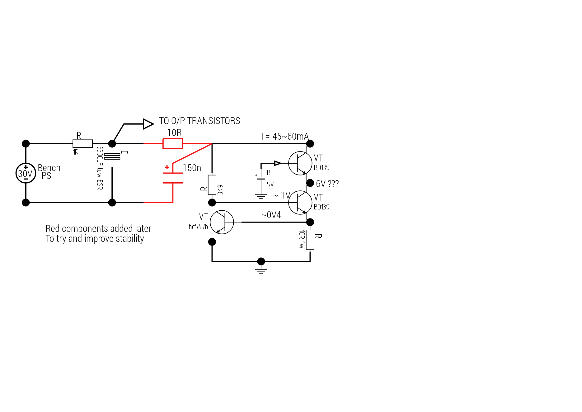

Having decided that your idea was too good to ignore, I've decided to go with it but with some slight variations. Any comments / criticisms are welcome, as always.
1. I have made provision for the idle current to be variable from ~ 700 to 1400mA with a 1K trim pot.
2. The error amplifier transistor in the CCS has been changed to a higher gain type, bc547 probably.
3. Star point wiring for power supply connections.
4. Additional local decoupling ( in red )
5. Zobel network across the output.

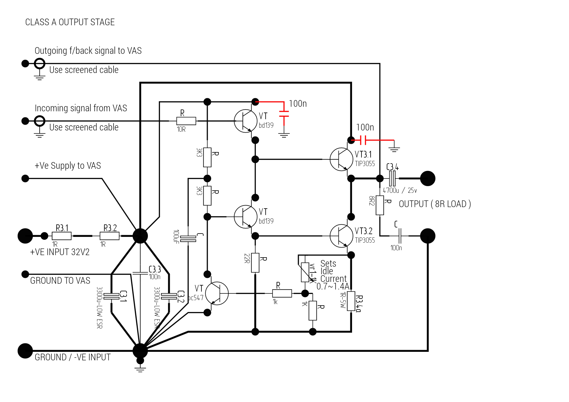

I have included a complete schematic showing the ne5534 vas and the variation of jerluwoos driver / output stage and also the power supply filter. The PS filter is only for use with the bench power supply, A separate supply would need much larger capacitors.

Note that with the sinewave input, the trough part of the waveform ( around the negative peak ) is blurry. Could that be parasitic oscillations?
I've heard that the ring of two CCS can be inclined to oscillate, any thoughts on rectifying this?
Gordon.
EDIT: The supply voltage after the PS filter was 23V8 not 30V as previously. ( The input to the filter was ~ 26V )
