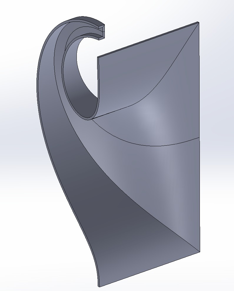

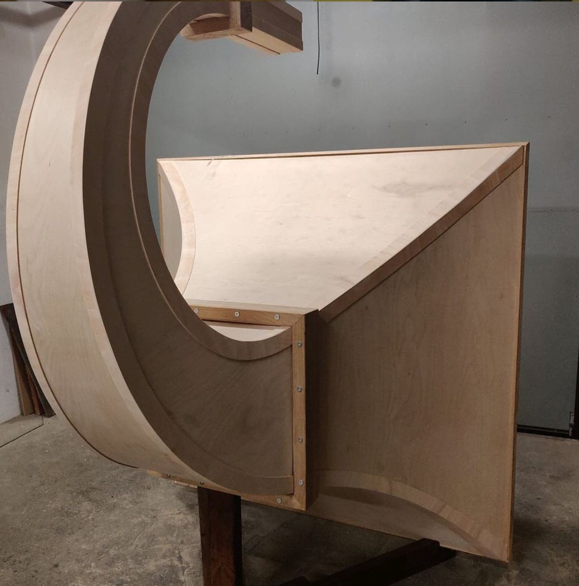

I could flex it like banana but like WE I need to find smooth solution. My friend made JMLC 42Hz truncated see below.

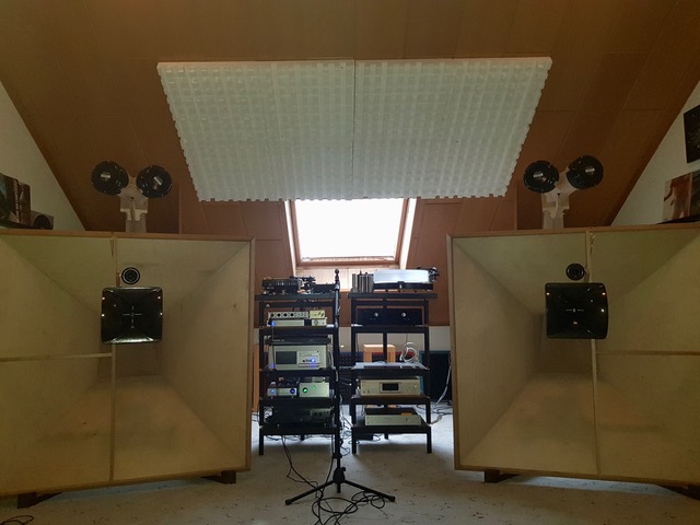

Such horns are high craftsmanship but I am always asking for what applications / for what driver? The Axi is rated from 300Hz on. So, a minimum of 160Hz range should be the lowest cut-off to use ever.
I had the chance to listen to a snail horn combo WE12a/WE13a. Really spectacular but if you watch the video just posted you immediately understand why these peace of carpets are inside the horn. You have to limit the frequency range to less than 3 octaves and maybe need to use DSP. I greatly prefer straight horns. For the Axi I would make a horn with about 250-300 Hz cut-off and would cross-over them between 500 and 800 Hz.

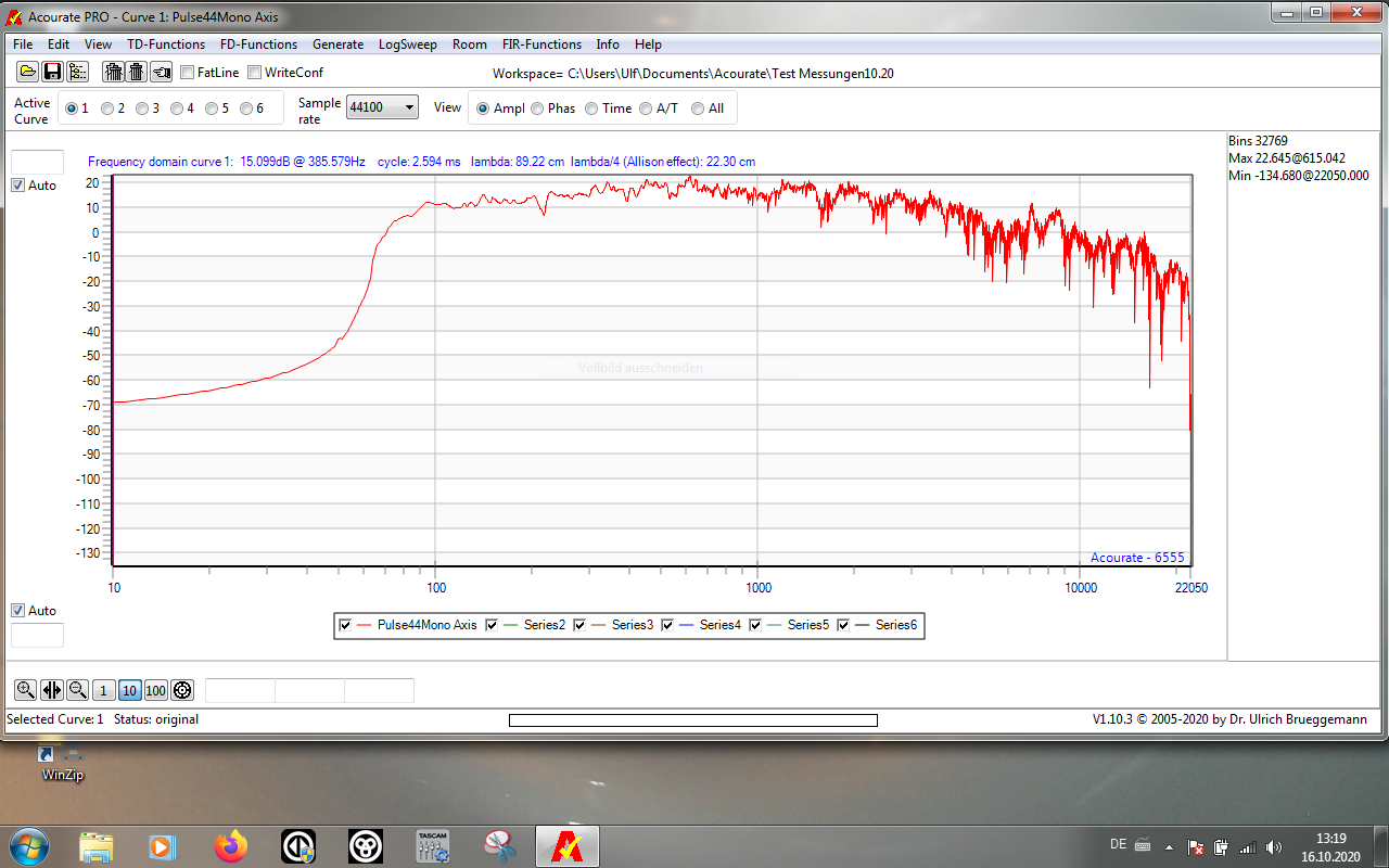

The speakers are an optical highlight but what we see from the data is that cut-off should be at least double of your rated 42Hz. We also do not see neither the real SPL level nor the distortion especially at LF. These drivers are rated for 300Hz up. From your data the system should be crossed over at least at 200Hz.
[emoji106] have you modelled?I'm interested in WE on the back and waveguide in front - compound horn.
I meant Hornresp modelled[emoji846]I prefer print one. Waiting for material supply.
Just take a look at the front cover of Kolbrek/Dunker book and you immediately know where the problems of such horns are. In the historic context the top of the food chain but we have had nearly 100 years of development since then.
