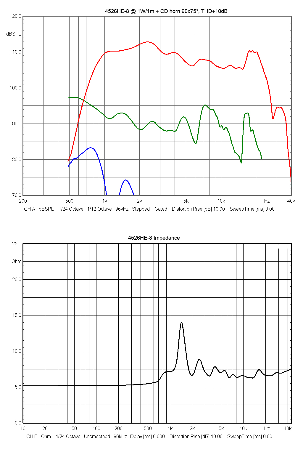

The speakers are an optical highlight but what we see from the data is that cut-off should be at least double of your rated 42Hz. We also do not see neither the real SPL level nor the distortion especially at LF. These drivers are rated for 300Hz up. From your data the system should be crossed over at least at 200Hz.
