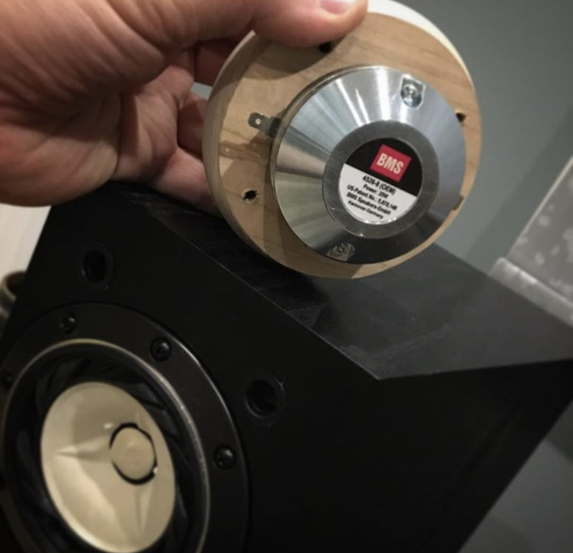

BMS 4526HE. 0.68" throat, 106dB output from 10khz+, 112dB output at 20khz
My small horn was for a client that requested the BMS 4526...he made reference to some Patrick guy on the DIYAudio forum. ;-)
I believe his end preference was for the Celestion CDX1-1425 which I also made a horn for. He did a side by side comparison of the two drivers each with their own custom horn. The wood horn that I made for the CDX1 had the throat narrow down to 5/8” diameter before expanding out with the JMLC flare. So it would have near identical polar response between the two horn designs.

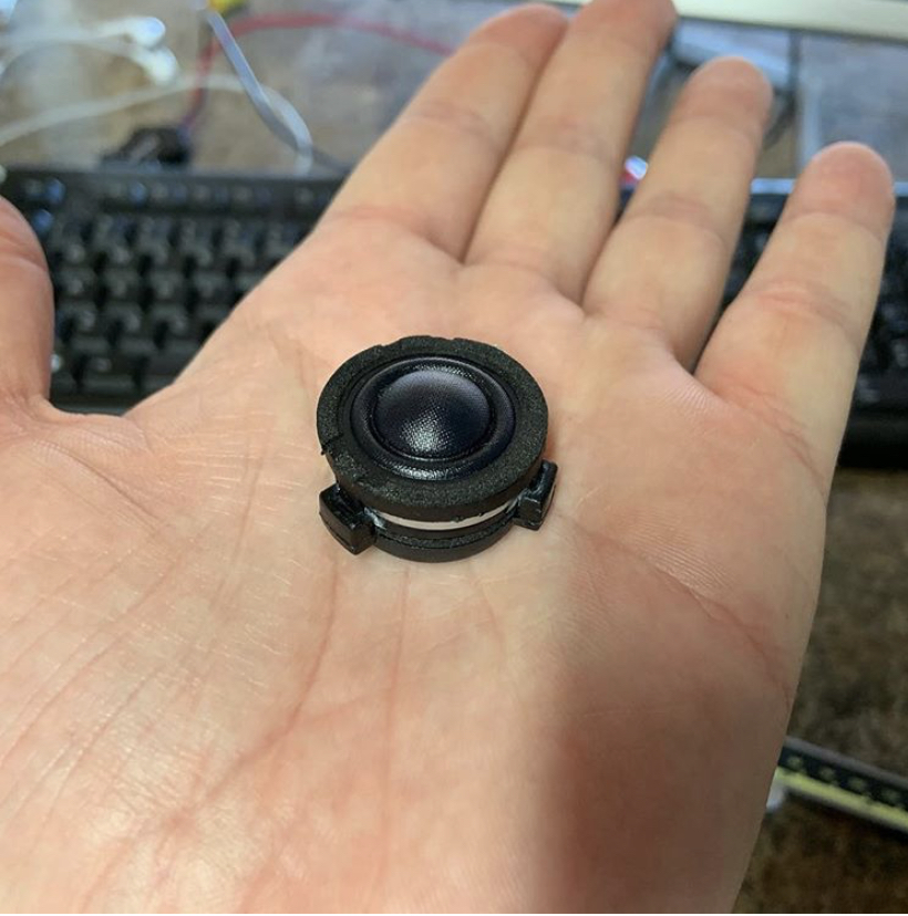

My next project is to go down to 1/2” throat using the Wavcor TW013WA01 1/2” dome tweeter mounted to a JMLC horn.

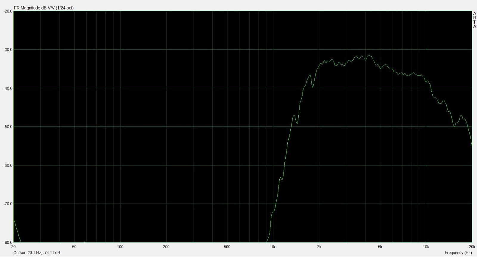

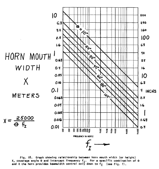

By my understanding, a constant directivity waveguide has about the same response flatness (assuming large enough waveguide for lower part of frequency range) as the compression driver has played into a plane-wave tube. The horns that make the response flatter, lifting the higher frequencies like say an exponential horn does, do so by squeezing the output power at higher frequencies into a smaller projection area.
But correct me if I'm wrong on this.
That's pretty much how I'd put it too.
I'd just add that the total angle of coverage also sets the loading. But let's not forget that the majority of the loading effect comes from the compression ratio.

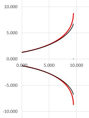

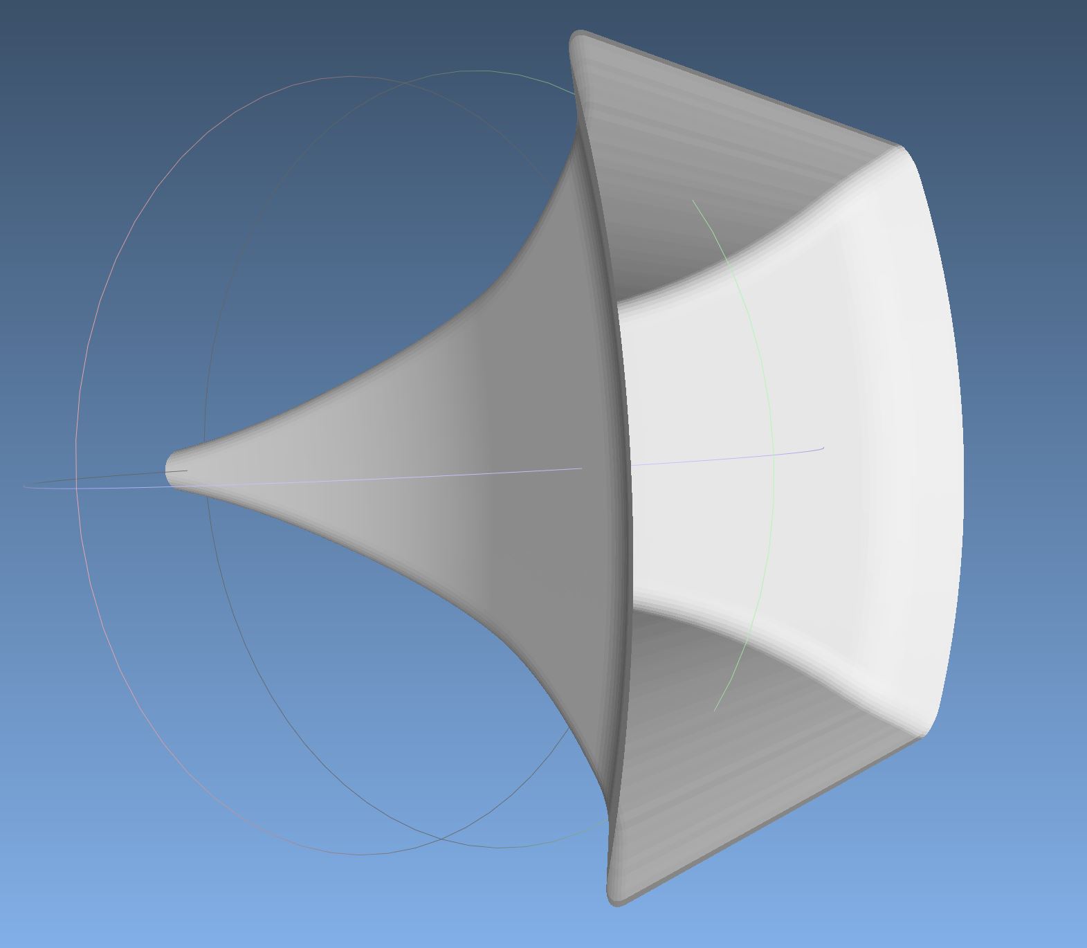

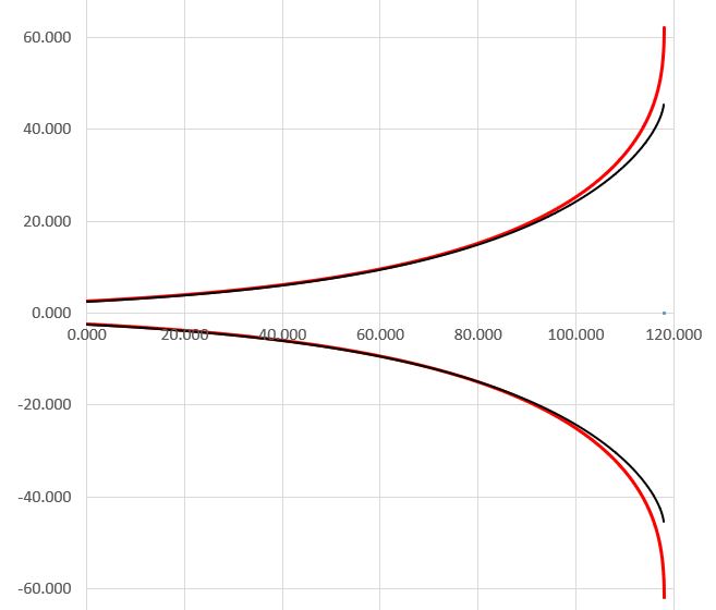

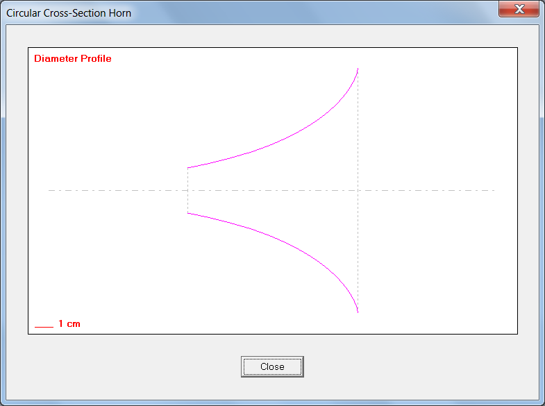

800Hz tractrix horn waveguide
From a mathematically challanged audiophile-woodworker: Can somebody provide calculations for a 800Hz round Tractrix horn with 1" throat size (TAD 2001)? I plan to cut this horn out of solid hardwood using friend's CNC router. Thanks.
