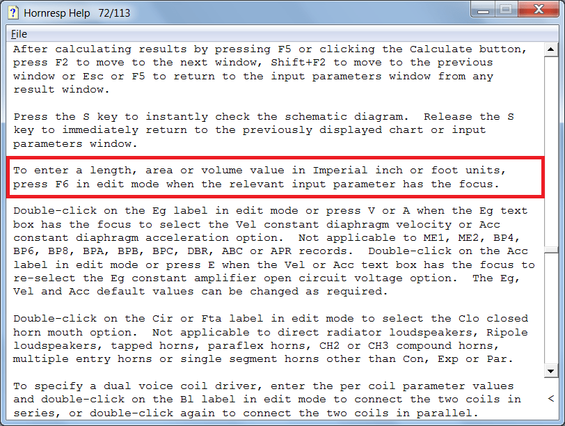

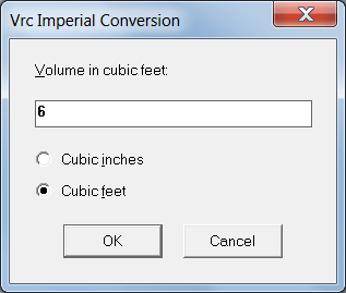

Well...If I can't adapt to the metric system, then I can't use HR.
