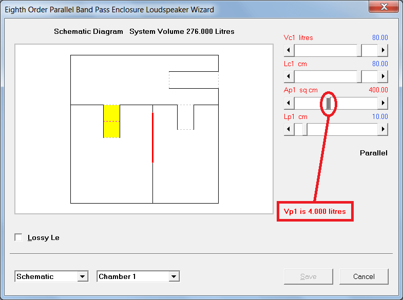

I want to see how many liters the different ports of the box occupy in the schematics window like I could before if I'm not mistaken. Is this possible?
In the next update the band pass loudspeaker wizard will show chamber and port tube volumes when the Vc, Lc, Ap and Lp sliders are used.

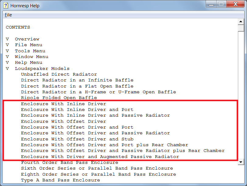

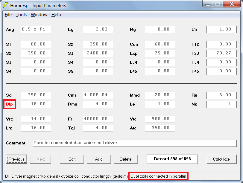

Hornresp Update 5620-240707
Hi Everyone,
CHANGE 1
The Help File closed-box and vented-box loudspeaker model names have been amended.
Post #14,853 and Attachment 1 refer.

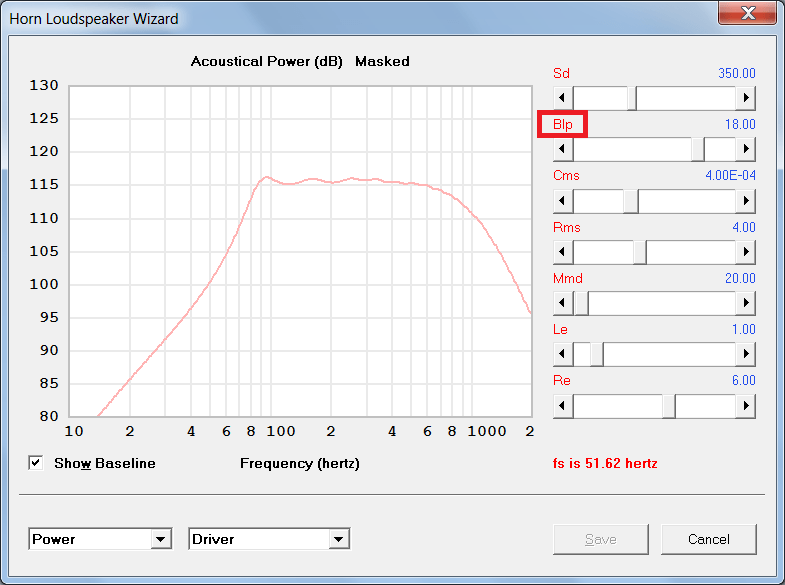

CHANGE 2

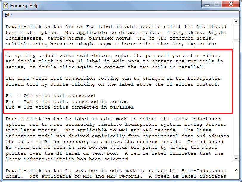

It is now possible to specify a series or parallel connected dual voice coil driver without having to manually adjust the per coil parameter values. Dual voice coil driver settings can also be specified in the loudspeaker wizard by double-clicking on the Bl slider caption.
Post #14,860 and Attachments 2, 3 and 4 refer.

Chamber and port tube volumes are now shown when the Vc, Lc, Ap or Lp sliders are selected while the schematic diagram is displayed in the band pass loudspeaker wizard.
Post #14,861 and Attachment 5 refer.

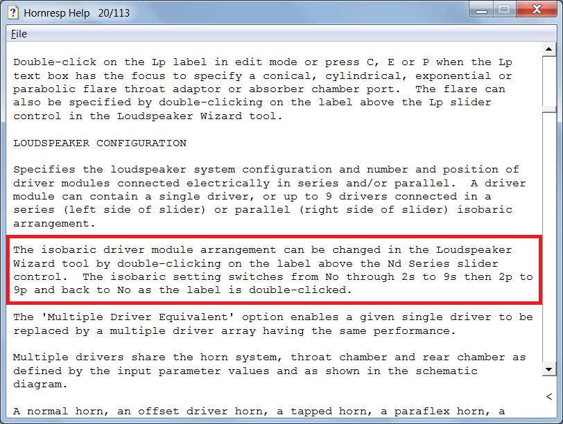

CHANGE 4

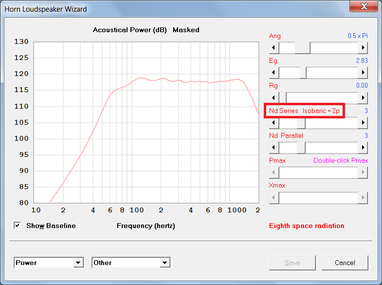

It is now possible to alter an isobaric driver module arrangement setting in the loudspeaker wizard by double-clicking on the Nd Series slider caption. Settings cycle from No through 2s to 9s and then through 2p to 9p back to No, as the caption is double-clicked.
Attachments 6 and 7 refer.

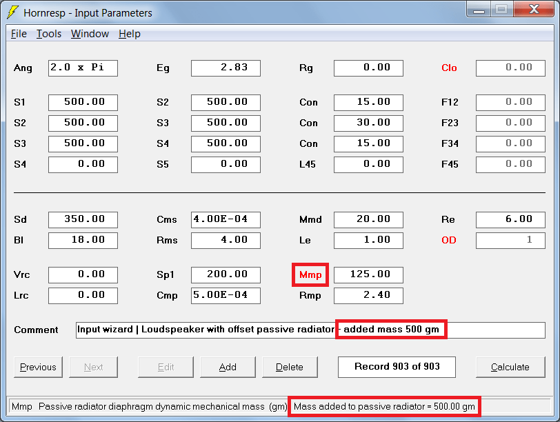

@David McBean
I don't know if this in all cases, but when the passive radiator is selected with offset, it automatically adds an added mass of 500gr.
It took me a long time to figure out why I was getting such strange results, but via the loudspeaker-wizard I found out that there was a added mass of 500gr for some reason?
yes, I know it's written as text, when this is being selected, but it wasn't that intuitive

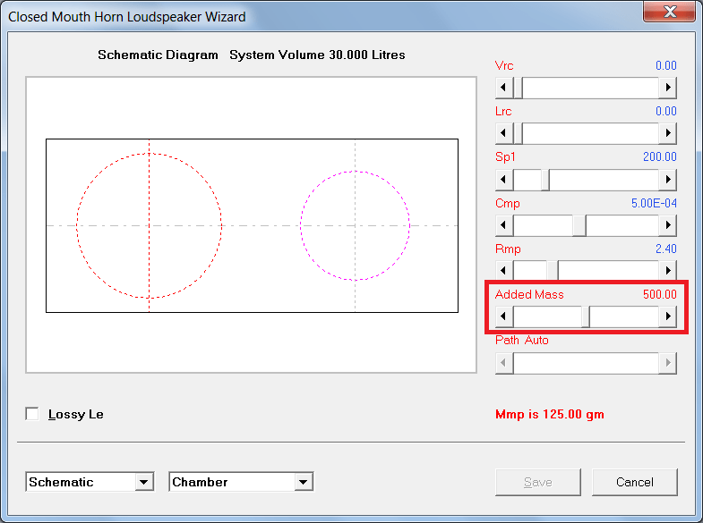

Thanks for the feedback, but I think it best to leave things as they are. Some comments:
Added mass is included when the Input Wizard is used to specify a representative example of a loudspeaker with a passive radiator because I wanted the default PR template to "showcase" all available features. I would have thought that it should be reasonably obvious to the user that mass has been added, for the following reasons:
1. The Input Wizard record comment field states that a mass of 500 grams has been added.
2. The Mmp label is shown in red rather than black when mass has been added.
3. Moving the mouse pointer over the Mmp label and input text box shows the amount of added mass in the status bar panel at the bottom of the Input Parameters window.
The above three indicators are highlighted in Attachment 1.
Also,
The amount of added mass can be adjusted in the Loudspeaker Wizard, as shown in Attachment 2.
However,
Added mass is not automatically included when a passive radiator is specified on an existing record, as shown in Attachment 3.
All features are documented in the Help File - use the Find tool to search for the keywords 'passive radiator'.

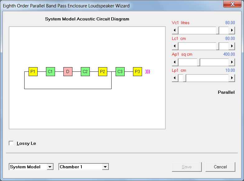

is that entire model, in the 3D version, cylindrical, or is it rectangular?
Hornresp models all acoustic components as axisymmetric (circular cross-section) elements. Chambers and port tubes are cylindrical, horn segments are flared.
The system model acoustic circuit diagram shows how the various axisymmetric elements are interconnected.
(Yellow = port tubes P1 to P3, Green = chambers C1 to C3, Pink = driver D)

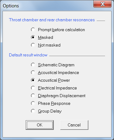

You made me look, I don't use them........anyway in main screen input the basic info, driver specs, choose the box type and do all your design in the Wizard, click 'save' and assuming you're happy with it you're done; otherwise, use the Loudspeaker Wizard to mod it further, etc. and either click Calculate to save or just move away and it will ask if wanting to save.
If you always (not) want masking, then go to Tools, Options to choose, making for one less pop-up.
