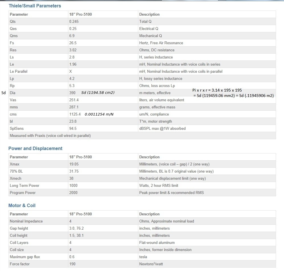

Assuming I follow, the driver specs is just a made up? default, so what you need to do if you don't have the necessary Cms, etc., specs is to double click on the Sd field that opens a Driver Parameter (T/S specs) window to fill in, which HR uses to (re) calculate the correct Cms, etc..
No driver specs are real, just there is no value for mechanical resistance in the T/S parameters. All of the regular T/S parameters are there including CMS. The issue is that the RMS label is suggesting that a RMS value is to be put in the box (that is reasonable assumption) considering every program I have written where I want a value to be added has an appropriate label to suggest that, but newton sec / m is not what you would expect to put in a box for RMS, so either the RMS label is wrong, or the short description that appears below is wrong. I don't know what goes in the RMS box, it not a lack of having a value to put in there, just need to know what to put in there.

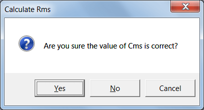

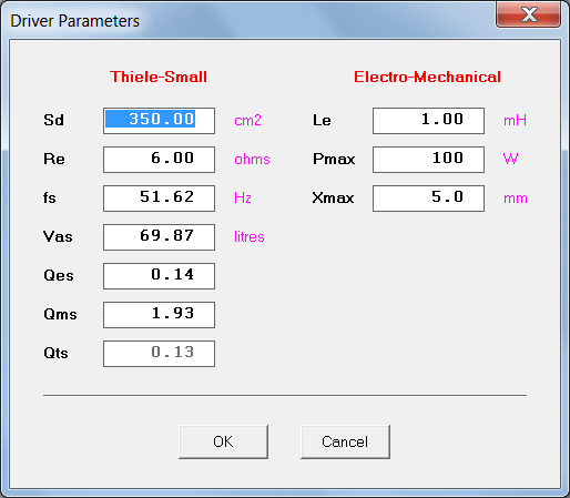

As GM says, with the record in Edit mode double-click on the Sd input box and enter the Thiele-Small parameter values for the driver you intend using. The electro-mechanical equivalents, including Rms, will be automatically calculated. Attachment 1 refers.
Alternatively, simply double-click on the Rms input box in Edit Mode and follow the instructions. Attachment 2 refers.
This seems straight forward enough once you know this is what is required to enter a value, but again it is not intuitive for the user.
