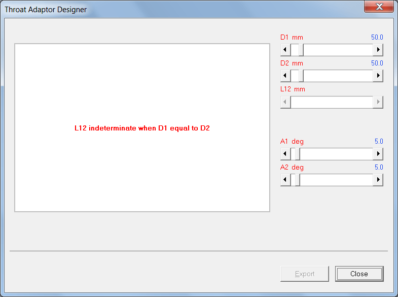

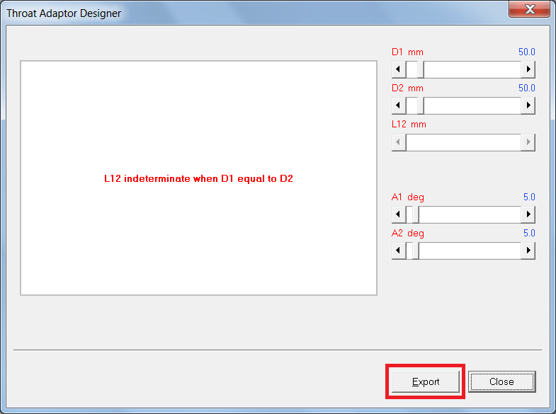

Hornresp Update 5530-240222
Hi Everyone,
BUG FIX
The Throat Adaptor Designer Export button was not being disabled when an invalid set of input values was specified, as shown in Attachment 1.
This has now been fixed, as shown in Attachment 2.
