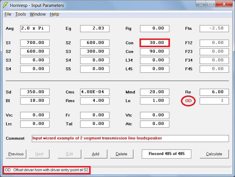

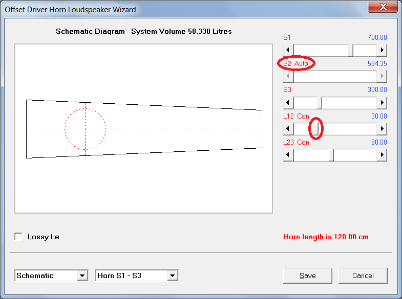

How to adjust driver offset--on a transmission line design.
Hi kebailey,
The driver offset is specified by L12.
(If the Loudspeaker Wizard is used and the S2 slider set to Auto by double-clicking on the 'S2 Manual' label, the driver can be moved up and down the transmission line by adjusting the L12 slider, without changing the overall transmission line profile).
Kind regards,
David

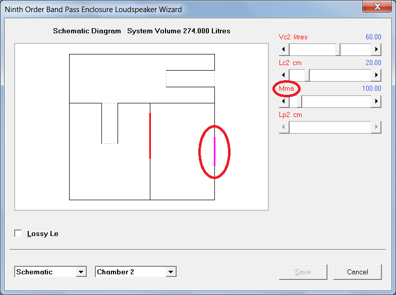

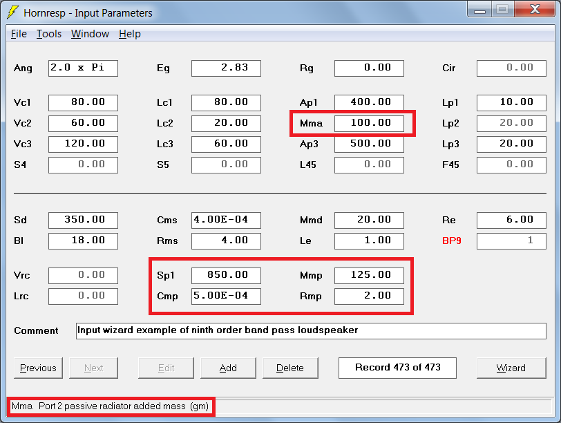

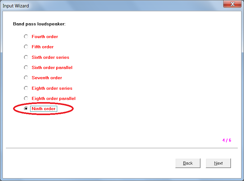

Hornresp Update 5030-190714
Hi Everyone,
CHANGE 1

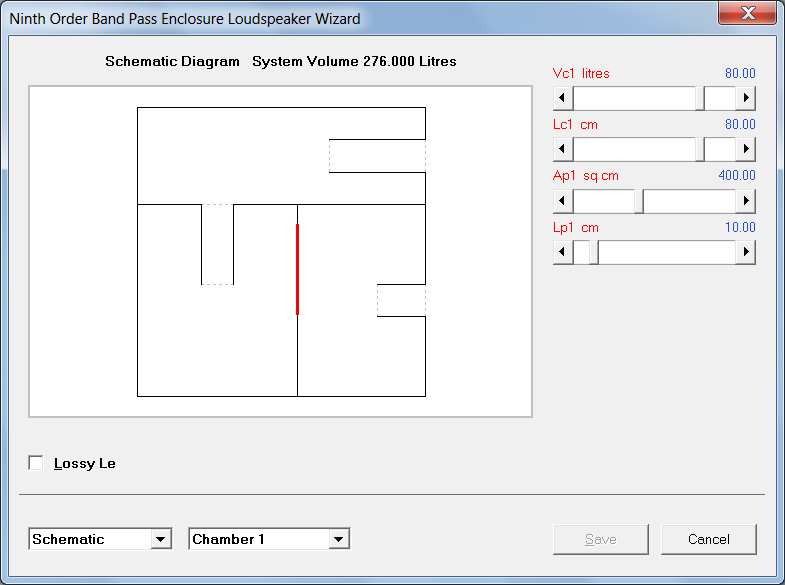

A ninth order band pass enclosure loudspeaker option has been added. Attachments 1 and 2 refer.
CHANGE 2

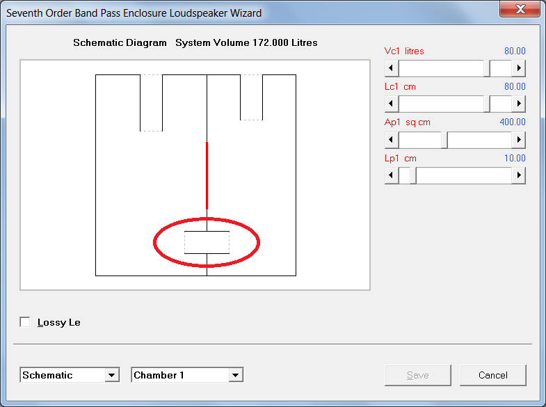

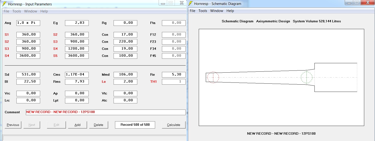

An externally-vented port tube in a band pass, DBR or ABC system can now be replaced by one or more passive radiators.
To specify a passive radiator in a band pass, DBR or ABC system, press the Ctrl key and double-click the Fr label while in edit mode. Press the Ctrl key and double-click the Sp1 label to specify multiple passive radiators. Double-click the Sp1 to Sp9 label to restore the default Fr label.
To replace an externally-vented port tube with a specified passive radiator, double-click on the Ap1, Ap2 or Ap3 label for that port. The label changes to Mma and the Mma text box value becomes the mass in grams added to each passive radiator diaphragm.
To select the alternative externally-vented port in a BP6P, BP7, BP9 or ABC system, double click on the Ap label for that other port.
To remove a passive radiator and restore the port tube, double-click on the Mma label in edit mode.
Attachments 3, 4 and 5 refer.

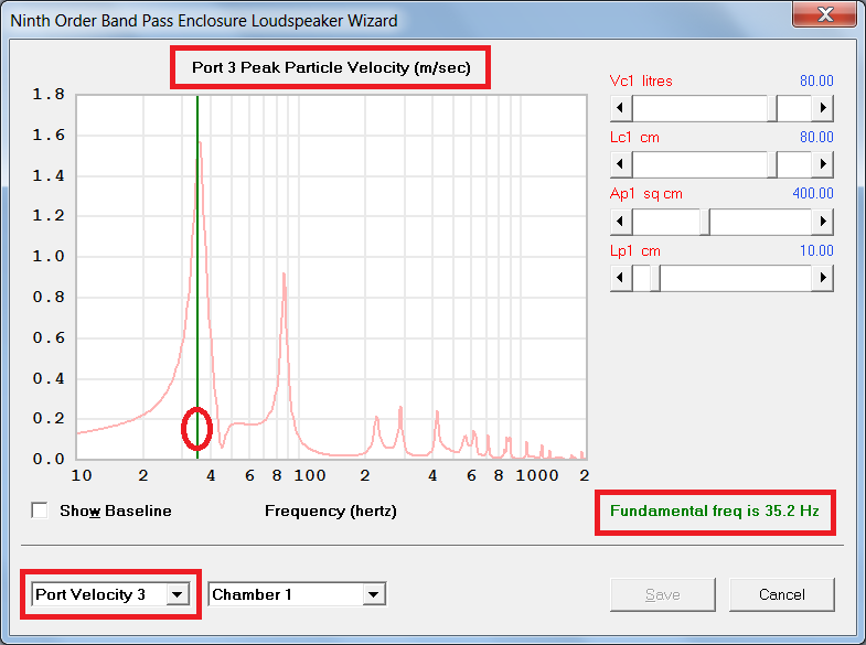

When activated by double-clicking on a chart, the green fundamental resonance marker in the band pass enclosure loudspeaker wizard is now also shown on the port velocity charts. Attachment 6 refers.

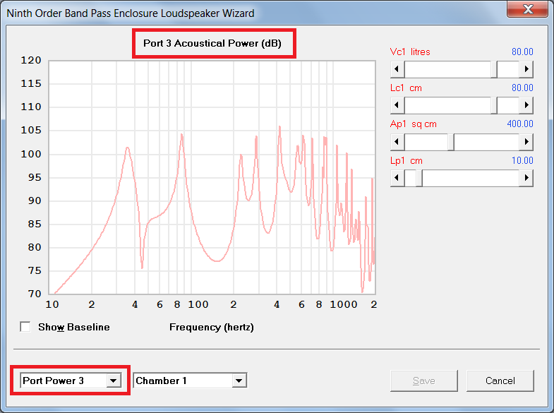

Individual acoustic power output charts have been added to the band pass enclosure loudspeaker wizard. Attachment 7 refers.
