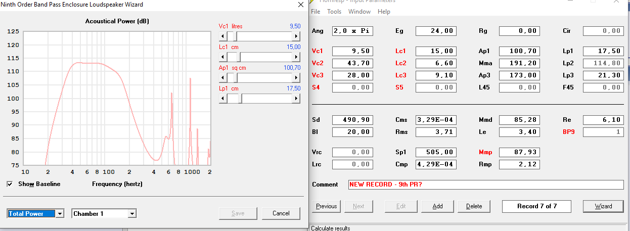

(and Merry Christmas back to you - Avast thought "setup" was a "setup") - I'm not smart enough to figure out the virtues of a 9th order BP but gave a feeble try: https://i.imgur.com/VTO0CEB.png

I believe alignment "orders" are based on the derived orders of the corresponding equivalent electrical circuits representing the alignment. While we might not know what "components" are in that circuit, we can take a good guess at the order by looking at the dips and peaks in the corresponding impedance curve in the passband. That impedance curve looks like what I'd expect to see with a 6th order alignment (three peaks, two dips in the passband).

Here my first sim test, using a PR as port 3. Less efficient than a 8th, (as it's more a 6th from it behavior as Brian said) but response seems less sensitive to parameter, while keeping shaping/filtering advantage of 3 chamber design.(and Merry Christmas back to you - Avast thought "setup" was a "setup") - I'm not smart enough to figure out the virtues of a 9th order BP but gave a feeble try: https://i.imgur.com/VTO0CEB.png
shortening vent 3 looks less useless - its tuned pretty deep
From my point of view, this is a way to separate a problem to solve :
Sub range from back port length difficulties solved with PR (CSS 12").
> 45 hz range => filtered with 2 front BP while keeping short vent.

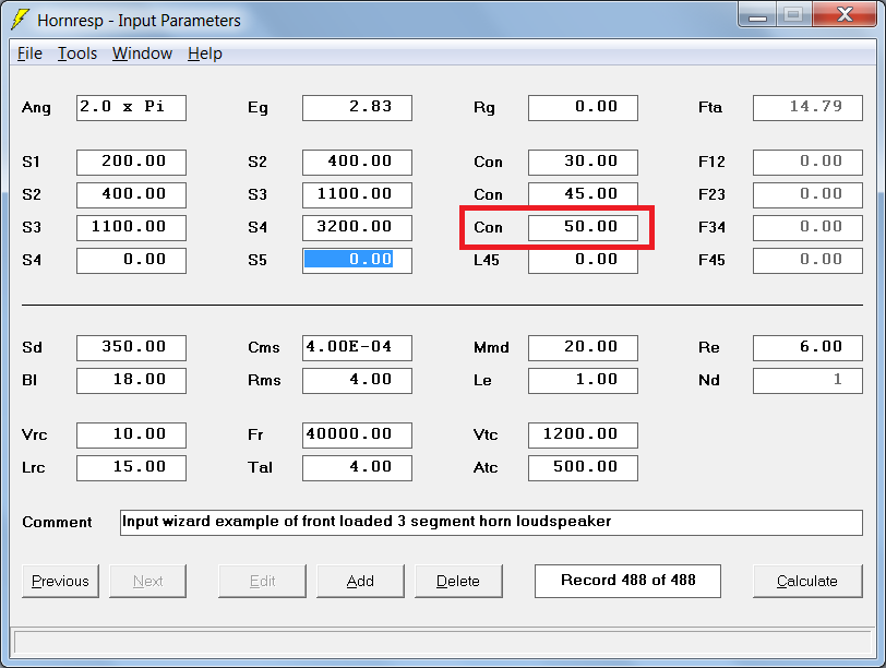

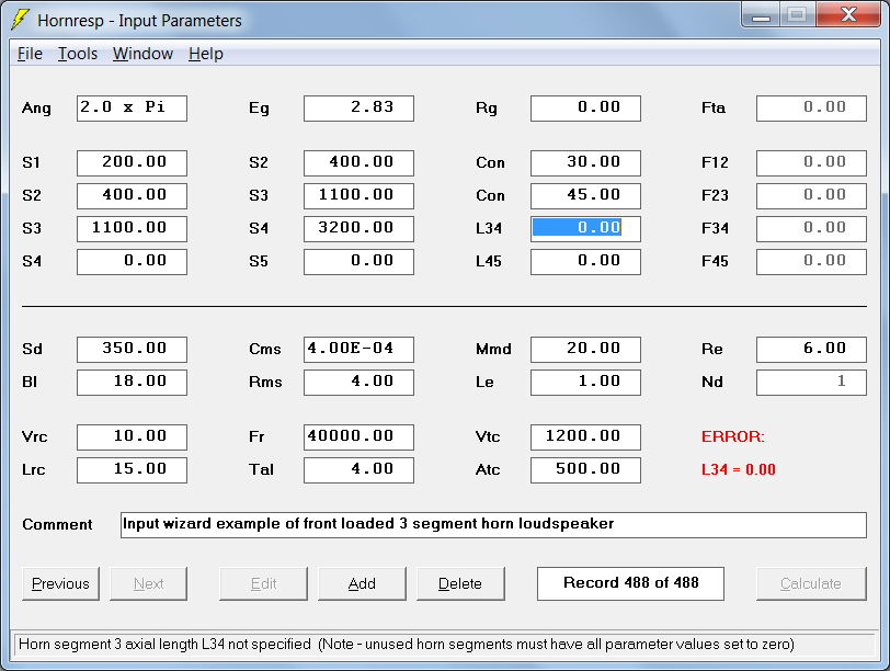

I'm getting error L34 can't input data
Hi clf,
Could you please post a screenprint of the input parameters window and the error message, so that I can investigate further. Thanks.
Kind regards,
David
Hi David,
I have gone back to previous version, I didn't get an error message, I simply couldn't change L34 horn type or input horn length, clicking on L34 had no effect.
Kind regards
Kind regards
I have just installed it again and yes I did get an error message saying, ERROR: L34 = 0.00
Hi clf,
With the L34 text box highlighted, try typing in 50C or C50 and then pressing the Enter key. This should specify a conical flare of length 50 cm, as shown in the attachments.
Hi Brian,
The three-character band pass options remaining were BP0, BP1, BP2, BP3 and BP9. I decided on BP9 for the latest topology.
The disclaimer in Post #9647 applies in this case also 🙂.

Hi David,
Yes that works but mouse will not hi light or change it anymore but version 50.00 and 50.20 will, I just checked, hope that helps
Kind Regards
Kind Regards
Hi clf,
This is very strange indeed! If you are using an Nd record and are in edit mode, then I cannot explain why a mouse-click on the L34 text box does not highlight the contents. No change made in the last release should have affected this operation. Is it only the L34 text box that doesn't work?
I would be very interested to learn if anyone else is experiencing a similar problem?
