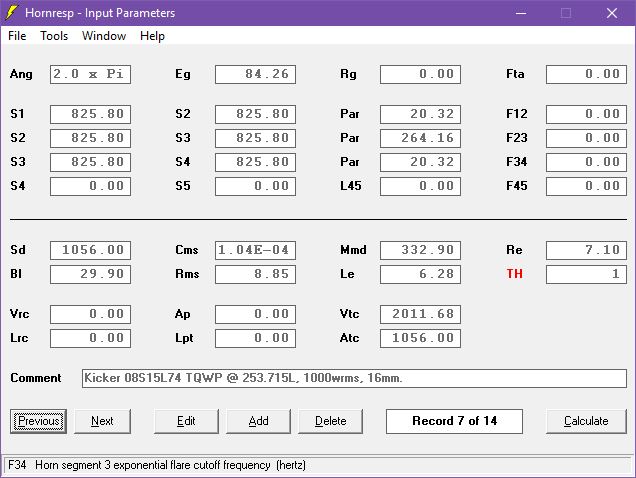

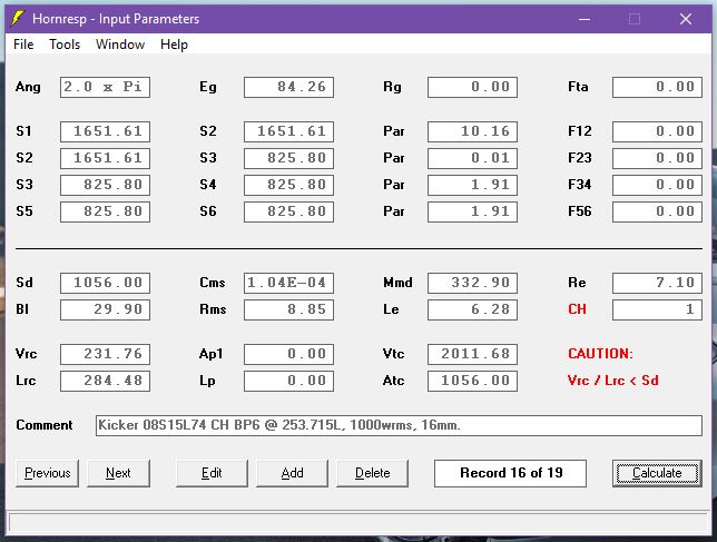

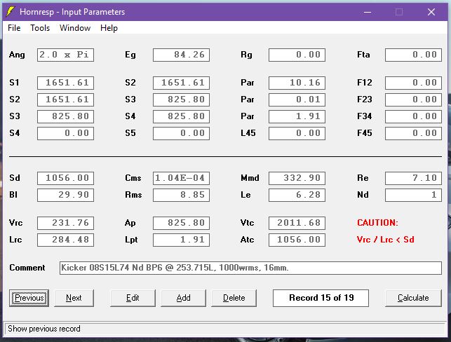

Would it be possible for you to post screenprints of the Nd, CH and TH Input Parameters windows, or alternatively, the exported record files? Thanks.
Here you go!

Hi BP1Fanatic,
Thanks. The very slight differences between the Nd and CH 'resonances unmasked' results are due to the rear chamber port tube in the Nd case having an end correction, while the equivalent horn 2 in the CH case does not. Why your TH results should be so close to the others I'm not quite sure - perhaps it has something to do with segment 2 being relatively long compared to the lengths of segments 1 and 2.

Actually, S1 and S2 of Nd and CH can be changed to 825.8cm2 and L12 to 20.32cm to match the 1st segment of the TH. The results are the same. Using 1651.61cm2 and 10.16cm gives the physical internal appearance of the actual enclosure. When I try to get that same physical internal appearance for the rear chamber in Nd and CH, I lose the similar TH response. Rear chamber length over rules rear chamber volume when trying to match the TH's 2nd and 3rd segments.
Simplified examples of Nd, CH and TH systems that produce very similar results:

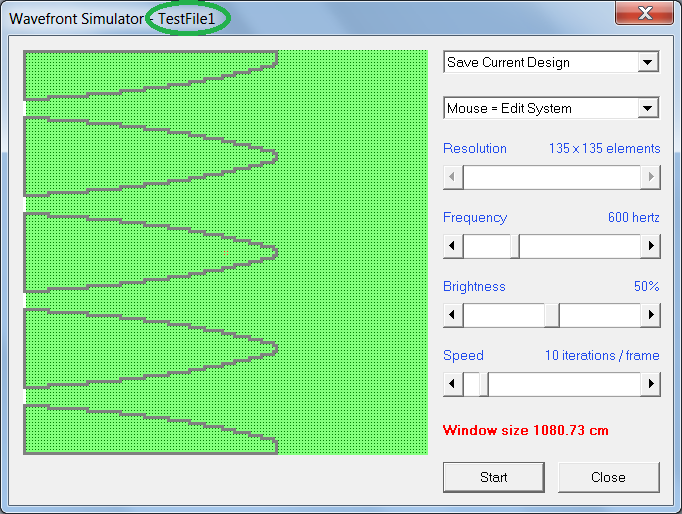

Hornresp Update 4030-170401
Hi Everyone,
Files exported from the Wavefront Simulator tool now contain data for the visible window elements only. Data for hidden border elements is no longer saved. The operation of the Wavefront Simulator remains unchanged, but the file size has been reduced considerably. For example, the file for the system shown in the attachment is now only 54 KB whereas previously it was 180 KB.
The Wavefront Simulator tool in the new release of Hornresp can import .wfs files created using an earlier version of the program. Files created using the latest version cannot of course be imported back into an older version - a fatal error will occur.
Also, the file name is now included in the tool caption, as shown in the attachment.
The changes were prompted by Post #7201.

Hi Everyone,
Kind regards,
David
A worthwhile update indeed! If you don't get the new editing method to work it will still be easier to "draw" precisely in another program and export to the new file format. However, the freehand drawing method was capable of producing some rather beautiful abstract wave front patterns
