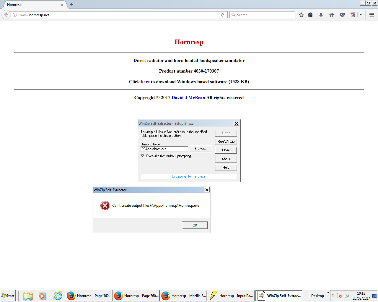

Here you go David.
I currently have 39.4 in drive F.
this is the screen I see after downloading the latest version and executing the .exe file.
Same problem as last week.
Hi Andrew,
I see from your screenprint that you have your current version of Hornresp running while trying to install the latest version. You need to close your current version first. Windows will not allow you to overwrite the existing Hornresp.exe file while it is open.

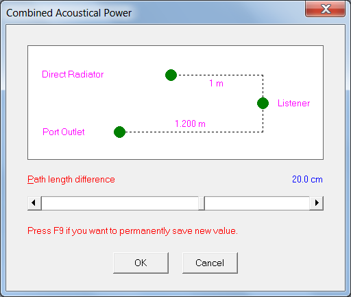

when modelling a ported box where the port is off to one side, the driver is on the large side and you're using the sub in a room (hence sitting at least a few metres away as opposed to 1m), should the path difference be set to a non zero value? if so, where do you measure from? centre of driver to centre of port? edge of driver to edge of port? something else?
Hi 3ll3d00d,
The path length difference is the distance from the centre of the port outlet to the listener, minus the distance from the centre of the direct radiator diaphragm to the listener. The difference is positive when the distance from the port outlet to the listener is greater than the distance from the direct radiator diaphragm to the listener.

Thanks. It seems this adjusts the output of one source by an inverse square law sized amount, right? I suppose this doesn't translate to behaviour in a room dominated by modal behaviour.Hi 3ll3d00d,
The attached screenprint assumes a nominal 1 metre distance, but note that it is the path length difference that is important, not the absolute distance to the listener.
In effect, yes.
The simulation model takes into account differences in magnitude and phase of the two output signals, when combining them at the reference listening point.
Room resonances will affect the accuracy of all response predictions.
