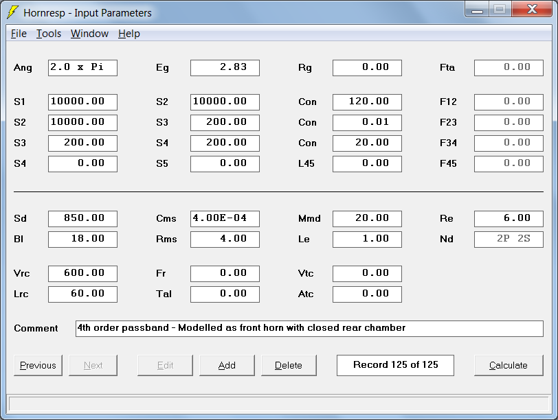

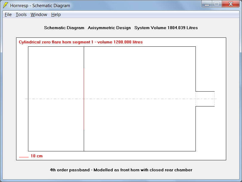

was modelling a 4th order bandpass as mentioned above and wanted to do a very large throat chamber...over 1,000,000 cc for a mobile application.
is there a wy to do this?
its a multiple driver application for high spl output, think dbDragracing and 150+db.
thinking of a 2:1 ratio 4th order for 4 15" drivers.
Hi Etocynned,
Model as shown in the attachments.
Kind regards,
David

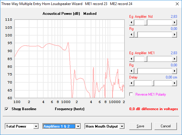

I'm playing around with the Multiple Horn Entry Wizard trying to do a Synergy style simulation.
So far it looks good, however my tweeter response is somewhat garbled. I've tried using CD parameters from this thread:http://www.diyaudio.com/forums/multi-way/138637-modelling-compression-drivers.html.
I don't need a perfect response from the tweeter, just something that seems plausible.
When I use the wizard it gives me this response when calculating from the Input Parameters page:
Something is probably wrong as it has very low sensitivity, but that is fine.
When I run the wizard and choose Total Response in the drop down menu it looks like this:
So, something is wrong. Do you have any ideas?
I've attached the exported record files:
View attachment syn1-3.txt
View attachment syn2-3.txt
View attachment syn3-3.txt
Many regards
Daniel

What is nonsense? The combined response? When you have helmholtz resonators in parallel with the horn's impedance as seen by the tweeter, the possibility exists to cause peaks and notches in the response of the system. When there's no damping simulated, those peaks and notches can be very nasty looking.
Apparently the nonsense was purely on my side. I went in and decreased all the ports and chambers to as close to zero as possible and the response lost most, if not all of its nastiness.
I appreciate the hint
-Daniel

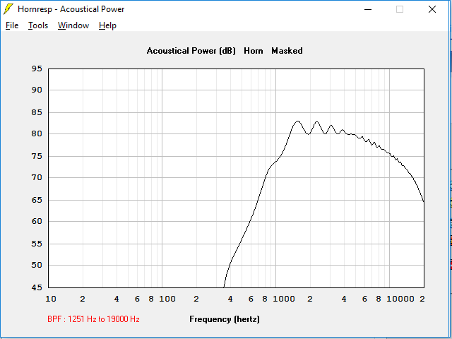

How can I sim multiple large woofer drivers, for example 6x 15".
The same way as for any other design - just specify multiple drivers, as shown in the attachment.
Kind regards,
David

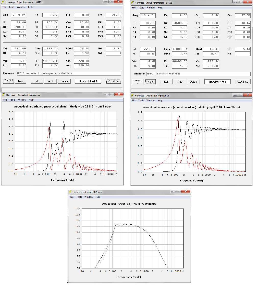

I'm modelling a midbass horn. Below is the comparison of a conical dual expansion vs a tractrix, both with the same drivers, same S1 and mouth size, same length. The frequency responses are very similar, with the tractrix showing smoother, but the differences are quite small considering the effect the room will have at these frequencies. Obviously the conical is much easier to build.
So I look at the acoustical impedance, hoping to be able to derive conclusions about how these differ. What do these tell me, though?
How do I interpret the graphs? What's the red line and what's the black one?
Thank you in advance!
Hi LewinskiH01,
The throat acoustical impedance chart shows how well the horn system couples to the space into which it radiates. The less mismatch there is at the horn mouth, the smaller the reflections, and therefore the lower the amplitude of the ripples in the throat impedance. In the limiting case of an infinite horn, there are no ripples. Different horn types have different characteristic throat impedance curves.
The red line shows the throat acoustical reactance, the black line shows the throat acoustical resistance. The Hornresp Sample tool can be used to confirm this.
If you would like to know more about the significance of horn throat impedance, Google:
Horn Theory: An Introduction, Part 1
Dr Kolbrek's excellent article covers the subject very well indeed.
Kind regards,
