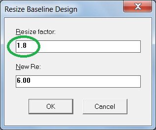

CHANGE 1
A Resize Wizard tool has been added. The driver scaling model used in the wizard was developed by Dr Bjørn Kolbrek.
The tool enables the power response of a specified loudspeaker system to be shifted up or down in frequency without changing the curve shape. The response is repositioned by increasing or decreasing the system size.

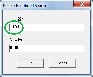

The degree to which a loudspeaker system can be re-scaled is specified by a resize factor, or by entering a value for driver diaphragm piston area Sd. Double-clicking on the 'Resize factor' label selects the Sd option. The value for driver voice coil dc resistance Re can also be specified.
For the purposes of resizing, the baseline reference parameter values are those applying when the wizard is selected for the first time with a given record.
The tool is enabled when the input parameters window is in Edit mode.
Attachment 1 compares the default record (grey trace) to a resized system having a driver 18 inches in diameter rather than the standard 10 inches (black trace). The resize factor is 1.8 which reduces the lower rolloff frequency from 100Hz to approximately 56Hz (100 / 1.8).
Attachment 2 shows the standard Resize Wizard form.
Attachment 3 shows the Resize Wizard form with the Sd input option selected.

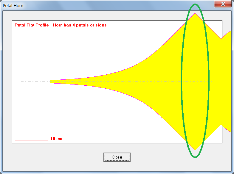

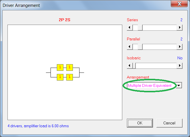

A 'Multiple Driver Equivalent' option has been added to the Driver Arrangement tool, as shown in Attachment 4. The new feature enables a given single driver to be replaced by a multiple driver array having the same performance.
If the Resize Wizard is used to increase the size of a system, the resulting driver may be unrealistically large. The large driver can be replaced by multiple smaller drivers using the 'Multiple Driver Equivalent' option in the Driver Arrangement tool. For bass horns, the performance using the multiple driver array will be effectively the same as that achieved using the large single driver.

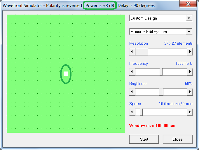

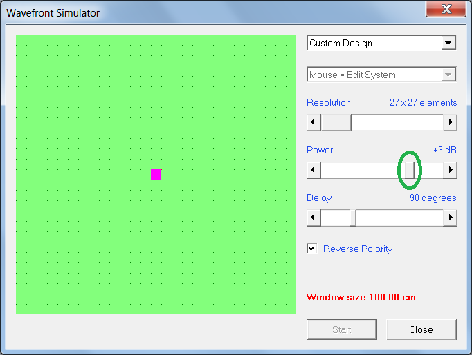

Custom sources in the Wavefront Simulator tool can now be specified with acoustical output power values differing by up to +/- 6 dB from the default value. See Attachments 5 and 6.
Inclusion of the variable source output power feature was prompted by the "I *really* wish" comment in the Patrick Bateman post linked below.

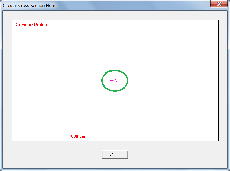

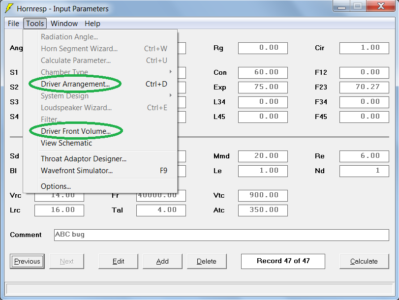

1. If an ABC record was switched to Edit mode and the Next button then pressed to move to the next record, the Driver Arrangement and Driver Front Volume menu commands remained enabled even though the new record was not in Edit mode. See Attachment 1. This problem has now been fixed.
2. The default value for T in the System Design With Driver tool was being shown as 0.8 rather than 0,8 even when the Regional decimal separator setting was specified as ",". See Attachment 2. This problem has now been fixed.
3. If the S key was pressed to select the Sph flare option when the L12 input box had the focus, the schematic diagram was shown instead. This problem has now been fixed.

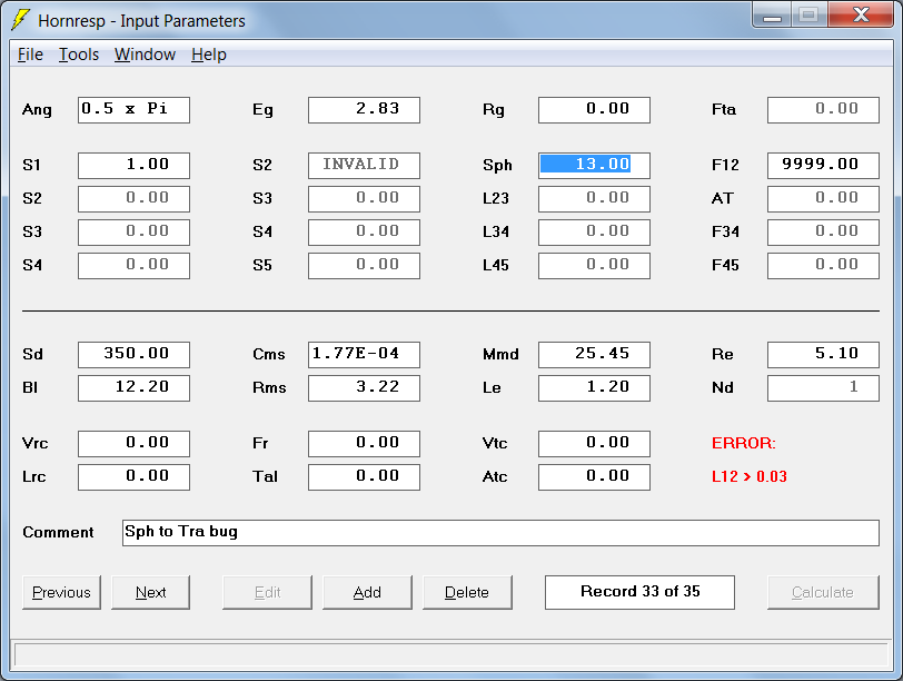

4. When attempting to change an invalid Sph record to Tra by pressing T when the L12 input box had the focus, as shown in Attachment 3, a fatal run-time 'type mismatch' error would be generated. This problem has now been fixed.

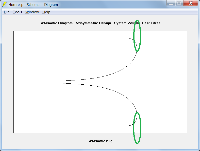

5. In a few rare cases, depending upon the horn dimensions specified, the standard schematic diagram and the export preview diagrams for a Le Cléac'h horn could be incorrectly generated. See the examples in Attachments 4 and 5. This problem has now been fixed.
6. The export preview diagrams for a compound horn were being incorrectly generated. See the example in Attachment 6. This problem has now been fixed.
