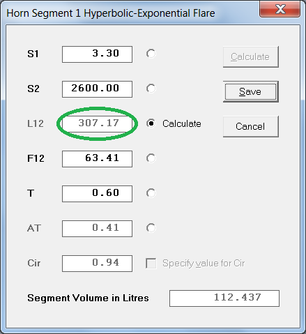

Hyperbolic extension
Hi David
Got a bit confused about the F12 flare/cut-off frequency when trying to extend an existing hyperbolic horn to a much smaller throat. The application is taking an existing hyperbolic ( T = 0.6 ) horn, driven by a Fostex FE208Ez ( throat 90cm^2 ) to a much longer horn, with same final section, to be driven by a modded K-55V Klipsch driver. I wanted to know how much more length is required for the Klipsch compression driver.
So, I start with a 90 to 2600cm^2 hyperbolic, T 0.6, length 164cm. This reports 63.41Hz as the flare cutoff frequency.
The Klipsch has a tiny 2.05cm throat, so that's 3.3cm^2 .
If I put in this throat value, keep the same mouth, and extend the length until I get the same 63.41 cut-off frequency , I get 307.2cm length.
If I then export the horn data and check the expansion to the original throat position , ie. at or near 307.2-164cm ( = 143.2 ) I get a value much smaller than 90cm^2 - about 60cm^2 in fact.
I have not understood something about the cut-off calculation and hyperbolic horns, I suspect.
Hi IslandPink,
Note that the required new length value can be determined very quickly using the Horn Segment Wizard - see attachment.
If S2, F12 and T are held constant, then:
For T < 1 (hyperbolic cosine horn) the new cross-sectional area at the original throat position will be less that the original S1 value.
For T > 1 (hyperbolic sine horn) the new cross-sectional area at the original throat position will be greater that the original S1 value.
For T = 1 (exponential horn) the new cross-sectional area at the original throat position will be the same as the original S1 value.
It's just the way that the expansion formula for a hyperbolic-exponential horn works :).
Kind regards,
David
