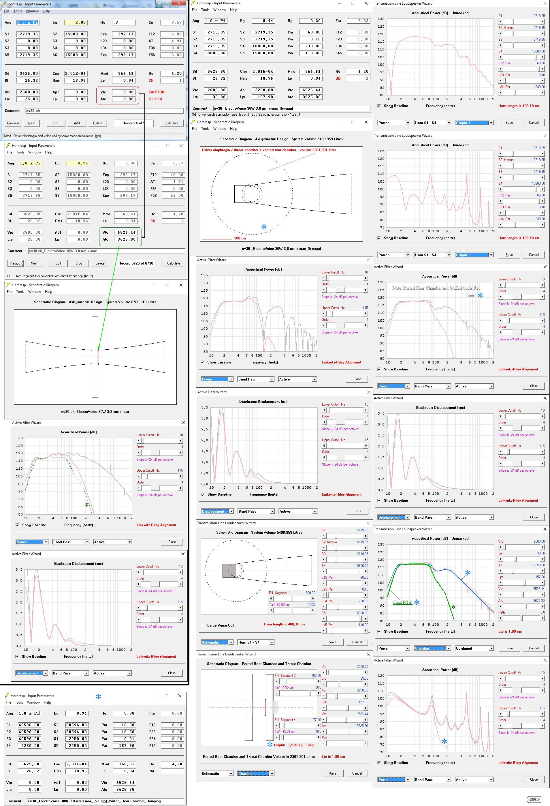

There are two drivers, so Nd=2, and they are "normal" parallel.
Correct. Nd = 2P.
Second section has S3=36x36", S2=24x24", and L23=24"
Correct.
How about the first section? S1=2x5.75"x12"? and L12=24"
S1 is correct, L12 is close enough (the actual L12 axial length down the centre-line of each of the tapered segment 1 ducts will be a little longer than 24 inches).
So what about the drivers? Sd would be that of a single driver, like the T/S parameters.
Correct.
Vtc and Atc would be that of the two drivers added?
Correct.
And the rear chamber volume would be of the combined chamber, or half that?
Vrc is the total volume of the combined chamber, as shared by the two drivers (38" x 19" x 6" or 2.5 cubic feet).
And for a horn playing from 80 to 400Hz and having its mouth sitting on the floor and 1.5m away from the front wall should I use 2*pi or 1*pi?
At lower frequencies the 1 * Pi model is probably more appropriate, at higher frequencies the 2 * Pi model is probably better. Suggest you try both and see how much the results differ, bearing in mind that the actual performance will probably lie somewhere between the two sets of predictions.
Kind regards,
David
David
I made the ratio lower, but still have "warning s1<sd", but it fixed my dip in low corner. I have this weird phase shift thing happening, is this something that's going to be a problem?
thanks
Mike
Hi Mike,
See the enclosed Pictures for answers.
b🙂

I meant to add that if you are not sure what cross-sectional areas and/or chamber sizes to use with multiple drivers, simply check the schematic diagram - it shows the system being simulated, drawn to scale. Move the mousepointer over a chamber to confirm the volume being used in the simulation. Multiple drivers are represented by a single composite driver, with the diaphragm diameter increased accordingly.

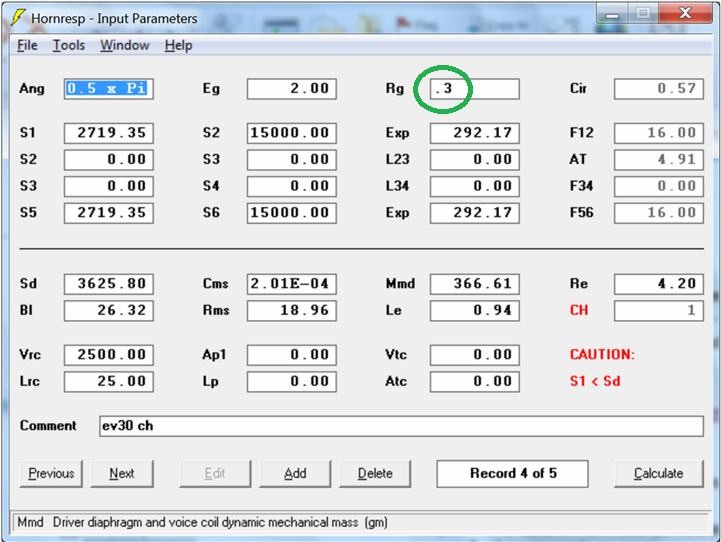

Hornresp Update 3970-160512
Hi Everyone,
BUG FIX
I noticed a bug in the Input Parameters window screenprints attached to Posts #6291 and #6292. The screenprint associated with the second-mentioned post is copied below.
Under some conditions it was possible to key a value into one input box then move to another box without the value in the first box being automatically converted to the correct format (.3 in the attachment should have automatically changed to 0.30 and been right-justified, when the Rg input box lost the focus).
This bug has now been fixed.
My thanks to Mike ('Angelow') for inadvertently bringing this problem to my attention 🙂.
Kind regards,
David

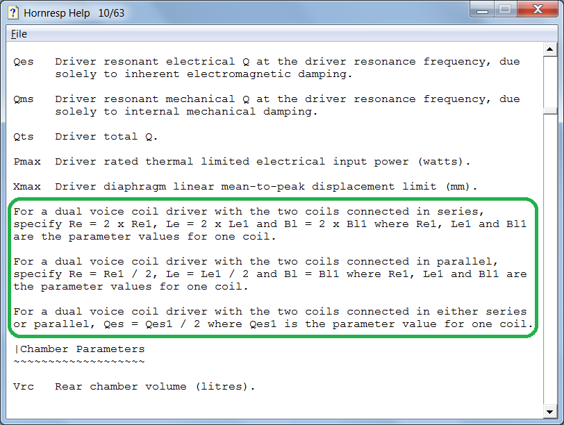

If we assume that the manufacturer's specifications for the dual voice-coil driver are:
Re = 6 ohms
Le = 2 mH
Bl = 15 T.m
Then to model the dual voice-coil driver with the coils connect in parallel, the following values should be entered into Hornresp:
Re = 3 ohms
Le = 1 mH
Bl = 15 T.m
To model the dual voice-coil driver with the coils connect in series, the following values should be entered into Hornresp:
Re = 12 ohms
Le = 4 mH
Bl = 30 T.m
Re = 6 ohms
Le = 2 mH
Bl = 15 T.m
Re = 3 ohms
Le = 1 mH
Bl = 15 T.m
Re = 12 ohms
Le = 4 mH
Bl = 30 T.m

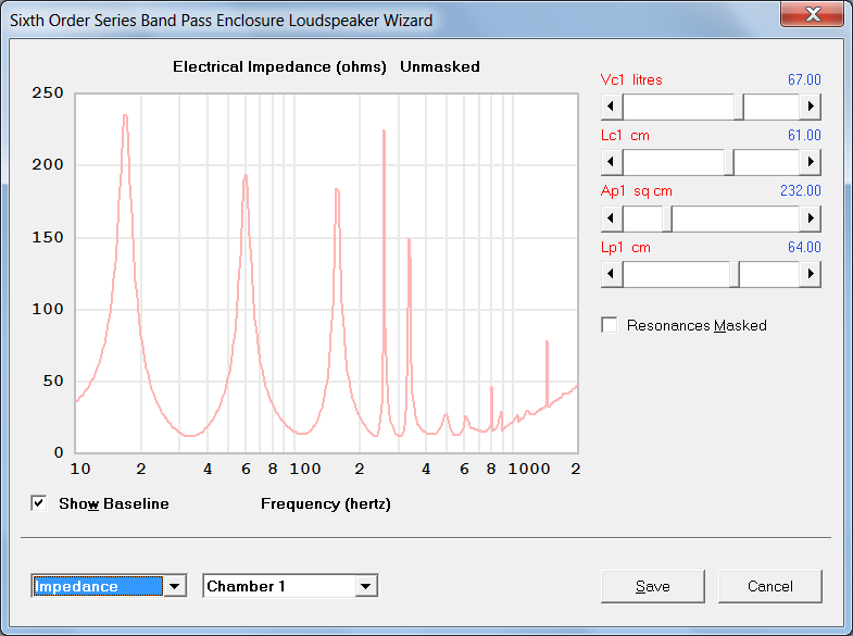

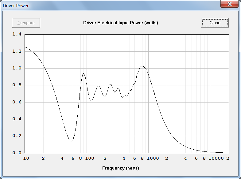

David,
Thanks for your responses so far. I have looked at the maximum spl tool and also, fault on my part, realized that I forgot to mention that I was using the BP6 driver arrangement. It was also my fault further for using the Nd example for driver arrangement.
Since I am using the BP6 driver arrangement the maximum spl tool is not available when the wizard button is selected (no calculate button when using BP6).
Because I am using the BP6 driver arrangement I have been entering the power in Eg similar to the way it would be (I believe) entered in the maximum spl tool.
Having clarified I am using the BP6 wizard, setting dvc drivers to 2P2S, all series, or all parallel gives different excursion (diaphragm displacement) results. So far I have been basing my graphs on the curves that show the lower impedance curves.
Given your above example I am assuming I can change the Re of the driver so long as I change the relevant parameters (Le and Bl) to reflect the change in Re? This should make modeling the dvc drivers easier if I am assuming this aspect correctly.
Thank you.
Thank you.
Hi six7one,
Power cannot be entered using Eg, only voltage. The BP6 Wizard assumes a constant input voltage Eg. The Maximum SPL tool assumes a constant input power. It is not possible to replicate the action of the Maximum SPL tool using the BP6 Wizard.
For the purpose of the exercise assume that you want to simulate a BP6 system with four drivers connected in a 2P2S arrangement, with each driver having two identical voice coils connected in series, and the manufacturer's specifications for one coil are Re = 6 ohms, Le = 2 mH and Bl = 15 T.m.
On the Hornresp main input screen specify:
Re = 12.00
Le = 4.00
Bl = 30.00
BP6 = 2P 2S
Then click the Wizard button.
The simulation will be done using a constant voltage Eg at all frequencies. The actual resultant input power will vary considerably with frequency because the electrical input impedance of the BP6 system deviates greatly from the dc resistance value of Re = 12 ohms, as illustrated in the attached example.
If you want the driver dual voice coils to be connected in parallel rather than series, then on the main input screen specify:

Hornresp Update 3970-160527
Hi Everyone,
Information on dual voice coil drivers has been added to the Hornresp Help file, prompted by the recent posts from 'six7one' seeking clarification on how such drivers should be specified in Hornresp. My thanks to 'six7one' for raising the issue.
Kind regards,
David
Hi Everyone,
Kind regards,

David,
I'm glad I was able to contribute even the tiniest to this amazing program. I wanted to add that after your posts I have been able to successfully manipulate the parameters properly for dual voice coil drivers. The 2S2P arrangements now show what looks like expected responses from dual voice coil drivers. The Eg subject has also been solidified, for me, as to how it is used and applied.
Many thanks. 🙂
Many thanks. 🙂

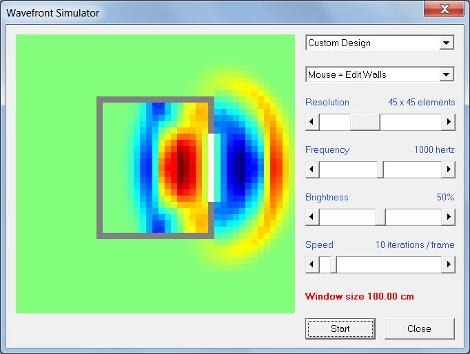

David,
I wanted to ask if there is any way to get the old colors (black background, etc.) for the wave simulator back?
The new yellow background with the near invisible point source pixel color has made it harder to outline the enclosure and wave points.
Thank you kindly.
Thank you kindly.
Hi six7one,
The colour scheme was changed to more clearly show sound pressure variations in the wavefronts. On my display monitor the driver source is bright white, the walls are grey and the zero pressure background is green. Do you see these same colours? Increasing the Brightness slider setting from the default 50% might perhaps make things a bit clearer.
I would prefer not to have to revert to the old duo-chrome red / green wavefront colour scheme, if at all possible.
Kind regards,
David
