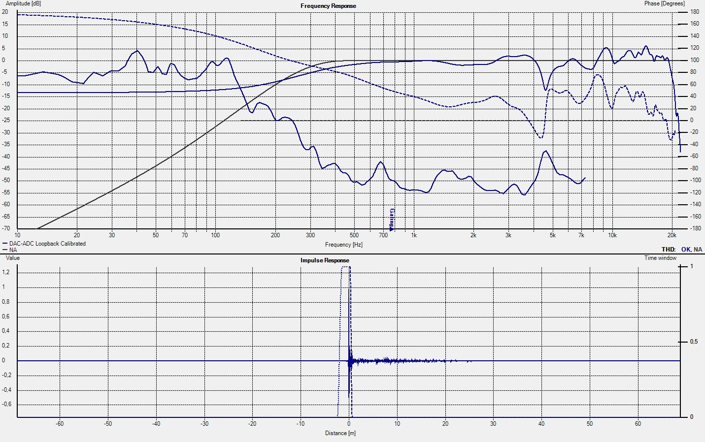

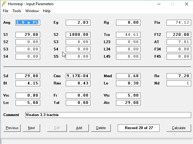

Hi Kees,

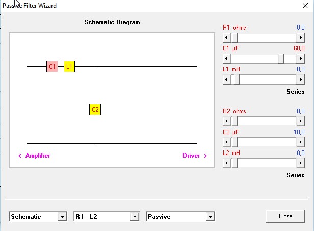

I would be interested in looking at this hornresp record effect on delay (normalized ^^), impedance. Would you mind to share it ? Do you still have the values used for the first thumbmail network filter ?

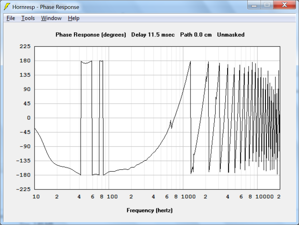

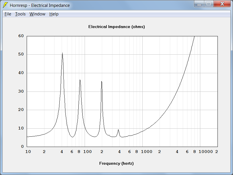

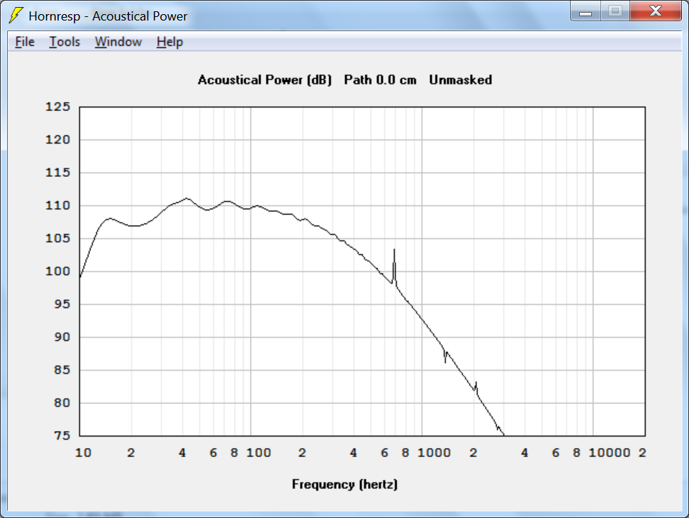

Hi Kees,
It is difficult to provide a definitive comment without knowing the actual input parameter values for the loudspeaker system in question. I am however reasonably confident that the simulation results are being correctly calculated. Note that if the same passive filter network is applied to the default record, the effect on the response is quite different. This is because the speaker frequency-dependent electrical input impedance loading the filter network is different.
Kind regards,
David

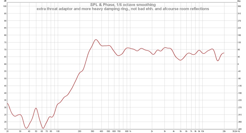

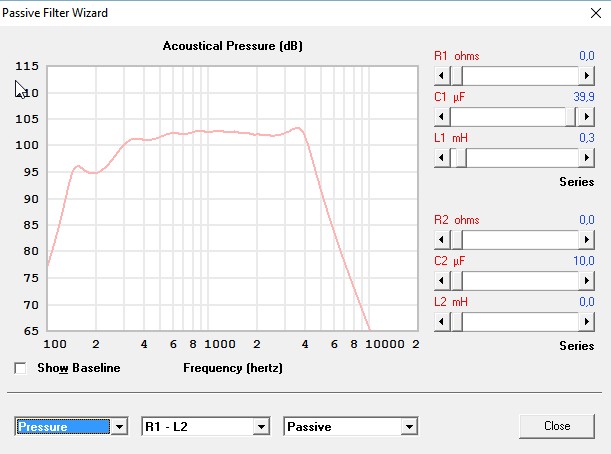

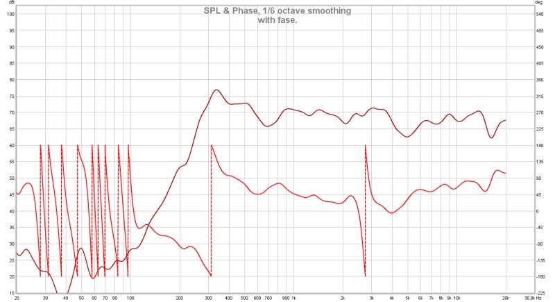

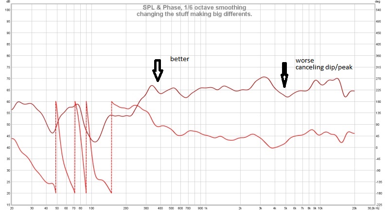

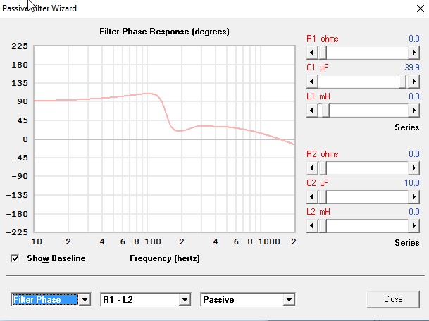

Hi David, in previous post I have some info, I did discover that when using higher compression in a horn, it get more allergic for passive filtering, so a high compression wideband horn do act with giving smaller bandwidth, when using a horn with a throat equal to the Sd of speker do act nicely when using passive xover.
I did saw in past that a tapped horn on a passive xover do also have bad respons, these need a amp and electronic crossover, also here because of higher compression of throat. This way I learn more so I do experiment a lot, I have now make a measurement with a wideband speaker in a horn with 3,5 x 3,5 cm throat and a adaptor, square to round..
Here the sims is with a gap between speaker and horn throat and heavy damping between, (under carped if I write this right). You see the dip 4,5 Khz on picture three is moved to 15Khz when playing with it. and the fase get better also. in picture four, after adjust the gap damping the peak on 300 hz is much better, nice tests.

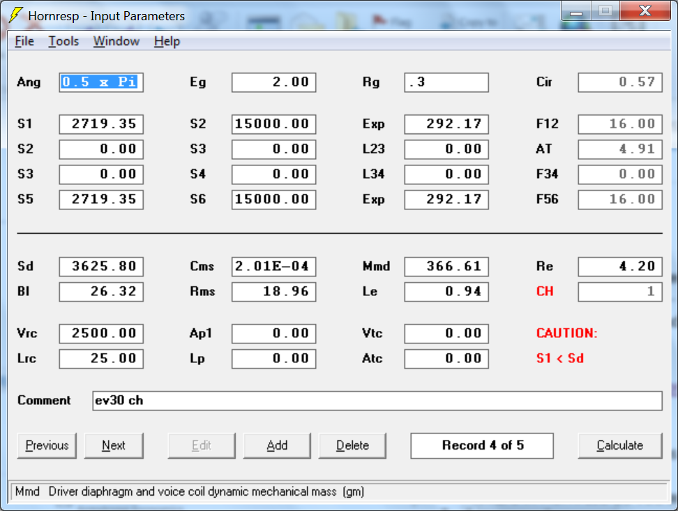

David et all

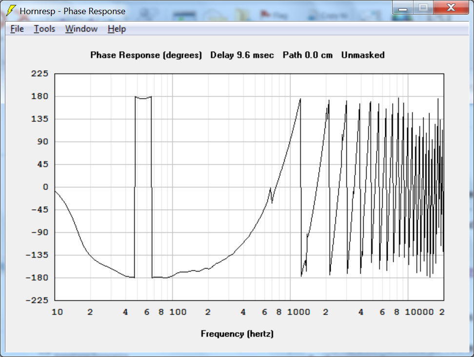

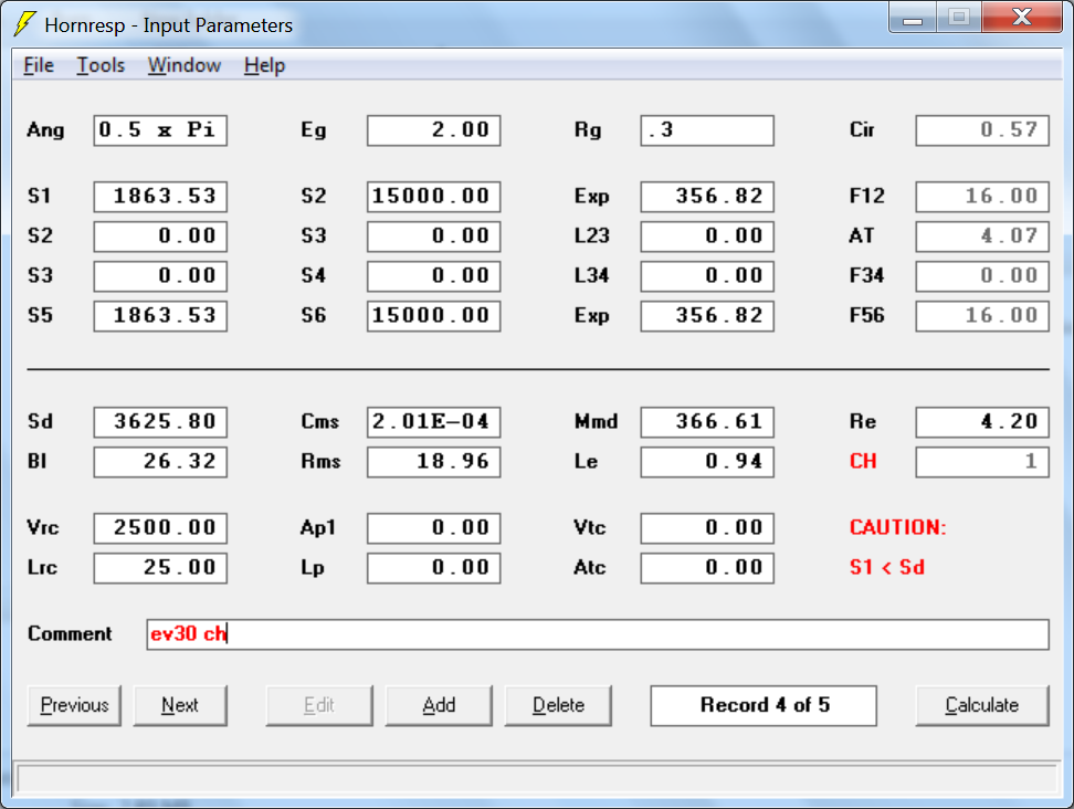

Something seems wrong, it was too easy. Here are the forms from hornresp. Could somebody with more experience in this help me get my low corner up by tweaking something, if possible?🙄
I wonder why it says "caution s1<sd", I got s1 by simulating just the driver in a normal horn so I thought it must be a good ratio.Does this mean I need a throat chamber?
Mike
Mike

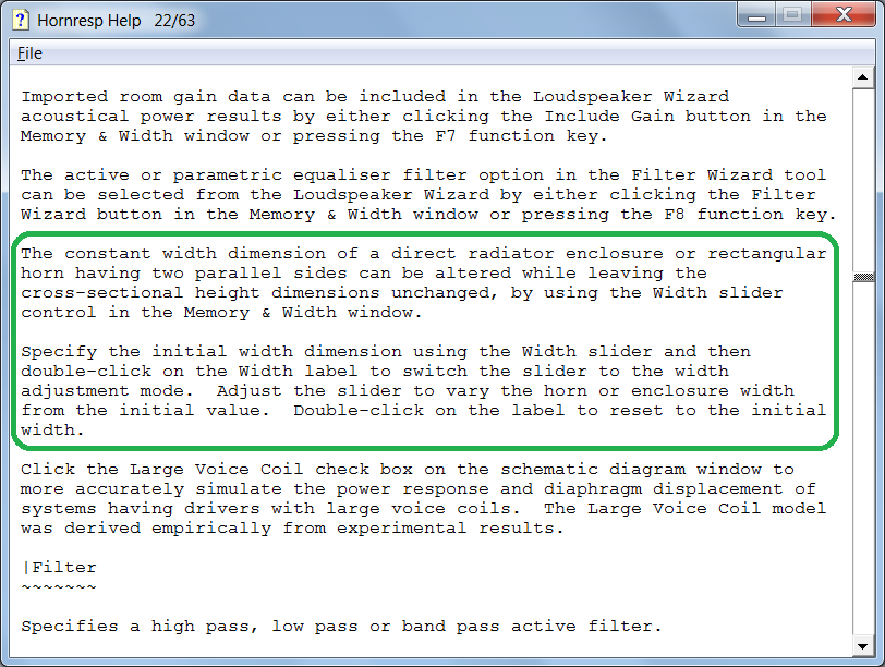

I would like to sim some drivers using a proven design (Othorn) and play with the panel width. Which parameters do I adjust to change the width value?
Hi brookhart995,
Hornresp is only interested in cross-sectional areas and axial lengths along the acoustic path.
1. If by panel width you mean panel thickness, then this not a Hornresp input parameter. Hornresp does not know or care how thick the horn wall panels are, it just assumes that they are completely rigid, and that they do not vibrate or resonate in any way.
2. If however by panel width you mean the distance between the two parallel sides of a rectangular horn, then see the part of the Loudspeaker Wizard section in the Hornresp Help file highlighted in the attachment.
Kind regards,
David

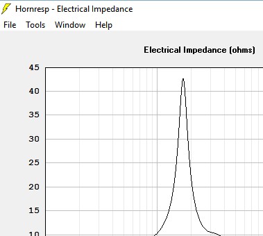

Hi Kees,
This is probably because the electrical impedance of a tapped horn has multiple peaks, making it a difficult load for a passive filter.
Kind regards,
David
I made the ratio lower, but still have "warning s1<sd", but it fixed my dip in low corner. I have this weird phase shift thing happening, is this something that's going to be a problem?
Hi Mike,
1. The S1 < Sd cautionary note is just a reminder that a throat chamber really needs to be included in the simulation to account for the driver diaphragm being larger than the horn throat.
2. The "weird phase shift" is simply due to wrapping at 180 degrees. If you wish, the default-calculated delay value can be increased a little to remove the wrapping at that point. It's just an appearance thing - there's nothing to worry about 🙂.

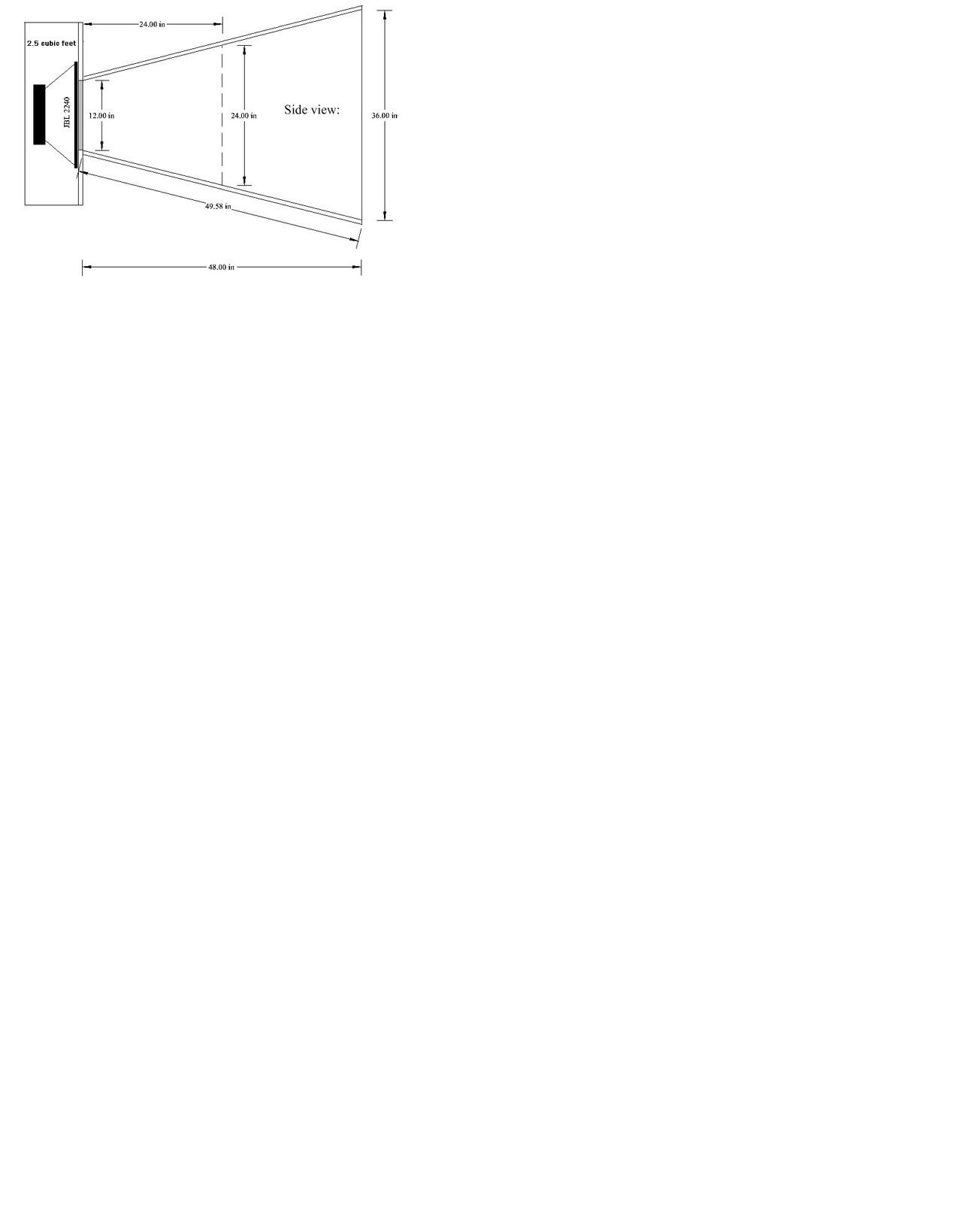

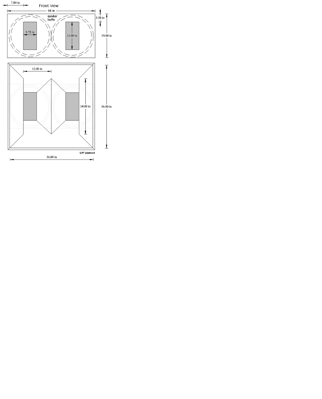

How should I model this?
Wondering how to model this midbass horn. There are two drivers, so Nd=2, and they are "normal" parallel.
I'm thinking it should be done in two sections:
Second section has S3=36x36", S2=24x24", and L23=24"
How about the first section? S1=2x5.75"x12"? and L12=24"
So what about the drivers? Sd would be that of a single driver, like the T/S parameters. Vtc and Atc would be that of the two drivers added?
Aand the rear chamber volume would be of the combined chamber, or half that?
And for a horn playing from 80 to 400Hz and having its mouth sitting on the floor and 1.5m away from the front wall should I use 2*pi or 1*pi?
