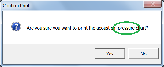

Hornresp Update 3970-160604
Hi Everyone,
The messages displayed when printing an acoustical pressure chart were not correct. They referred to "power" not "pressure". This has now been fixed. Screenprints showing the new correct messages for an acoustical pressure chart are attached.
Kind regards,

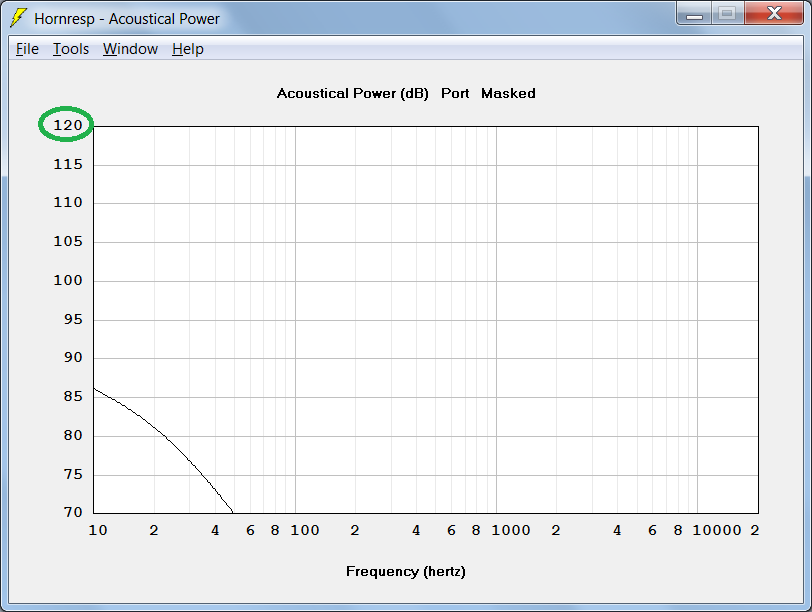

Hornresp Update 3970-160606
Hi Everyone,
BUG FIX
Under some circumstances the acoustical power chart for Output 2 of a two-output loudspeaker system could be displayed with a non-optimum power range. This would happen when the power chart was reselected after the Output 2 directivity acoustical pressure chart had been calculated. The anomaly has now been fixed. Attachment 1 shows a power chart with the incorrect range. Attachment 2 shows the same chart with the correct range, following the bug fix.
Kind regards,
David

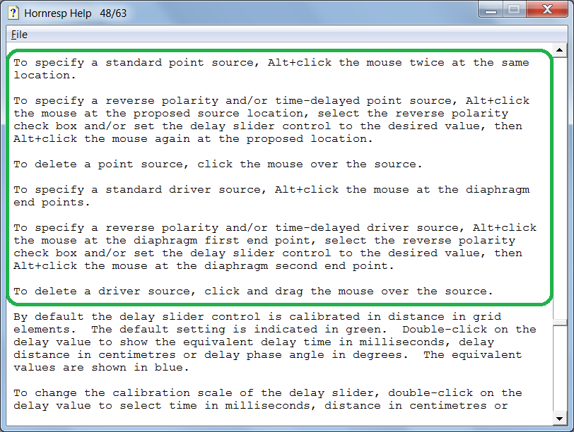

Hornresp Update 3970-160613
Hi Everyone,
CHANGE
The way that sources are specified in the Wavefront Simulator has been changed to hopefully simplify things for the user. Previously, a single source was specified by Alt+clicking the mouse and a multiple sources were specified by Shift+Alt+clicking the mouse. Now, both single sources and multiple sources are specified by Alt+clicking the mouse. See the Wavefront Simulator section in the Hornresp Help file for further details.
BUG FIX
In Edit mode, if the Ang input box was highlighted and the Ang label then double-clicked to change the solid radiation angle, double-clicking the Ang input box immediately afterwards would not activate the Radiation Angle tool. This has now been fixed so that the tool is activated, as originally intended.
