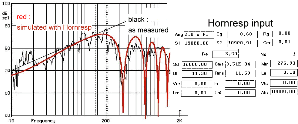

Hello David,
Few months ago I used Hornresp to simulate a large planar loudspeaker called Infraplanar intended to be used as a sub. It is a nearly unbaffled loudspeaker having a very large rectangular membrane (area = 1 square meter).
http://infraplanar.free.fr/photos.htm
As we possess free field measurements of the Infraplanar , I could optimize in Hornresp the path length between the rear wave and the direct wave in order for the response curve to fit the measured one.(see attached file). The optimal pathlength was 96centimeters which is nearly the width of the loudspeaker.
I try to redo the simulation few days ago but it seems that you modified the max pathlength to be lesser than the length of the horn (here 0,01 centimeter long). An error message indicate to me that I cannot introduce a difference of path larger than 0.01centimeter which is the length of the simulated (flat) horn...
I know this was a very strange use of Hornresp but I considered it very convenient...
Best regards from Paris, France
Jean-Michel Le Cléac'h

Jmmlc said:I try to redo the simulation few days ago but it seems that you modified the max pathlength to be lesser than the length of the horn (here 0,01 centimeter long). An error message indicate to me that I cannot introduce a difference of path larger than 0.01centimeter which is the length of the simulated (flat) horn...
Hi Jean-Michel,
The change was made back in February 2009 at the suggestion of Sabbelbacke - see my post #391 in this thread for details.
At the time it seemed like a good idea to both of us, as it appeared to provide a reasonable "sanity check" of the chosen path length difference value. As a result of your post though, I will remove the limitation and revert back to allowing a maximum value of 999,99 cm. I will let you know when this is done (hopefully by tomorrow).
It never ceases to amaze me how people keep finding new ways of using Hornresp 🙂. In the example you have given, the program’s prediction appears to be remarkably close to the measured results.
Many thanks for providing this feedback.
Kind regards,
David

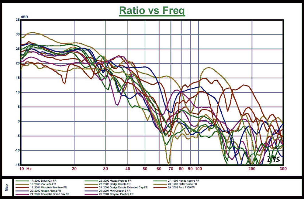

Ok I could be way off here but in a tapped horn design does setting the ang to 0 give an idea of response in a car?
