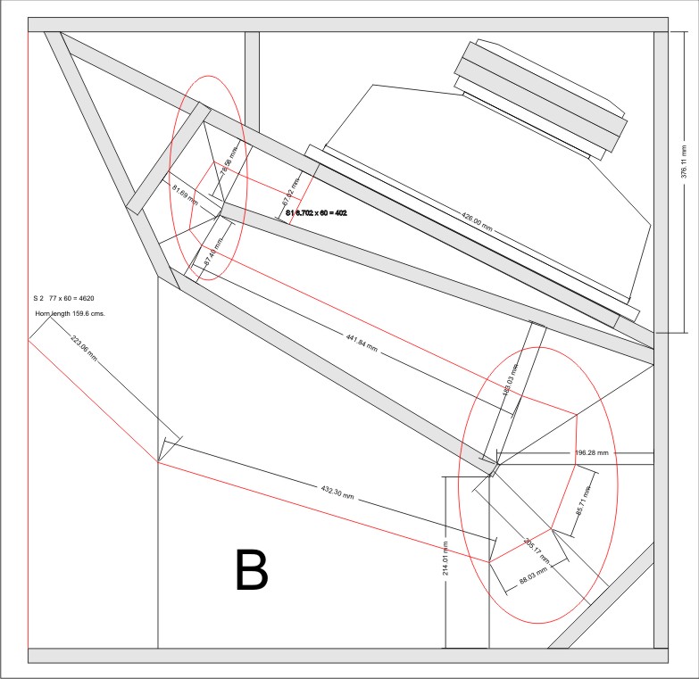

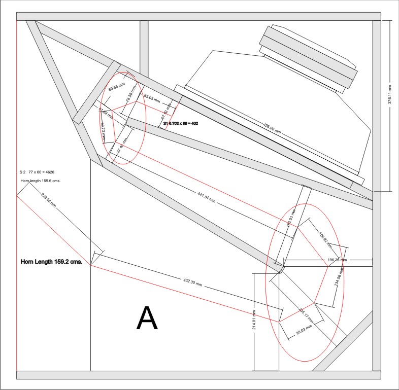

B is what I use (as I read in MJK's papers)palesha said:For measuring the horn length, which is the proper/better method in the drawings A & B of the same box.
The Box B is in the next post
Did you use any specific sofware to produce these drawings?
Eva :
I used Coreldraw for this drawing.
Very user friendly & easy to use.
Can Coreldraw recalculate the dimensions as you move the lines or vertexes?

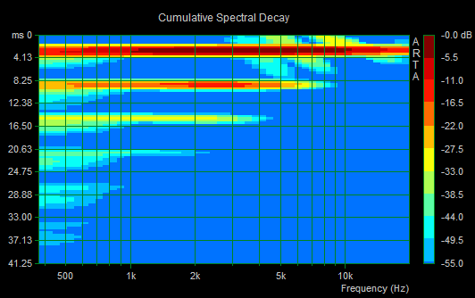

Hello David,
I just tried the new version of Hornresp and I am happy about how the pulse reponse operates. Everyone can now import the wave file in an audio analysis software.
As an example I imported in ARTA the pulse response resulting from the simulation of a TD2001 mounted on a 1 meter long tube and ARTA gave me the CSD you can see in attached file.
Do you think it could be intersting to allow to export the .wav for directivity angles different than 0° (on axis)?
BTW: you still have to improve the phase presentation, as it is very difficult to see the small variation of phase due to a change in an input parameter. ;-)

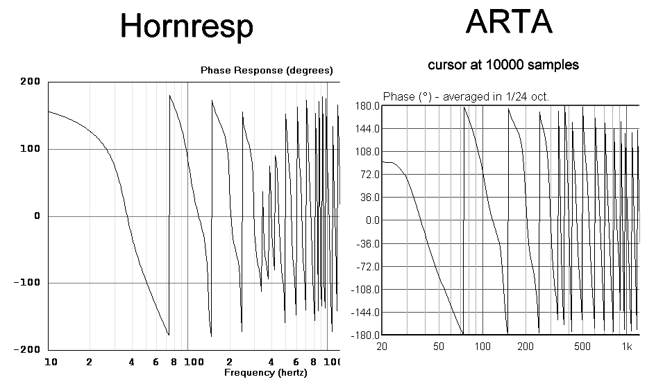

Hello David,
May be you should ask the readers on DIYAudio what they think about the use of a phase curve corrected by a delay.
For loudspeaker measurement generally we introduce an arrival time in order to limit the number of -pi/+pi wrappings.
The equivalent within Hornresp could be a phase correction by a linear phase equivalent to the mean group delay inside the bandwith.
To help the discussion in that message you'll find the phase curve as given at the moment by Hornresp and by ARTA when importing the pulse reponse from Hornresp and setting the cursor at the exact middle of the signal window (sample N° 10 000).
As you see the phase curves are nearly identical (another proof of how good is the export pulse response function).
In a second message I'll show the same phase curve but adding a delay.
Best regards from Paris, France.
Jean-Michel Le Cléac'h

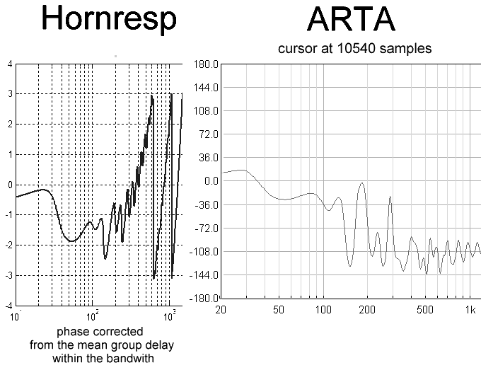

David McBean said:Can I assume that showing "corrected" phase would overcome the problem? 🙂.
Kind regards,
David
Hello
Attached to this message you'll see, on left, a first graph showing the phase curve given by Hornresp but corrected by the mean group delay within the bandwith.
On right you'll see the phase curve given by Arta when the cursor is set at sample 10540.
In both case it seems to me that we can see more easily some phase variations which are difficult to see in the original phase curves.
