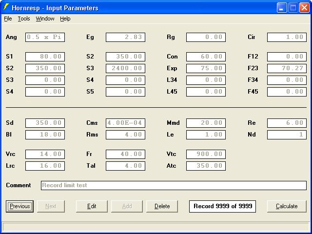

Hornresp Version 21.40
Hi Everyone,
I managed to find a few spare hours over the weekend. Hornresp can now calculate the impulse response for any horn loudspeaker system. Results are slightly different to those generated previously, but should be more accurate.
Also, the limit on the maximum number of data records has been increased to 9999 - hopefully this will be enough even for GM 🙂. With 9999 records, the Hornresp.dat data file size is 3526 KB.
Version 21.40 refers.

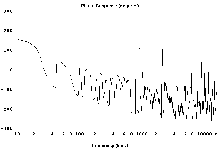

Hello,
As David wrote, the method used to derive the pulse response in Hornresp is different. Specially IFFT is not used.
A discrete inverse Fourier transform based on a log scale of frequency as the one in Hornresp (533 frequency points) is used.
As I told to David, the initial hypothesis is a continuous spectrum. When both the SPL and phase spectrum in Hornresp are continuous, then the calculated pulse is perfectly correct (and we can recover by FFT the same SPL and phase curves as initially caclulated in Hornresp).
Now there is 2 cases where in its actual version the pulse response is questionable.
1) when the phase spectrum is not continuous and shows 360° rotations through -180° and +180° limits.
As an example I took the TH example given by Oliver (tb46) in
http://www.diyaudio.com/forums/attachment.php?s=&postid=1798784&stamp=1239376483
You'll find in attached file the phase plot that shows several 360° rotations from a frequency point to the next.
This should be fixed if we unwrap the phase (easy to say not so easy to do...). I'll work on it...
2) when the combined response between a front wave and a rear wave is calculated the pulse response shows artifacts.
This is most probably due to the fact that Hornresp doesn't recalculate the phase response which remains unchanged. May be David can see if this "bug" can be fixed.
About Eva's remark, I second David, the hypothesis of a minimum phase behaviour allowing the use of the Hilbert transform to derive the phase from the SPL curve is questionable in the case of long resonant horns (having tubed pipe behaviour) , and in the case of a combined response.
Best regards from Paris, France
