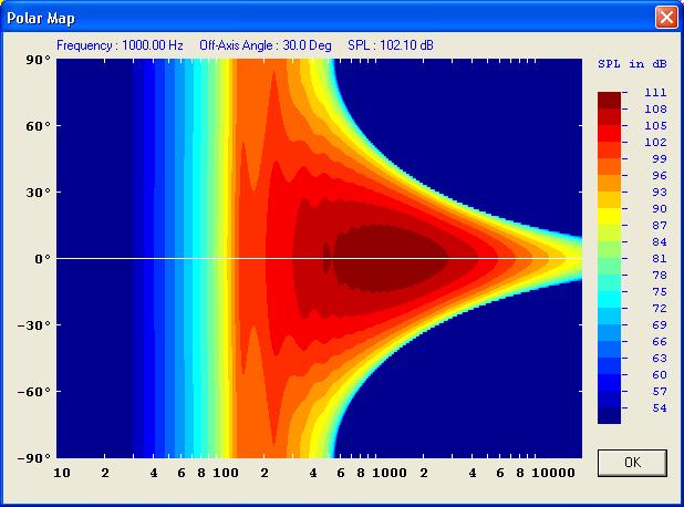

Hornresp Version 21.20
Hi Everyone,
Hornresp Version 21.20 has just been released. Directivity polar maps can now be generated using the Tools > Directivity > Polar Map menu.
While Hornresp polar maps are not as accurate as those produced using Boundary Element Method techniques, they nevertheless give a reasonably useful insight into the directivity characteristics of horns and OS waveguides.
Note that moving the mouse pointer over the map area will display the SPL value for a given frequency and off-axis angle. In effect, the polar map shows on the one diagram all the information available from a family of directivity response curves generated at different off-axis angles.
Note also that polar maps for constant directivity devices (conical horns and OS waveguides) take longer to produce than those for other horn types because more calculations are involved.
As always, could you please let me know if you find any bugs in the new release, regardless of how minor they may seem to you. Many thanks.

Re: Hornresp Version 21.20
Hi Everyone,
Further to my message above, I should have mentioned that a Hornresp polar map takes only minutes to produce, whereas a BEM plot generated to the same resolution takes many hours 🙂.
Kind regards,
David

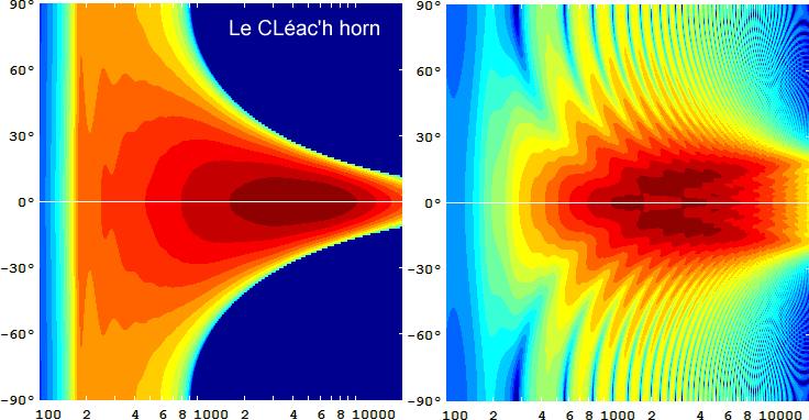

Re: Re: Hornresp Version 21.20
David,
That's a great step for Hornresp!
Another interesting feature to add to Hornresp should be the exportation of a calculated pulse response.
Thank you a lot for all!
attached 2 polars: one for a FC = 160Hz T = 0.8 Le CLéac'h horn, the second (right) a waveguide of the same overall dimensions.
Best regards from Paris,
Jean-Michel Le Cléac'h

Directivity (beaming) of diaphragm?
Hornresp don't seem to take this into account.
How does this affect the accuracy of plots with large drivers?
Would there be possible to get a directivity plot of a closed box (extremely short 'horn') out of hornresp? Using 1cm straight guide seems to be OK for lower frequencies (i think) but for HF I'm not sure where the model falls apart.
Or is the plot only meant to show you ripple and other stuff you want to be aware of when designing?
BTW the polar plot is fun to play with. It's so much easier to see and imagine directivity.

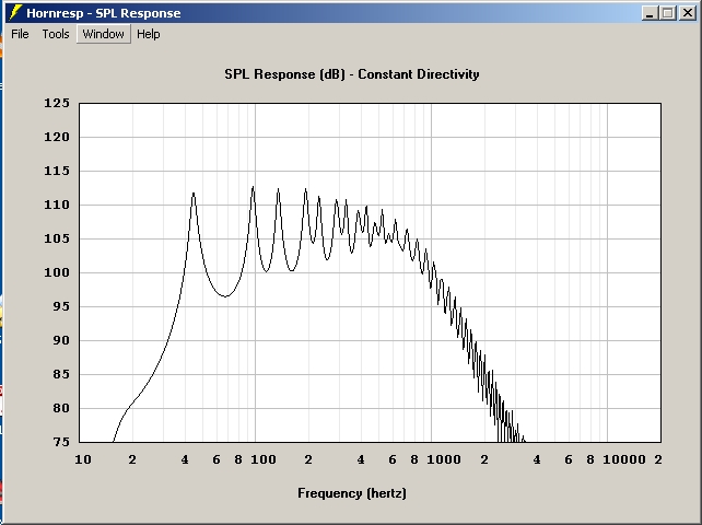

Strange peaks in phase and GD when using damping material.
When I use damping in a closed box I get strange peaks.
They appear regardless of damping density.
Also the SPL response at 100-800Hz is altered and is virtually the same regardless of density. It only changes with thickness.
This is with a 15" speaker in a 30L box btw.

Re: Re: Re: Hornresp Version 21.20
Hi Jean-Michel,
I looked at the feasibility of doing this some time ago, but decided not to proceed because of the amount of work involved.
Thanks for posting the two polar plots. I know which one I prefer 🙂.
Kind regards,
David

Hi David_Web,
As indicated in Note 2 on page 15 of the Hornresp Help file, the driver diaphragm is modelled as a rigid plane circular piston. I have no plans to change this. It is virtually impossible to take cone angle and surface resonances into account unless finite element analysis techniques are used (assuming that the cone geometry, material structure and vibration characteristics can be accurately specified in the first place).
For a direct radiator in a closed box, set S1 and S2 = Sd and L12 (Exp) = 0.01. The directivity results will be similar to those for a rigid circular piston in an infinite baffle.
As you have discovered, damping is very dependent on the thickness (or more correctly, the volume) of the acoustical lining material.
Kind regards,
