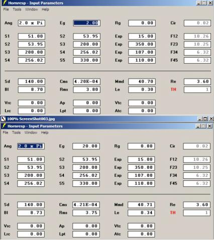

Entry field changes
Hi David,
Please, note the differences in the Cms, Mmd, Bl and Rms entry fields, they are not intentional, and seem to happen during recalculation particularly when using the Tapped Horn Wizard. Similar rounding errors (?) occur in other fields like Eg and Rg.
Changes this small will surely not make any difference, but I know by now that you want to know.
Hi David,
Re: Entry field changes
Hi Oliver,
Many thanks for this feedback - I see what you mean 🙂.
By way of explanation - when the Tapped Horn Wizard is used, scroll bar values are intentionally rounded to improve the sensitivity and speed of operation of the sliders - see my post #261 earlier in the thread for further details.
What I hadn't realised though, was that even if the scroll bars are not accessed or adjusted when the Wizard is opened, values are still rounded.
I will see what I can do over the next few days to improve things, and let you know how I get on.
Thanks again for bringing this matter to my attention!
Kind regards,
David

scroll bar values
Hi David,
I read post #261, and this is obviously similar. Thanks for looking into it for us.

New Release
Hi Everyone,
I have now updated Hornresp to correct the Tapped Horn Wizard problem reported recently by Oliver (tb46). Scrollbar values are now rounded only when a slider setting is actually changed. The new release is Product Number 2110-090327.
Sorry for any confusion or inconvenience that may have been caused. Thanks again to Oliver for the excellent feedback.

scroll bar values
Hi David,
I just updated to V2110-090327, and everything I have tried sofar seems to work well. No more "little rounding errors". 🙂

Re: scroll bar values
Hi Oliver,
Wow, that was fast!
So far so good, it seems 🙂.
Hi Oliver,
Just letting you know that I have made yet another small change to the Tapped Horn Wizard 🙂.
I was not entirely happy with the way that the sliders worked after the recent update to overcome the rounding problem. For example - the Eg scroll bar default setting of 2.83 would decrease to 2.70 rather than to the closest rounded number of 2.80 when the "<" button on the left-hand side of the scroll bar was clicked. This has been corrected in Product Number 2110-090330.
It is only a minor refinement I know, but I want the operation of Hornresp to be as perfect as possible 🙂.
