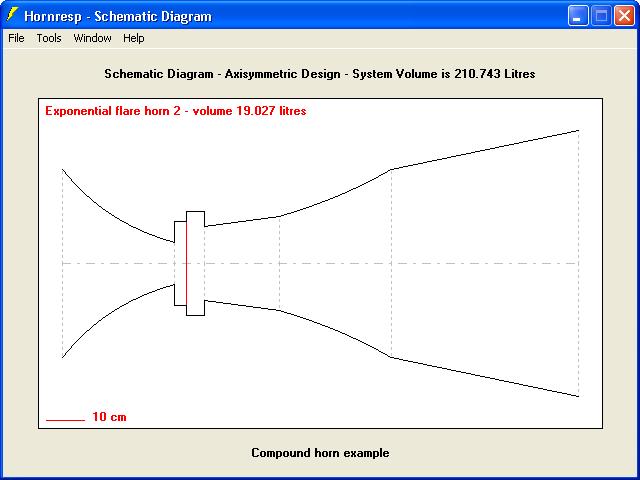

Hi Everyone,
Just letting you know that Hornresp can now model conical and/or exponential flare compound horns. Version 21.00 refers. See Note 9 on page 16 of the Help File for details. Could you please report any bugs. Thanks.
Kind regards,
David

Hy David,
this is sooo nice 🙂 Works good. Funny SPL-things happen if the driver has the exact same horn on both sides 🙂
my thoughts so far:
- when in CH mode, it might be useful to block the "systems design" button. Right now one can select a design - the result is a new horn in segment 1, the CH leftover in Segment 4 is still active, resulting in invalid input data. Or the "systems design button" could be left intact and a reset of input data could be added? (Of course, a system designer for al kinds of horns would be great: "please state desired end-product" - hornresp does the rest. ... Just kidding 🙂 )
- A path length difference greater than the sum of all segment-lengths should be impossible to realise, maybe a little check or a reminder when exceeding the overal length in the "combined response" field could be nice? (ok, this realy is minor)
- Old saved data from prevous versions seem to work fine 🙂
- Switching from 4Seg TH to CH back and forth without changing values keeps everything intact. Interesting, how close both SPL charts are to one another when just switching (PA Sub, Ciare 12, 2Pi, 300l, 4 Segments)
- When changing A 4 Segmented CH with both back- and compression chamber back to TH, this happens:
Which looks quite funny 🙂 If the CH had S5 =! S4 (which is ok for CH, but not for TH) S4 is forced to S5, which also seems correct. But now one has "invalid TH data" - but the calculate Button still works which might be confusing.
I`d love to play around more, sadly I have to get some work done (7:00 AM here). Will do some more testing later.

Hi Sabbelbacke,
Excellent work! You have already given me some things to look at over the coming weekend 🙂.
I will let you know how I get on.
Kind regards,
David

Hi Sabbelbacke,
I just couldn’t wait until the weekend to fix things 🙂.
This is to be expected. While I was checking however, I discovered that if horn 2 had a conical flare with S5 = S6, then a fatal 'Division by zero' error would occur when calculating the combined response. This has been corrected.
The data in the horn segment 4 input fields should automatically be reset to zero when the System Design tool is used. This has been corrected.
Great pickup - I had missed that one 🙂. The normal upper default limit of 999,99 cm has been changed so that it is now the sum of all the segment lengths plus chamber lengths. A warning message is displayed if the limit is exceeded. Note that for an offset driver horn, the value of L12 is not included.
This should always be the case. If any new version cannot read the saved data from a previous version, then something is definitely wrong.
The Calculate button should be automatically disabled (which in turn disables the View Schematic tool). This has been corrected.
It should not be possible to calculate results for an invalid horn configuration. This has been corrected.
The above changes are included in Product Number 2100-090206.
Thanks again for all your help, it is very much appreciated!
Could you please let me know if you find anything else.
Kind regards,
David
