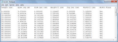

I wish to build a 80 Hz Le Cleach Horn, terminating at 90 degrees with a throat diameter of 25mm.
A throat diameter of 25 mm seems rather small for a 80 Hz horn. Did you mean 25 cm?
It will be 4 sided, all sides equal in size. When I export the data does that give the coordinates for each panel, so they will flex into the correct shape? Or does it produce the coordinates of the final horn, as if it has been cut thru the central plane? Similar to the round horns. I hope this makes sense, basically i want to plot the exported coordinates, make a horn mould with bendy ply and bracing.
Assuming that the horn data is exported using the Rectangular Horn option rather than the Petal Horn option, then for the attached Lec.txt file (with 25 mm throat diameter):
'Height/2' plotted against 'Side Len' gives the flat profile of one side of the horn, which can then be bent to make a horn mould.
'Height/2' plotted against 'Length' gives the standard elevation view of the horn, as shown in Attachment 4.
(Height/2 is the half-height - the distance either side of the centre-line)
See the Export Horn Data section in the Hornresp Help file for further details.

Great Thank you David. I did mean 25 mm, I am playing with some compression drivers and looking for a 100-150 Hz cut off to go above my 16 Hz bass horn I have.
