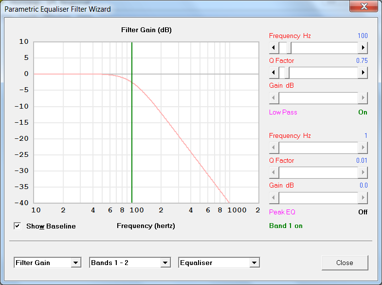

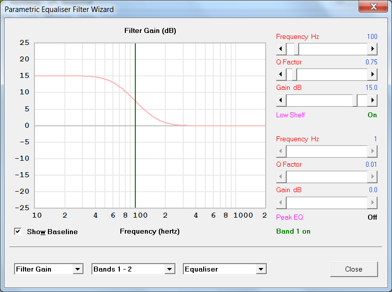

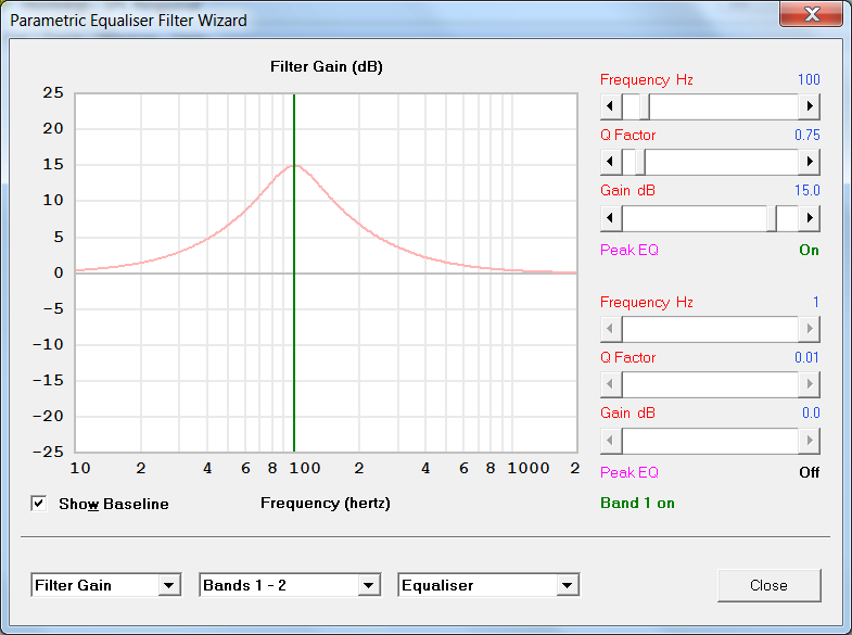

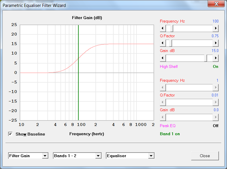

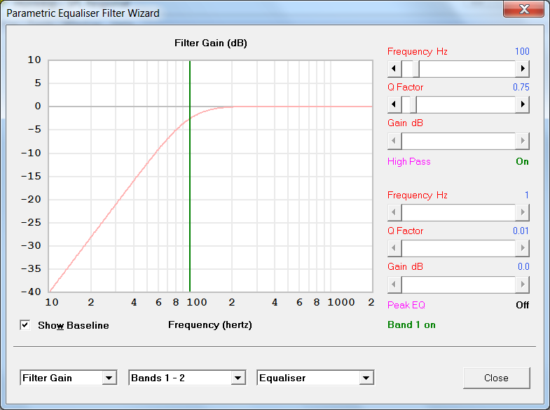

Hornresp Update 3440-140409
Hi Everyone,
A parametric equaliser option has been added to the Filter Wizard. Up to six equalising filter bands can be selected. To switch a parametric equaliser filter band on or off, double-click on the On / Off label for that band. To select either a peaking EQ filter, a low shelving filter, a high shelving filter, a low pass filter or a high pass filter for a given band, double-click on the filter label for that band.
Note:
If any filter band is switched on, current active and parametric equaliser settings (but not passive and Le Cléac'h filter settings) can be saved to the permanent data record.
If all filter bands are switched off, current passive, active and Le Cléac'h filter settings (but not parametric equaliser settings) can be saved to the permanent data record.
The above arrangement is used so that the permanent data record remains at its current length.
Kind regards,
David
