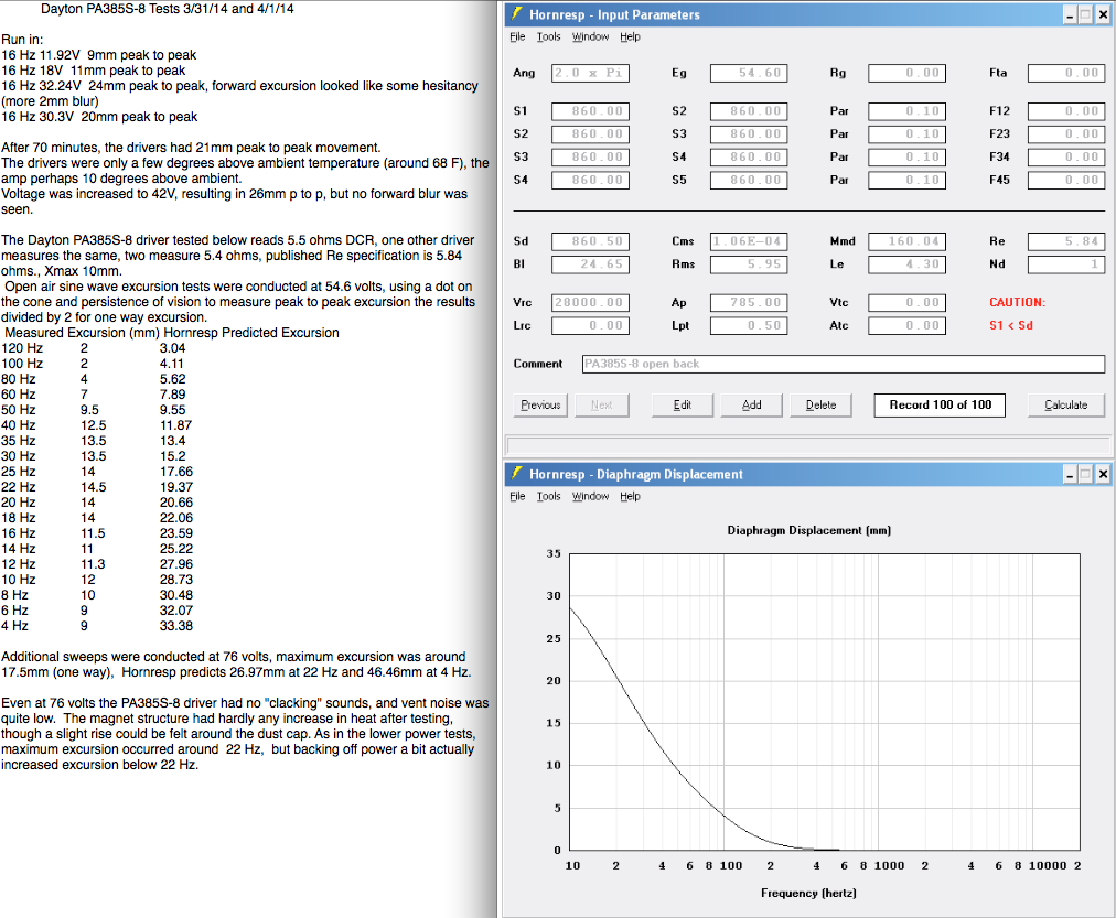

David,Careful measurements done by Bjørn Kolbrek some time ago showed the predictions of diaphragm displacement to be quite accurate, provided that the driver operates linearly and a sinusoidal input signal is used.
Unfortunately the links to Bjørn's measurements no longer work.
Although Hornresp is quite good at predicting excursion within the linear range of operation of a loudspeaker, that is displacement at or below Xmax, it is not accurate above Xmax, where most users are concerned regarding placement of filters to protect drivers from over excursion. Since it predicts more excursion than usually will be experienced, it is a benign problem, but an inaccuracy nonetheless.
Above Xmax the driver's BL (magnetic force) drops off, as the voice coil progressively leaves the magnetic gap there is no longer the force left to push a stiff suspension past a certain excursion. Hornresp does not take the dropping BL into account, and it appears to consider the suspension to have near infinite elasticity and linearity, obviously not the case for many PA type drivers which "put the brakes" on excursion before the voice coil hammers the back plate.

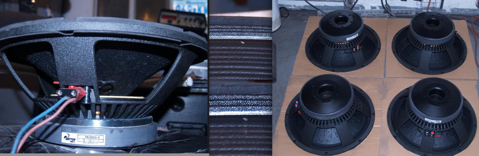

Attached are sine wave tests conducted yesterday and today on some new Dayton PA385S-8 drivers, which are designed with many features similar to higher priced Italian drivers. As you can see, measured results are quite close to the Hornresp simulation up to a bit past Xmax, but then diverge more and more, the simulations off as much as three times down in the lower frequencies.
This observation is why I am amused by user's delight in your addition of filter models and your consideration of PEQ filters, as the range below Fb is exactly where the simulations will differ most widely from measured results 🙂.
Art
No, but I plan to shoehorn them in some small cabinets and measure the frequency and distortion response 😉.Looks nice Art, any plans to measure the TSP's?
The open air tests make me think they are going to perform quite well.
