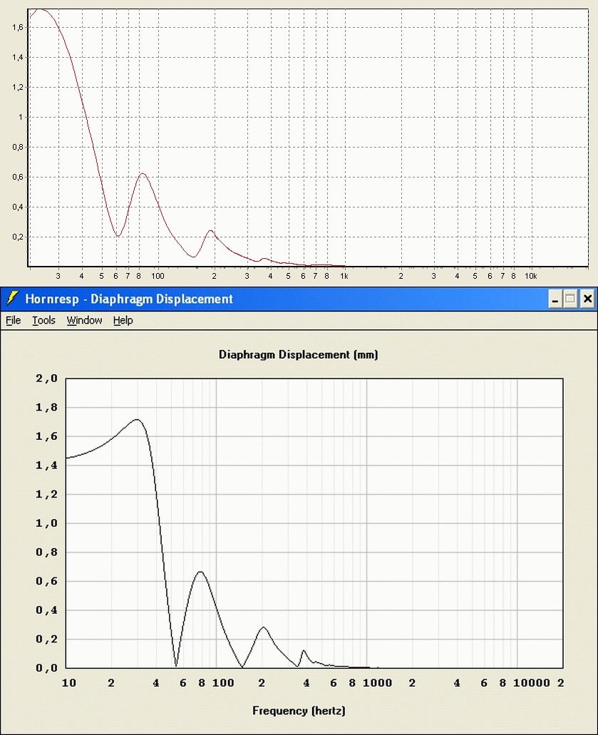

Hi Mark,
Here's the measurement I made, compared to the Hornresp prediction.
What I did was as follows: I attached a Measurement Specialities ACH01 accelerometer to the dust cap of the driver, and fed it through a preamp to my computer. I measured the impulse response using Arta, and postprocessed the impulse response to get the displacement. The post processing was FFT, followed by double integration (divide by (2*pi*f)^2) and a scaling factor determined by the sensitivity of the accelerometer, preamp gain etc., and checked by a reference measurement.
-Bjørn
I should contact Bjørn and find out what he has done so as to not duplicate it.
-Bjørn

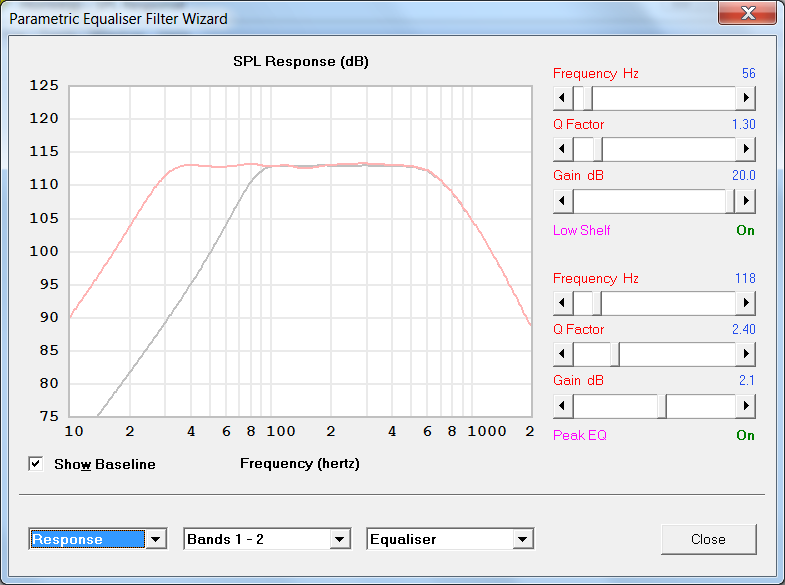

Originally Posted by David McBean
perhaps the Filter Wizard tool should be removed from Hornresp
Don't you dare 😀
The EQ is looking good 🙂

the filter wizzard is a verry usefull tool for most of us.Hi Art,
As stated in the Hornresp Help file, behaviour at all input voltage levels is assumed to be linear, with no allowance being made for low frequency high power amplitude compression. It is impossible to take non-linearities into account given the limited set of input parameters used to specify the driver, and the manufacturer is unlikely to provide the necessary additional information - if indeed they have it 🙂.
In that case, perhaps the Filter Wizard tool should be removed from Hornresp - I only implemented the feature because of ongoing requests from users. As people may recall, I didn't really want to do it anyway. It seems a bit of a shame at this late stage though, given the number of hours expended on the project. Also, I am finding that the development version of the proposed parametric equaliser is quite fun to use... 🙂.
Kind regards,
David
like you say,non linearities have to be taken in to account.
Please, keep the Filter Wizard.

@ Bjørn
Interesting. What was the loading of the driver?
Free air, or some enclosure?
@ Bjørn
It was measured on a tapped horn, to check if the Hornresp predictions were accurate.
-Bjørn

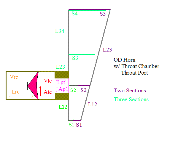

Hornresp and multiple drivers
David,
I'm a new-bee here and tried to find the answer on my question, but could not find it or overlooked (sorry..) 😱
I was trying to model a unity horn with 4 mid drivers. started with one driver, all OK. I used the "bottom" 6 fields of the input window to be specific on how the driver was connected to the horn. Makes a LOT of difference from keeping all the 0,00.
Vrc for the back volume (chamber) of the driver
Lrc As the longest distance in the chamber
Ap1 for the TAP circumference
Lpt as the depth of the TAP (started by entering the wood thickness)
Vtc as the volume between the Cone and the horn
Atc as the circumference of the driver at the point where the driver is connected to the horn.
When I got it right for 1 driver (flattest response for the bandpass i needed) i thought (and THAT's the main topic of my question) I use the Tool/Driver arrangement (Ctrl + D) to enter 2 driver parallel and 2 serial to work with 4 drivers.
I assumed that Hornresp does the values x 4 of the parameters above (except for Lpt?) to calculate the new driver arrangement, but the outcome was very unexpected, so APPARENTLY NOT?
1 - Do I have to multiply ALL of the parameters by 4?
2 - I still assume Lpt is always the depth of the port?
Besides these 2 questions, when i want to add Bass reflex ports in the back chamber, do I need to enter the total volume of the 4 drivers? I tested with Bassbox Pro and 4 8 inch drivers, which gave a volume of 20 liters for a port tuned at 105 Hz. When i entered 20 liters as the back chamber volume Vrc, the result was a severe drop in response from 300 Hz downwards.
3 - Did you account for this in Hornresp (larger Vrc then needed for the horn) or is not in the program.
LAST question, on the Eg parameter and multiple drivers.
Suppose i have 1 driver, 100 watts 8 ohms. I enter 28,28 in the Eg parameter for 100 watts, works OK. Now 2 drivers, both 100 watts 8 ohms parallel, makes 200 watt 4 ohms. Normally the amp will go to less than 200 watts at 4 ohms, say 180 watts.
4 - Do I enter 100 watts (28,28) and 2 drivers and does Hornresp account for 180 watts at 4 ohms as delivered by the amp? Or do I enter 37,95 in Eg as 180 watts.
Or do I enter 90 watts (26,83) for the driver, since both drivers now each get 90 watts instead of the one driver 100 watts.?
Again thanks for the clever tool, now it's up to me using my brains (sigh) 😀
kind regards,
Frans Wessels
btw I will start posting when i got most of the flaws away from my side......

Hi Frans,
Further to Dan's comments, and to answer your specific questions:
Multiply Vrc, Ap1, Vtc and Atc by 4.
Leave Lrc and Lpt unchanged.
Vrc is the effective enclosed air volume behind the driver diaphragms. Do not include the volume of the 4 drivers in Vrc.
Did you use the Combined Response tool to calculate the overall system output?
If Eg is 28,28 volts and Rg is zero:
For two drivers connected in parallel, 28,28 volts is applied to each voice coil.
For two drivers connected in series, 14,14 volts is applied to each voice coil.
The actual power delivered by the amplifier will depend on the electrical input impedance of the loudspeaker, which varies with frequency.
Kind regards,
David
Kind regards,
David

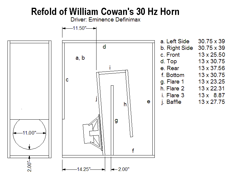

I have tested some Tapped horns, like the THAM12 (VERY OK and small to handle, maybe a bit to small for a PA sub) and started my own version which is slightly bigger (longer horn path to make it go deeper (40 Hz) and wider to get enough volume as stated by Hornresp and make it easier to mount the drivers. It will be a different folding as the THAM12 with the driver magnet facing the mouth (so standing up instead of laying down).
Like in the picture added (fold of William Cowan's)
I added reflectors to the THAM12 (to stay close to the Hornresp Schematic) and used a fairly large magnet driver in the THAM12, so most likely i wasted to much volume to make it work. My fault..... 😱 I will build a wider THAM12 to make the volume the same as stated in the SIMM for the THAM12, but keep the folding the same as the original. It is a very promissing design (like it compact and loud). I tested 2 of them outside (that's the minimum to use i guess) on a 2x 50 watts HIFI amp and a CD player, enough volume for a party in the garden i guess.
I will post the whole set when the results are what i would like them to be. As of now, it is still designing, building and testing and i guess we have seen enough of that here so i thought "Why would i repeat what has been written over and over". And to be really honest, i don't like to make a fool out of myself more then once on this forum, since there are plenty of guys who REALLY now how it works.😱
