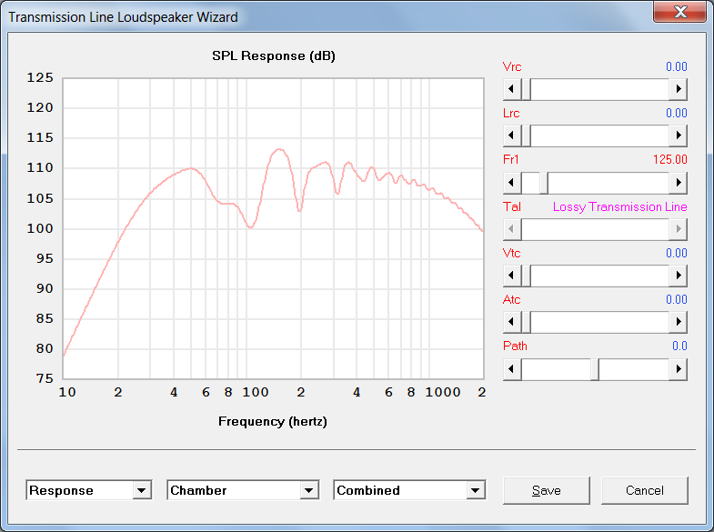

Hi just a guy,
If it is not too much trouble, would it be possible for you to do another comparison using the same Polyfill stuffing material as before, but in system having different cross-sectional areas and lengths? It would be very interesting to see if the density versus flow resistivity relationships remain constant.
That is:
0.25 lb/ft3 ~ 125 mks rayls/m
0.50 lb/ft3 ~ 400 mks rayls/m
0.75 lb/ft3 ~ 600 mks rayls/m
Thanks in anticipation.
Kind regards,
David

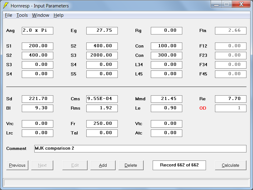

I'm happy to help in any way I can. Just give me a input screenshot or Hornresp import file of what you would like to see simulated and I'll run the numbers through both programs and do another comparison.
Hi just a guy,
Excellent - many thanks!
Data attached as requested.

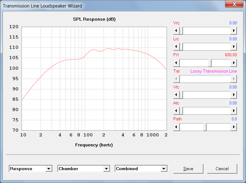

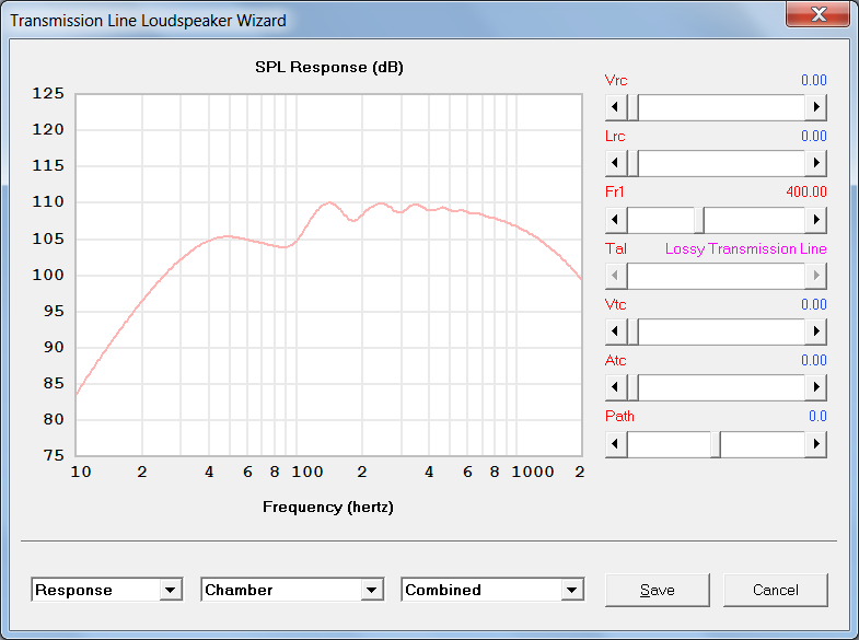

I didn't even look at the attached text file, I just used the input screenshot.
I had to use MJK's TL_Sections worksheet for this one since it isn't a straight line, it's pinched at S2. (I used the TL_Open_End worksheet on the previous comparison).
As always, check my inputs, if those are not correct nothing else will be.
I compared exactly the same thing as last time.
0 lb/ft - 0 Fr1
.25 lb/ft - 125 Fr1
.5 lb/ft - 400 Fr1
.75 lb/ft - 600 Fr1
Same as last time, I think 125 is a bit too low to correspond with .25 lb/ft but the other two seem to be in the right ballpark. Definitely in the right neighborhood at least.
And remember that MJK's software assumes polyfil stuffing.
Let me know if you need anything else.
