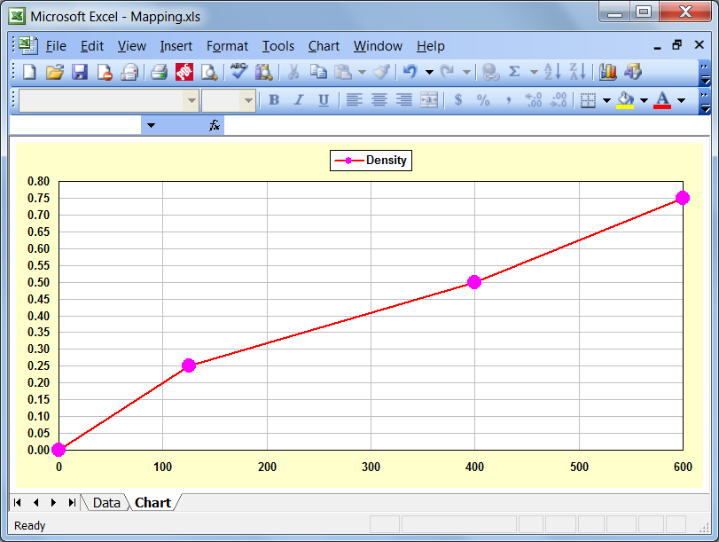

Can MJK's software accept densities other than the three used so far in the comparisons?
Yes, you can enter any number you like, including decimals. I don't usually use more than 3 decimal places but you can probably get REALLY fractional if you needed to.
It would be nice to be able to add a few more data points to the attached chart, so that a more complete conversion mapping can be developed.
Tell me exactly what you need and I'll get to work on it asap.

Sure, MJK's software even gives a summary at the end of the user inputs before the calculations starts that lets the user know how much total stuffing is needed.
The problem here, as I've mentioned at least a couple of times, is that the two programs calculate some things differently so it's hard for me to tell exactly how much stuffing in Hornresp is equal to the amount of stuffing in MJK's. And I don't want to be responsible for making that call. Clearly my guessing is in the right ballpark but it's not a perfect match.
If you want I can send a whole bunch of graphs of the same tl(s) with many different stuffing levels (a lot more than 0, .25, .5 and .75 lb/ft) and you can make the judgment on what value of mks rayls/m = a given density of stuffing in lb/ft or kg/m or whatever.
One final note - MJK warns that once you get past 1 lb/ft, his software predictions might get unreliable. I don't think he tested past that level, and if he did he probably got unfavorable results. There's not much need to stuff any denser than that anyway or the stuffing is going to turn into a solid mass, but just thought you might like to know.

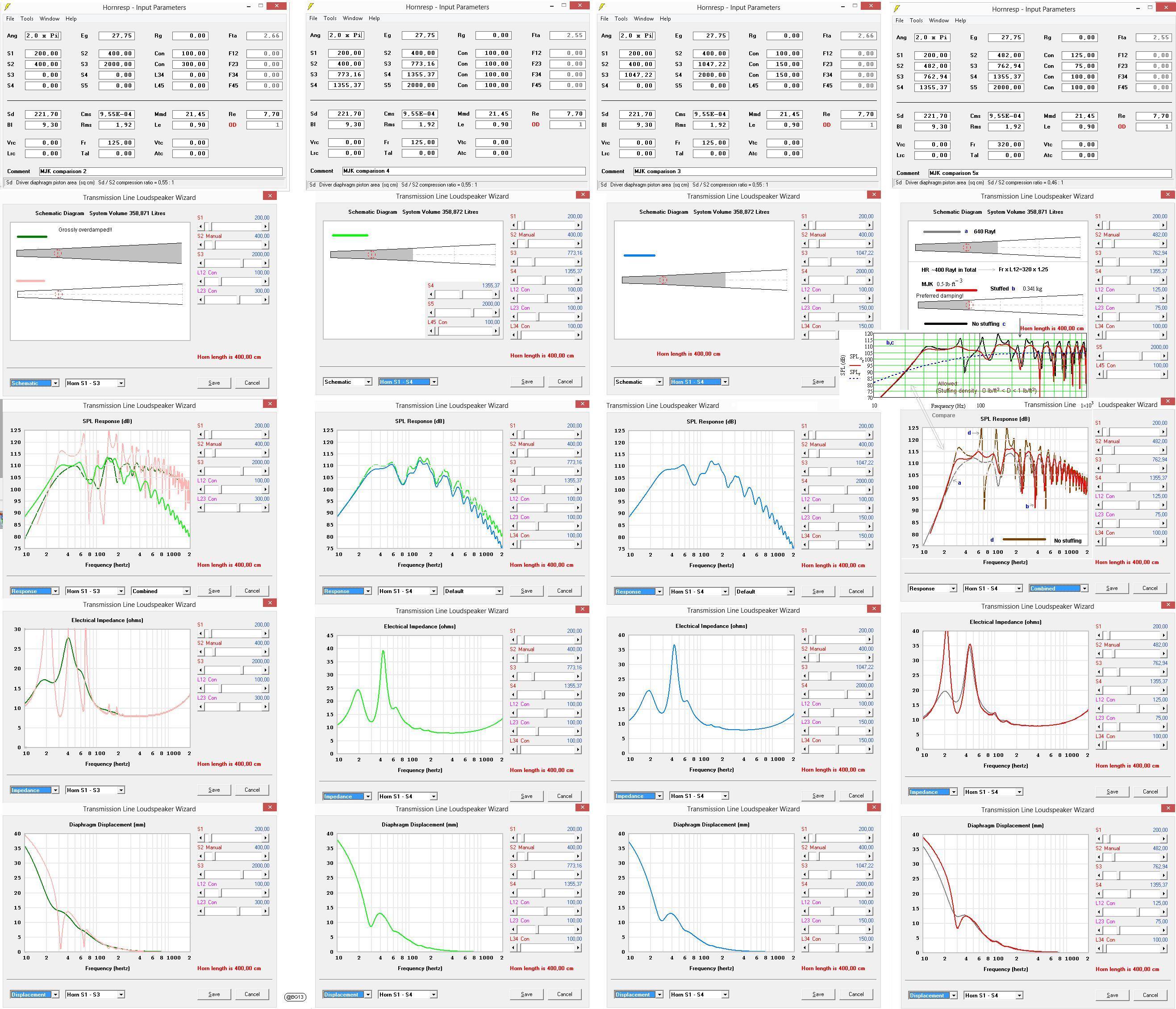

Are you kidding me? How much time did you spend making this program that I use ALL THE TIME? I'm sure I can find the time to help you make it even better. It should only take an hour or two, it's no problem at all.
It shouldn't need to be zipped, I'm just going to send 4 pictures, probably around 1 or 2 Mb total. 2 pictures showing each example's entire worksheet screenshot (so you can verify I'm doing it right) and 2 pictures showing each example's 21 levels of stuffing graphs.
I thought the difference might be due to PAR segments, so that part is up to you now. I have no options in MJK's software, you'll have to switch your Hornresp sims to PAR.
I'll capture the graph that shows the individual driver and terminus output for you instead of the combined output. I'll also label each graph with amount of stuffing (in lb/ft) and the total amount of stuffing in the line (in lb).
Hopefully it will be in your inbox tonight, I'm going to start working on it now. Hopefully I won't be interrupted too much and I can finish it all today.
Done and sent.
As always, check my inputs in case I made any mistakes and let me know if you need anything else.
Done and sent.

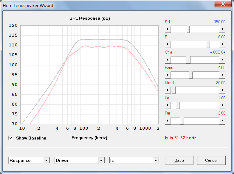

Thanks for the links. They confirm that the calculation of power compression is not a trivial exercise. It is simple enough though, to demonstrate the effect without knowing absolute values by substituting 2 * Re for Re and observing how the SPL response, diaphragm displacement, etc, change.
The attached example shows the Hornresp default record with Re increased from 6 ohms to 12 ohms.
Kind regards,
David
