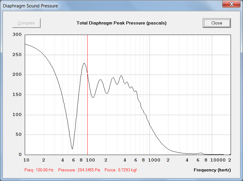

Not at all - I found the discussion to be most interesting. It encouraged me to think more analytically about what the AkAbak Driver (diaph) Driver results really mean 🙂.
The summing formula I gave is correct for the data as presented in the AkAbak charts, where the pressures on both the front and rear sides of the driver diaphragm are shown as positive values. That is:
((P1R + P2R) ^ 2 + (P1X + P2X) ^ 2) ^ 0.5
For a vibrating diaphragm however, when the instantaneous front-side pressure P1 is positive (compression) the rear-side pressure P2 is negative (rarefaction). This means that strictly speaking, a difference formula rather than a summing formula should be used to obtain the same correct result. That is:
((P1R – (–P2R)) ^ 2 + (P1X – (–P2X)) ^ 2) ^ 0.5
This makes more sense - you may recall that early on in the discussion I had assumed that the Driver (diaph) Driver result should be a vector difference and not a vector sum.
In Hornresp I have called the Driver (diaph) Driver result the "Total" pressure. It shows the difference between the pressures on the front and rear sides of the driver diaphragm with all phase shifts taken into account. When sampled, the calculated force value represents the total "stress" on the diaphragm in kilograms-force.

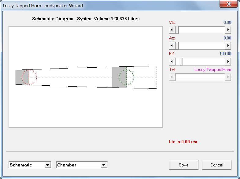

Tapped horns containing absorbent filling material can now be simulated in the Loudspeaker Wizard - similar to offset driver horns.
CHANGE 2
Absorbent filling can now be specified for individual horn segments in both offset driver and tapped horns. Double-click on a Loudspeaker Wizard length slider value to toggle filling on or off for that segment. Attachment 1 refers.

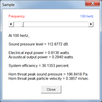

The functionality of the main Sample tool has been altered. The tool is still opened by either selecting the Tools > Sample menu, pressing F3 or double-clicking the chart, but a frequency value can now be entered by typing in the number and then pressing the Enter key, or alternatively by using the slider. The tool no longer has to be closed to enter a different sample frequency for the currently displayed chart. The abbreviated sample feature can still be used as before, by single-clicking on the chart.
The Up/Down/Left/Right arrow keys, the PgUp/PgDn keys and the Home and End keys can also be used to vary the slider frequency value.
Attachment 2 refers.

A chart has been added displaying the difference between the pressures on the two sides of the driver diaphragm after taking phase into account. Attachment 3 refers.
CHANGE 5
The Sample tool for the diaphragm pressure charts now also calculates the force in kilograms acting on the driver diaphragm. Attachment 3 refers.

Hi David, I just downloaded the latest version, but I can't seem to get this to work. Double-clicking on the length slider values doesn't seem to do anything...
Tried a couple dozen things and nothing worked for me either 🙁
Hi Brian,
Fr1 needs to be non-zero for the feature to work, otherwise things can get quite confusing. Moving the mouse pointer over a blue length value when Fr1 is non-zero should turn the font from regular to bold. Double-clicking on the value while the font is bold should remove the filling from that segment and change the colour of the length slider caption from pink back to the default red. Pink is used to indicate that a segment contains filling material, which might otherwise not be immediately obvious to the user unless the schematic diagram is being viewed.
Could you please let me know if there is still a problem with the operation of the feature.
