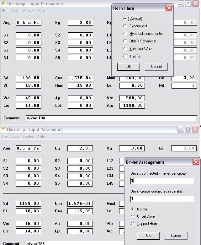

Hi David,
I have played for some years with hornresponse it keeps me from the street.
Thanks David for this great design tool. A few months ago I saw a site about tapped horns.
After that I downloaded version 19. And now I down loaded version 20.10.
Only I can not find the tapped horn wizard??
I can enter conical flare by hand and calculate.
What I do wrong?

OK, then why is 'normal' checked in your screen shot?
'Tapped Horn' must be checked in the 'Driver Arrangement' box for the 'TH Wizard' to be highlighted, which can also be done by double clicking on the tag next to the driver field to change it to Nd, OD, or TH.

OK, then why is 'normal' checked in your screen shot? 'Tapped Horn' must be checked in the 'Driver Arrangement' box for the 'TH Wizard' to be highlighted, which can also be done by double clicking on the tag next to the driver field to change it to Nd, OD, or TH. GM
I have tried that OD and TH are red. (Invalid data. Because there was no data entered)
I have seen screen shots of a tapped horn wizard I can't find that?
Make a 3-segment conical horn.
Make Vrc and Lrc = 0
Select Tapped Horn in Driver arrangement.
You should be able to select the TH wizard at that point.
You can't get the TH wizard link in the TOOLs folder highlighted until you meet all the criteria listed in note 8, pg. 16 of the HELP manual, so did you make Vrc, Lrc = 0? I see values in your screen shot. And inputted at least three TH sections? No design, no Wizard. You can input an existing design or just any numbers to activate the Wizard.
