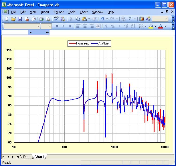

revintage said:When I read it -3dB in Hornresp is 45 and MJK is at least 50Hz. This means ca 10% diff.
Hi Lars,
Out of interest I compared the Hornresp and AkAbak power responses for your design example assuming half-space loading. As you can see from the attached screenprint, the low frequency roll-off points predicted by the two programs are identical - the Hornresp red trace is completely hidden beneath the AkAbak blue trace.
Kind regards,
David

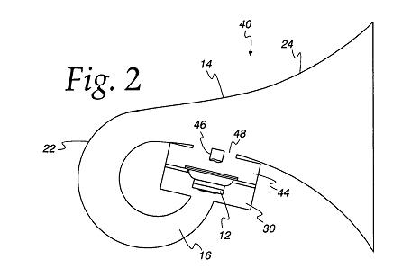

G'day Jim and Syd
Despite being a good idea, I don't believe Helmholtz resonators are used on the front side of the driver in many (perhaps none) of Tom's commercial tapped horns. I believe this is probably due to construction complexity, and the difficulty in changing drivers, if necessary. There is a good chance they are used on the other side of the driver, though.
Cheers
William Cowan
Cheers
William Cowan
Bill:
My thinking when I saw resonator, was that in a 115 style cabinet (magnet hanging in the mouth) that the helmholtz could eliminate some long path high frequency (100hz-ish on up) and would clean up the kick range with less constructive/destructive interference.
Seems worth playing with anyway, and was one of my nuggets of info gleaned from sitting down and reading patents.
G'day again Jim
I believe there is a chamber (and associated smaller throat) on the TH115. The magnet would not fit into a normal sized throat without the chamber. There is certainly none on the front side, though.
Cheers
William Cowan
Cheers
William Cowan
jbell said:Is it an easy thing to add the ability to model both a rear chamber as well as a front chamber.
Hi jbell,
A rear chamber could be added to the Hornresp tapped horn model relatively easily. From testing I have done however, it would seem that having a chamber between the driver diaphragm and the entry point into the tapped horn near the mouth makes very little difference to the overall result. For that reason I did not bother to include the option in the production version of the program.
You can of course experiment with such a configuration using AkAbak, if you wish.
Kind regards,
David
