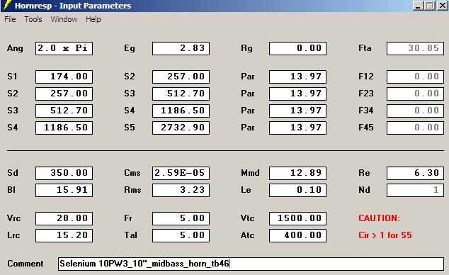

I just posted a mid-range horn with the Selenium 10PW3 in Post #188 here: http://www.diyaudio.com/forums/subwoofers/213685-bass-my-soldier-19.html Do you think it will make 2kHz?

Some basics.
Your throat must be smaller than the wavelength of sound you wish to create. If it is larger than the upper frequency you wish to reproduce it will not work so well.
Next.
You need a driver that will get you this high in frequency response anyway. This is directly related to the drivers voice coil inductance. Remember that to large an inductance cuts out high frequency. And there is pretty much nothing you can do about it.
Driver choice is very important. So as a quick way to figure out the high frequency response try the driver out in hornresp in a sealed or vented enclosure. The low end is unimportant take a look at the high frequency response.

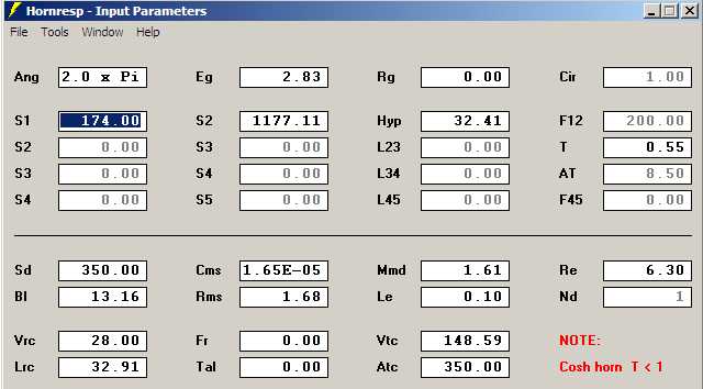

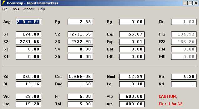

Hi David,
I found something I don't understand (well, nothing new there). Going into an existing simulation, I went to Edit/Tools/System Design/From Specification/Yes/200/2000/OK, and the program calculated new horn values for S1/S2/Hyp. That was expected. But then I noticed that the program also changed the Mmd from 12.89 to 1.61. Bug, or feature? Version 29.10 Product Number 2910-120519.

If you want to keep the driver, you should use System Design/With Driver. System Design From Specification also calculates driver parameters, but I have never seen a case where only Mmd changes. Usually other driver parameters change as well.
