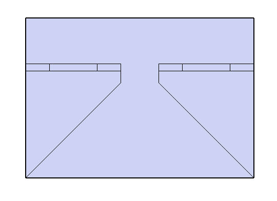

How about making it possible to start a tapped horn with a negative flair in stead of a normal expanding flair?
That little detail has it's uses.

Hi Mark,
As far as I know, it should already be possible - see attached screenprint.
Are you having problems generating a negative flare?

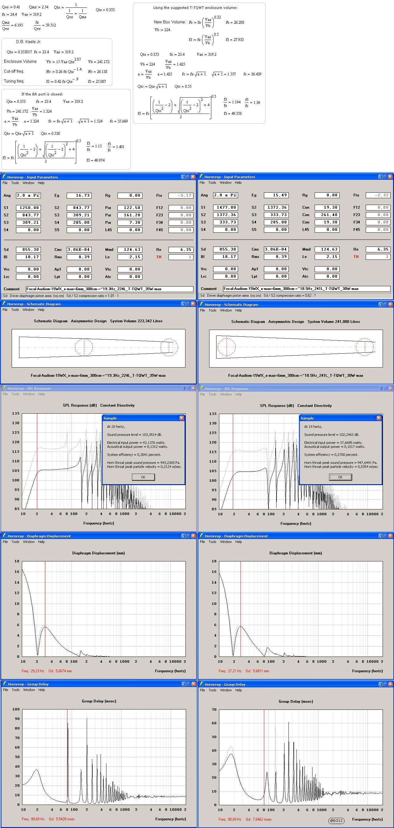

Here is an example of entering driver parameters:
I was not thinking of the DVC, so the LE looked high to me. Here are the corrected inputs for 2 woofers wired as a 4Ω nominal load.
Hint: Start by entering SD and double click in Cms, Mmd, Bl, Rms, and answer the questions to enter the parameters.

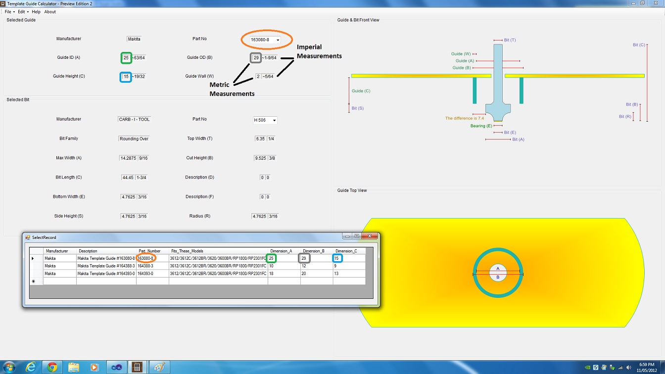

To better illustrate my point a thought just come to mind... I have been writing an app myself that visually demonstrates the effect of changing template guides and router cutters, and show the dimension on the same page as the specs like this...

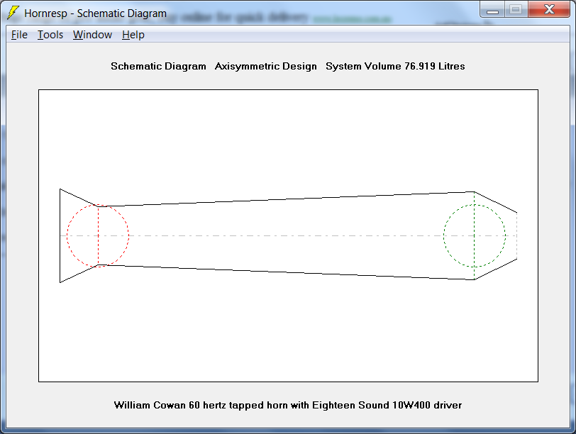

The Calculate Parameter tool enables Thiele-Small parameter values to be converted to their electro-mechanical equivalents, for use in Hornresp.
Try altering the input values, to see how the schematic diagram changes.
Vtc is the volume of the horn throat chamber and Atc is the cross-sectional area.

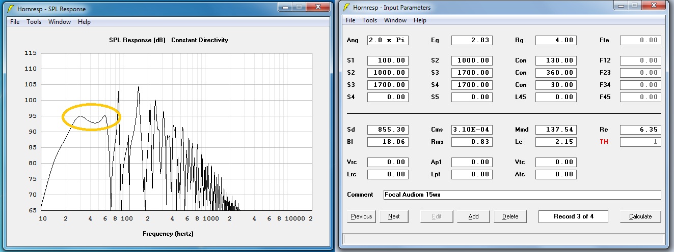

What is the "best" data entry order?
You have the classic two bump tapped horn. To smooth that out you need to alter the path length and or the woofer location along the path.
Both will alter the response and the efficiency.
Use the wizard, the best thing David ever added to the program. Move the sliders around that control the correct parameters and you will stumble upon the response that your after.
Then you will have to make the compromises necessary to get the enclosure size you can live with.

Hi Silent Screamer,
Post #2697
Try double-clicking on Sd while in the Edit mode, this will give you the T/S parameters. Are they correct? And, why an Rg of 4 Ohms?
Post #2697
