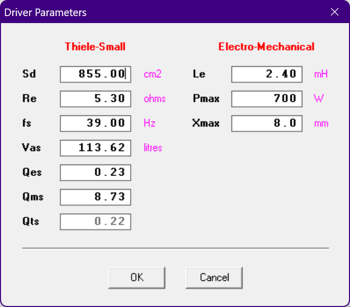

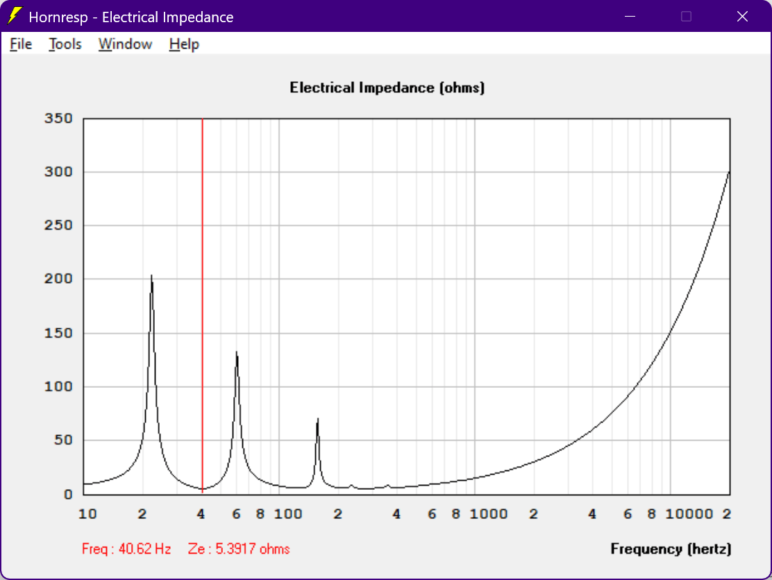

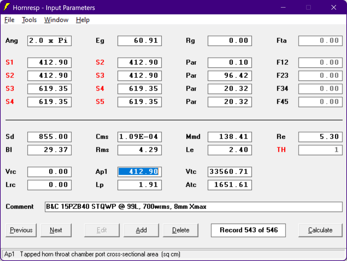

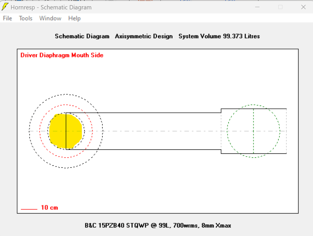

@BP1Fanatic - I'm having health issues and botched the input for the 99 liter B&C 15PZB40 cabinet. Would you walk me through the help wizard to get the segments and tap so I can run it correctly and see what other drivers might fit ?

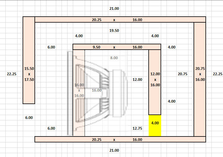

The number of segments - where its tapped -

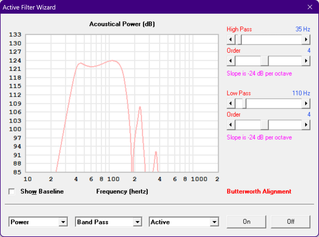

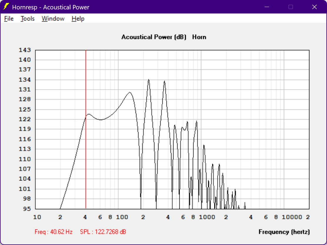

Is this correct? - if not please, cprrct and explain

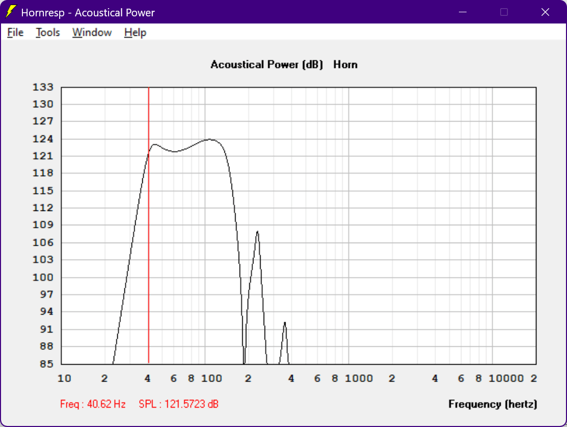

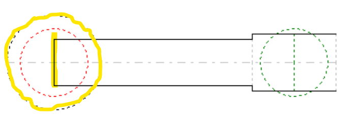

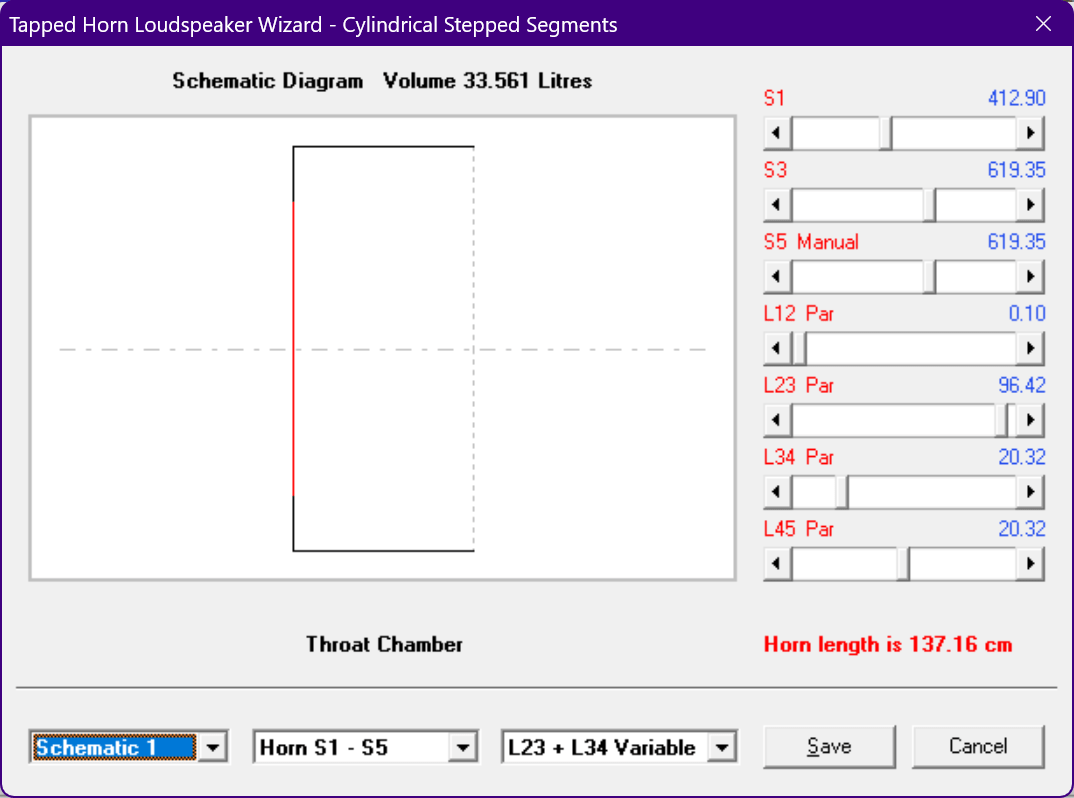

The throat tap point is basically anywhere along the front side of the throat chamber (Vtc).
L12 = .01 close that the throat chamber panel to a 16" wide by 4" high opening.
Do you think the tap needs to be moved to here?
