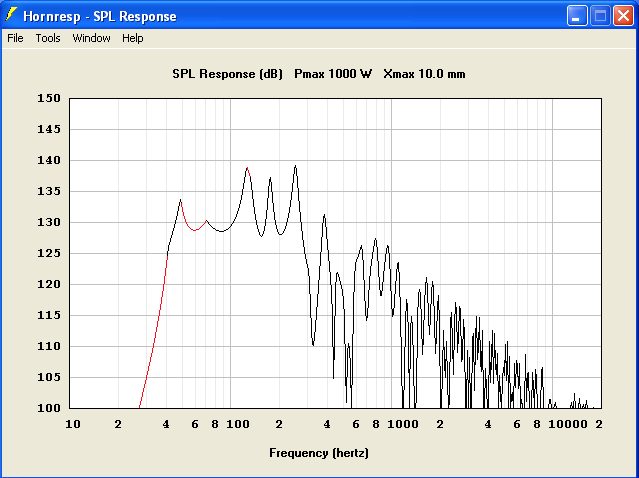

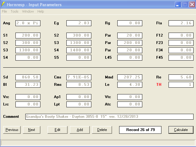

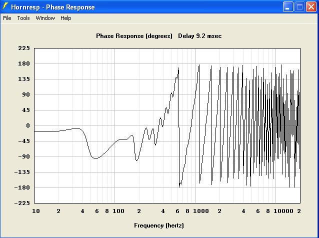

O.K., here it is - The GBS15 (aka Grandpa's Booty Shaker). I have created quite a few experiments in HR, but this is one that that would be simple to transfer from HR into an actual build. I used the simplest tapped horn form to create this:
https://www.dropbox.com/s/12l8esyongqrh1w/Simple Tapped Horn Example.png
For a driver I used the new Dayton Audio PA385S-8 15" Pro Subwoofer. It looks like parts-express.com will start selling next week:
Dayton Audio PA385S-8 15" Pro Subwoofer 4" VC 8 Ohm | 295-040
My goals in this design were to keep it as small as possible and to weigh less than I do. It needs to fit easily on a refrigerator dolly. This would be used for a rock band PA sub, so I don't need the low-end extension the hip-hoppers do, solid from around 45Hz to 100Hz would make me happy. Here is my HR input screen:
https://www.dropbox.com/s/fjp370nohlqs66g/GBS15 HR Input.png
Using the simple fold mentioned above, it looks like this horn would end up being approximately 17" x 17' x 48". Here is the frequency response:
https://www.dropbox.com/s/8skn0voocbzdvpt/GBS15 - SPL.png
Here is the Max SPL with 1000 watts and Xmax 10:
https://www.dropbox.com/s/7c9heun30wvqqkg/GBS15 - Max. SPL.png

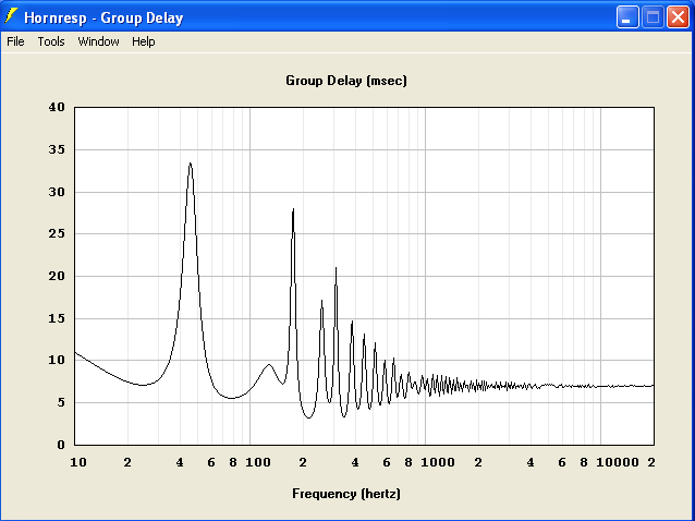

Here is the phase response:
https://www.dropbox.com/s/aep375t7m03r1le/GBS15 - Phase.png
I am not totally up to speed on exactly how horn paths modify acoustic impedance or group delay. Here are the graphs for that info if anyone would like to comment:
https://www.dropbox.com/s/oqi2llb8p0zw2ra/GBS15 - Ac. Imp..png
https://www.dropbox.com/s/is4dc3q5fgaa4kp/GBS15 - Group Delay.png
I am not sure I am going to actually try to build this, but I would appreciate comments of the plus's and minus's of this design. Remember, I like criticism - it is the only way I will learn. I would love to hear any way I can make improvements. And if this design is a pile of shite, please let me know and I will start over again. Thanks.

So... a quick peek at the schematic doesn't look like what I expected. Either I'm confused about what a ~.5 T flare looks like or this isn't an 'ideal' [max BW] TH.
I haven't historically had much luck trying to figure out why your sims look like they do based on the math you use but I'm open to discuss it. I think I know the simple answer but that hasn't done me much good so far.
Hyperbolic is so slow expanding that any < 1/2 WL long look conical in HR and since THs are typically only a 1/4 WL long.........
No, it's nowhere near a reactance annulled BLH/TH simply because the driver's specs are ill suited for one in the BW of interest.
Sorry, I'm not as long as Tom and other pro horn designers choose not to, though I'm curious what you think the simple answer is.

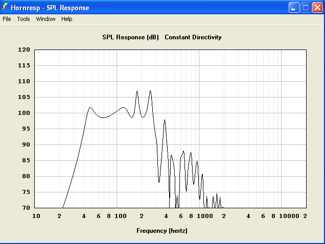

Long story short, very nice, especially for a first try. But personally I probably wouldn't build this one.
Short story long, it doesn't compare especially favorably to a ported box a fraction of the size with the same driver.
The ported box shown is a bit less than 1/3 the size of the tapped horn. I didn't have a lot of time to spend on this so I didn't match f0, excursion, etc exactly and I didn't bother to make sure the ported box has an adequately sized port to ensure there is no velocity problems. Also the ported box is shown with a LOT more power than it's rated to handle. Depending on the type of music this may or may not be a problem. (Even the tapped horn is shown with more power than it's rated for to get it to xmax.) This power vs thermal compression issue is a whole topic in itself, and has to do with crest factor, duty cycle, and all kinds of other boring stuff. But theoretically drivers in tapped horns should be able to handle a bunch of power, they are basically sitting inside a fanned duct.
Tapped horn - 190 liters, 1250 watts
Ported box - 60 liters, 1800 watts
So if you compare at low power, like 1 watt, there's a dramatic sensitivity advantage for the big horn. But compared at xmax there's not really all that much difference. In the real world the tapped horn would probably dominate in a fashion not reflected in this simulation, but I prefer to build from a simulation that shows at least a bit more advantage compared to a much smaller ported box.
If you already owned the driver and had a stack of wood lying around waiting for a purpose, and the only goal was to get the most spl you could from these two ingredients without going full front loaded horn size, this would not be a bad choice. But I'd keep playing with the design and try other drivers to see what you can come up with. I think you can do better. Maybe try drivers that are known to work well in tapped horns, try using the drivers that Danley does for subs that play in the passband you are interested in.

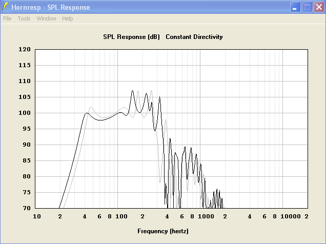

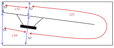

GM, thanks for you input. So it looks to me like you version would work out to be slightly thinner, but about 10" longer.
It looks like both of our models are within about 10% variance except for S1, S2, and L23. I am curious on your thought process when you came up with this design, so let state what I believe you may have been thinking, and please correct me if I am wrong.
Lengthening L23 appears to give more low-end extension at the expense of a longer cab. Looks good to me.
Decreasing S2 appears to smooth out the frequency response slightly. It also increases the compression ratio. How did you chose S2 as the best compromise for this value?
Decreasing S1 appears to have little effect. My thinking on this is that is for this type of horn layout, you would set S2 first. Since the baffle board (horn segment divider) is one board, S2 would then become a pivot point. You would then adjust the far end of this board to be centered between the two opposing cabinet walls, and where ever the other end ended up being, that is your S1?
Posted below is a comparison of our two models. Yours is the black trace, mine is the gray trace.
Thanks for your time.
Hey, thanks for your honest opinion, and for putting the work into the WinISD simulation. I will play around with this driver in WinISD tomorrow so I can better understand the benefits and drawback myself.
Also,thanks for also bringing up the subject of a 1 watt simulation vs. a max SPL (max Xmax) in a real world test. I will have to study that concept a bit more. I actually have some designs I am more proud of, but while they look decent in HR, actually turning a more complex fold pattern into a real cabinet is something I haven't quite mastered yet. That will be a 'question of the day' that will come up very shortly, maybe even tomorrow.
I didn't do anything in WinISD, I don't like WinISD. In the picture I posted the dark line in both the frequency response graph and the excursion graph is the tapped horn and the lighter grey line is the ported box. (Both simulated in Hornresp.)
As far as horn folding goes, you just go to the schematic drawing in Hornresp, click File - Export - Horn Data and use the cross sectional area vs path length information to draw out your horn. I draw mine out on paper, some people use Sketchup, some people use Excel, and there's even an Excel spreadsheet that will attempt to fold your horn for you. Some people draw the horn out as a straight horn on paper and cut it up into pieces and put it together like a puzzle. There are lots of options. There's even a few tricks you can use to make folding a lot easier than you probably think is possible. If I absolutely had to I could design and fold a horn complete with plans to build from in about an hour although I prefer not to rush the process.
If you want the fold to be accurate (so the sim matches the measurement of the finished product as closely as possible) you can study the advanced centerline method of horn folding. I did a recent study on advanced centerline vs centerline methods - Horn Folding - a brief study of the centerline vs advanced centerline method - and there's also a lot of other info in there about general horn folding considerations not specific to either method.
