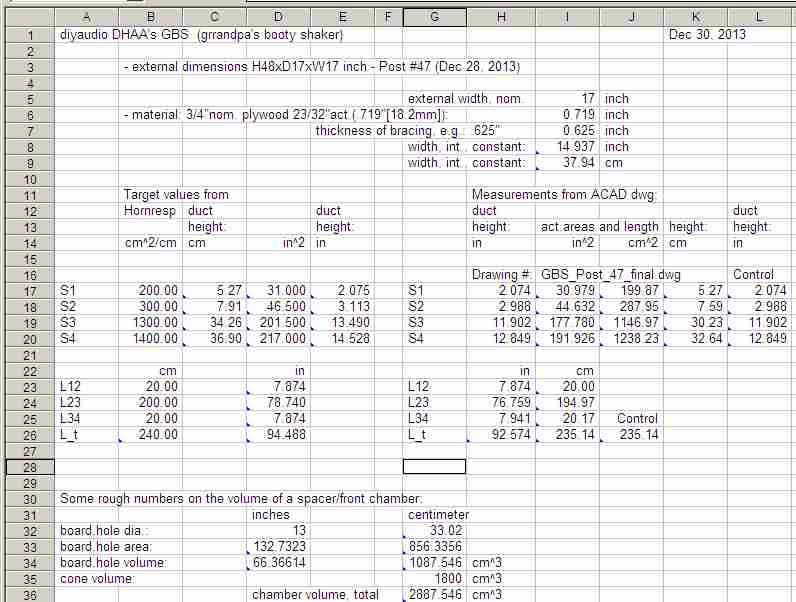

Hi DHAA,
I'm on vacation - yeah! In a little while I'll get to do some plumbing. Oh well.
I make my self a spreadsheet (I still use Quattro Pro) to convert the cm to inches, and the duct areas to duct heights. It makes it real easy to add in whatever bracing to get a quick look. For most of the boxes for which I simulated the effect of bracing the difference was negligible. If you cut holes/openings into the braces it becomes even less important to calculate this.
I'll attach a screen shot of the one I made for your enclosure (I use the same basic template, thus I'll have tags hanging on that may or may not have anything to do with what I'm working on, e.g.: the front chamber and spacer volume at the bottom of this one. It beats starting over every time.).
When you subtract 2x left and right side thickness, and the thickness of the bracing material you end up w/ the internal width, this is used as a constant to divide the Hornresp areas, and to arrive at the duct heights. In this example I'm entering S1 into B17, convert it to in^2 in D17, and divide by the internal width constant from I8 in E17 to get the duct height in inches; same for the other areas.
I also have set up a calculation area where I enter the measurements from AutoCAD: enter duct height in H17, multiply w/ internal width constant in I17 for the area in in^2, convert to cm^2 in J17, divide by the internal width constant I9 (cm) in K17 to get the internal duct height in cm (don't need it, but may as well), then convert the height back to in as a control.
Probably just the poor mans way to do this, in some drafting environments you can automate all of this. I hope this helps,
P.S.: Tried to check this post for errors, but you get what you paid for. 🙂

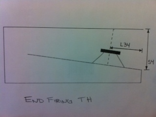

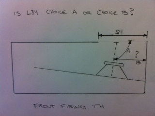

Bonus Question
First off, thanks for your comments everyone. Now that I understand how the bracing is compensated for, I think I will ignore that temporarily until I get a better understanding of some other design elements that may have a greater effect on output. At least I feel better knowing the proper answer - that is one less thought rattling around in my head.
That brings up the Bonus Question. Please take a look at the two drawings I attached. The first one is the end firing TH design I used in my GBS15.
The second drawing is that cabinet converted to a front firing TH. My question here is does L34 need to be changed? Choice B would be calculating L34 the same way it was calculated in the end firing GBS15. Choice A would be recalculating L34 to the new horn mouth. The difference would be fairly small, is it worth worrying about?
Also, if choice A is the correct way to do it, I have one further question. Having the horn mouth on the front of the cabinet gives me room to play with the S4 dimension. Would the proper way to calculate L34 be to the center of the S4 opening? If so, it seems to me that changing S4 would also change L34 slightly. Thanks

Hi DHAA,
Picture #2 would be the preferred method, much better access to the driver. As to the final size of the port opening I would stay w/ the same opening as originally designed. It's really hard to figure out what exactly is going on around the driver inside the duct w/ the front port, and how long is L34, do you measure it from the middle of the duct, or from the effective center of the diaphragm? It would also be easy to provide cleats so that an enlarged or a reduced size mouth can be installed, even a keystone if you want to play w/ that idea. Those cleats would also stiffen the port edges.
Neither of those drawings are proportional to the GBS15's dimensions. I just drew some generic horn shapes to give you guys a better understanding of what I was talking about.
At what point is it best to make the L34 measurement from?

As I said above, there is no definite answer to that question, if someone would hold my feet to the fire I'd go w/ the effective center of the driver diaphragm, i.e.: 10.287 in the pdf above. Now you're at the point of build and measure, e.g.: how does the mouth size and location affect SPL and impedance? How close is the result to the simulation. Remember Tom Danley's advice: measurements trump simulations.
