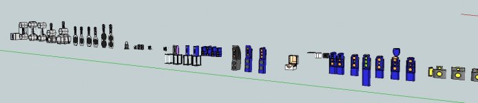

Once I realized how the "Measurements" box worked, it has really made things a lot easier. I was trying to stretch things perfectly and was getting very frustrated.
I have been punching holes in things per your instructions all day today, I am glad I finally understand that process. Thanks again. Do you use SketchUp professionally at all, or just as a hobby?
The right click "Entity Info" is also an invaluable tool. I make most of my circles 60 segments to make them smoother looking.
I have been using it to design my own electric trike for the last couple of years. So I have done countless revisions using sketchUp and even modelled a few speakers. I have spent thousands of hours using it for personal use.

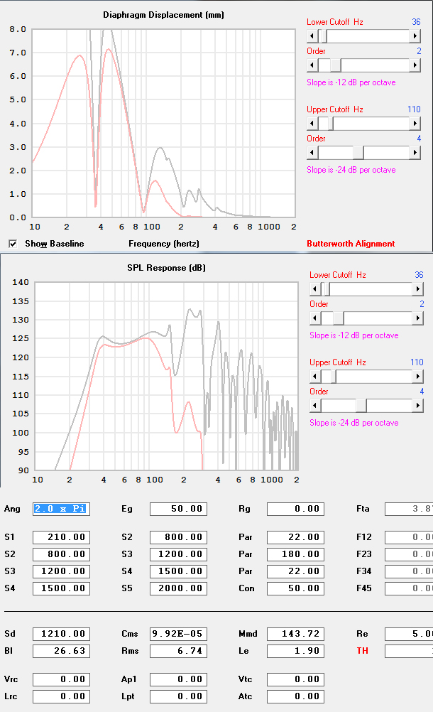

here's my best bet... notice my input parameters for the driver are different than yours. I just went off whatever they had on the BC site. 50 volts, 36hz 12 db oct BW hipass filter.
Nice work, thanks for helping me understand this correctly. It is interesting to see the effects of the upper cutoff too, really smoothing off that mess above 175Hz.
My first steps with Hornresp were just taking proven cabinet designs and changing drivers in them to see what differences that made. I actually modeled that B&C driver a few months ago, probably getting the information off Parts-Express.com. Humm, makes me wonder about the accuracy on the specifications they are providing.

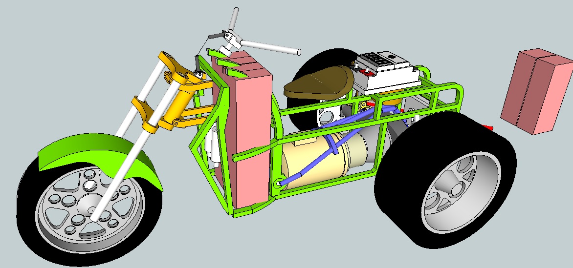

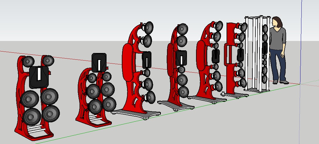

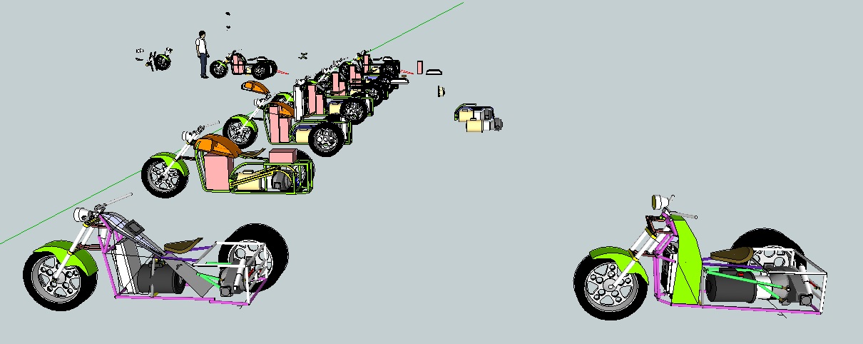

Hey Paul, thanks for the tip.
Nice looking trike. You definitely know what you are doing with SketchUp. Those speakers look very cool too, I blew that picture up a bit to get a better look - those are some very modern designs.
Those are just a few of the crazy ideas I have come up with. Just let me know if you need to know anything specific... One last tip I tend to copy and paste a lot, you wind up with lots of variations of the same thing, but it is a lot easier than trying to remake the modifications again. Just select like I showed you then ctrl c then ctrl v (trying to get it to go where you want is quite an art) remember to deselect the copied version once you make it...
Looks good, I get a ~same-same response except a bit less net Vb, so a little less mid bass peak SPL.

GM, would you care to make any comments on what prompted those particular design changes?
If I understand some of just a guys comments, you seem to have some sort of proprietary horn modeling system. If so, there is no need to share you secret formulas, but how about a few hints on how that came about?
Looks good, I get a ~same-same response except a bit less net Vb, so a little less mid bass peak SPL.GM
I didn’t rethink sine143’s design if that’s what you mean. I just ‘ran the numbers’ when Chano first posted, planning to post it as part of a response to show it needn’t be all that large once he started his own thread, but the extraordinary weather has kept me from finishing it, so just posted it as a sort of a +1 when I saw sine143’s, i.e. either one seems a viable design or at least gives Chano a couple of good examples to modify to maybe find something even more suitable for his app.
Well, I’ve a proprietary Excel design routine based on my understanding of how to convert a compression horn alignment into higher order BP/TP/TH ones in both imperial and metric units using math long time available in AES papers, patents and more recently posted on the net, so the ‘secret’ isn't the math, just knowing how to apply it.
