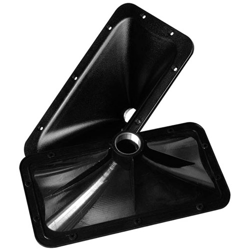

Any idea why the Pyle horn and the JBL horn are virtually identical? Just serendipity, or is it literally the same part? I noticed that the pic you have of the JBL part from the econo-wave has the JBL logo molded into the plastic. I'm assuming Pyle left that detail out 😀
The Pyle is a copy of the JBL but with no JBL logo, and a metal threaded insert.
Here's a pic of the Pyle PH612 taken from Parts Express.
