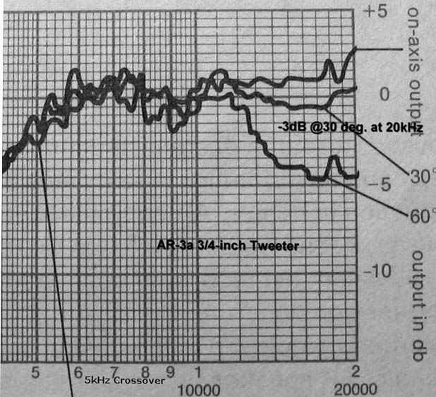

YO, Patrick!
AR3a tweeter polar response.
Have no illusions it performed like this in the product, tho:

Here's more complete AR3a polars as measured by Roy Allison hizself:

YO, Patrick!
That ripples, is it HOM? 🙄 First it was HOM, then ripples, now directivity. If I remember it o/k its due an error of someone who took 6dB for a half. The XT1086 has the same directivity issue as every CD device, including Geddes'. Narrowing in the first octave, then widening again up to ~10kHz. JBL biradials swap horizontal with vertical up there. All in all hassle while voicing the speaker. If someone would have a cure to that?!
