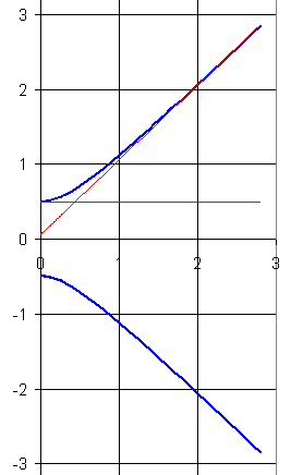

soongsc said:
when I look at the explanation on the Excel calculation, it does not seem to me it's an OS expansion profile. Even if it did fit the OS profile, CNC would be the only way that I know of to make it, there are lots of consideration about data point resolution and cutter offset issues to consider if you rely on Excel instead of a normal CAD program. Not something easily educated over the NET.
It is an OS profile everywhere around the ellipse. I checked it at several angles to make sure it worked. I used Excel because it's easy but it was just to test the concept and draw some lines, not something to make a mold from.
Actually it would be quite easy to ghetto a horn that came pretty dang close to the OS shape with styrofoam and a hot wire. As the pic shows, the OS is pretty close to a straight cone, a hole drilled through the center and a gentle curve to feather the two together. So clamp a block of styrofoam between two patterns with the hot wire running through the center. The rear pattern is just a hole a little bigger than the wire. The front pattern is the shape of the mouth -- round, elliptical, whatever. Run the wire around the mouth pattern to cut out your 'cone.' Then drill a hole the size of the throat from the back side. Next, sand a smooth transition in the throat area. Finally round over the mouth.
