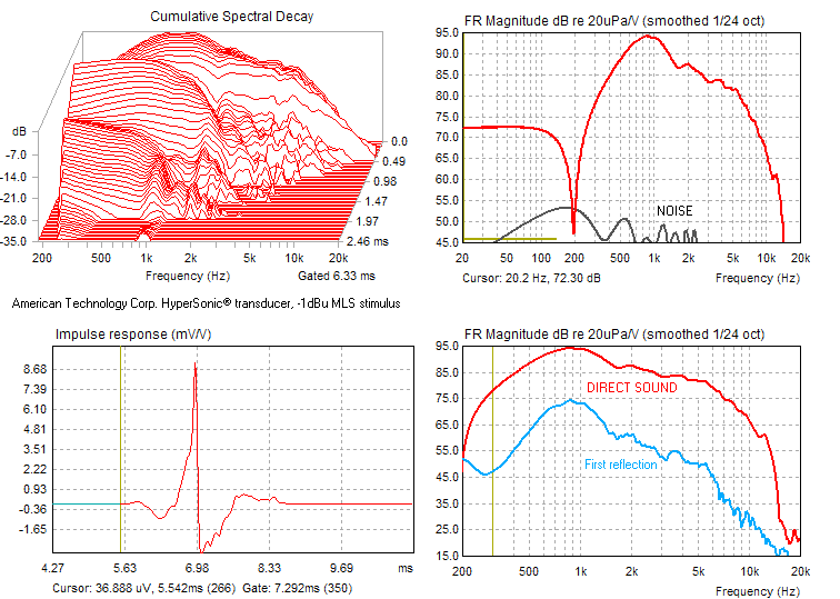

Just in case. A high directivity ultrasonic transducer to compare with a waveguide, 10deg offaxis:
http://www.atcsd.com/site/content/view/34/47/
Another "massless" speaker?

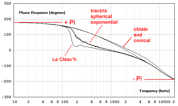

Hello,
The shape of the leading part of the pulse response of an equalized driver mounted on a horn (or a waveguide) is related to the high frequencies content of the response.
Two things are important to consider: the relative level of those high frequencies versus the lower frequencies of the response and also their relative group delay.
Generally speaking high frequencies are the first to arrive but the shape of the leading edge depends on their relative level and relative group delay to the other frequency content.
Phase should be also important to consider too because for every duct (cylindrical... conical, exponential...) phase varies between an asymptot at +Pi at 0Hz and an asymptot at -Pi at very large frequency (this means that HF varies progressively , more or less quickly, to become out of phase with medium frequency. (see attached graph for unequalized drivers on different horns and waveguide)
Best regards from Paris, France
Jean-Michel Le Cléac'h
