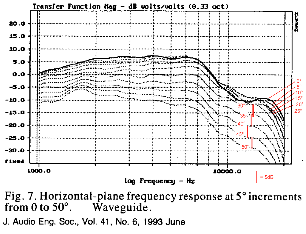

Hello Earl,
I am sorry I did an error while typing:
"at more than 15° the response fall at 5dB/5°"
I should have written:
"at more than 25° the response fall at 5dB/5°"
The graph from your JAES paper I used for that is in attached file with my measurements. If I am wrong I accept to be corrected...
Best regards from Paris, France
Jean-Michel Le Cléac'h
gedlee said:
I didn't disregard your question, I told you why it was not important to me.
There "may be" a way to lower the directivity control, but that would necesitate an ill advised compromise in something else. As you stated yourself:
However I would strongly disagree with your last sentence as it is completely incorrect. A compression driver forced down to 160 Hz will have a huge excursion and lots of distortion while a larger piston source is operating in its region of minimum distortion. So if the directivity is the same but the piston source has lower distortion it would seem to me that even you would be using a piston source in the range of 200 Hz - 800 Hz.
And your numbers for off axis falloff are completely wrong. The response of my designs are down by about 10 dB at 45° or about 1 dB / 5° not the ridiculous 5 dB / 5° that you quoted. (see www.ai-audio.com) It's very difficult to have a decent discussion when you use data that is so far from reality.
Why don't you publish some full system polars of your systems so we can all see how well they work?
Its easy (and kind of pointless) to make statements like"
and show some pictures. But where is the data? The real proof of what you are saying? I have data and I have reviews to support my position.

Jmmlc said:
Hello Earl,
That design is more than 20 years old! Why do you go to something that is obsolete and not my much more recent designs? This is not an open minded approach.
And beyond 30° I WANT the sound field to fall as fast as possible. Why do you imply this is a bad thing? You and I seem to have completely different ideas about sound reproduction.

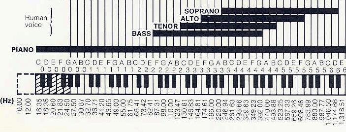

just a reminder, the human voice has lower fundamentals than 200Hz. Heavy baritone starts at about 80Hz(!).

How are they different? That's the very definition of constant directivity and uniform power response, no?
Outside the controlled sound field, however, we WANT it to fall away quickly to achieve an element of independence from the character of the room. We're not doing omnidirectional here; the objectives are different.
