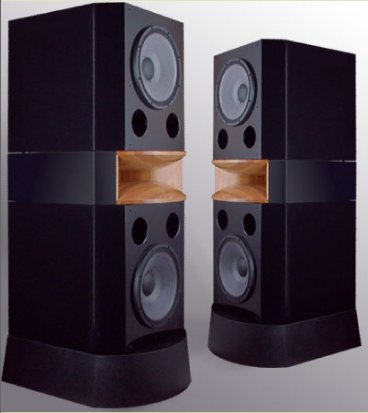

Whats the final product 4x bass + 2x Iwata? = Giant D'apolito?
I have considerd this configuration, but I am not real sure how it would work in room.

Problem with MTM is XO. From what little I have read, It forces your hand on what kind of XO you can use. I am going to be driving these things with High Z amps, trying to macth impedances. Something along the lines of the F! or 2 and also variations of J2 and F6. All these can be setup to operate as low DF amps. Dunno. we will see. Gotta get the wife on board with the design first.

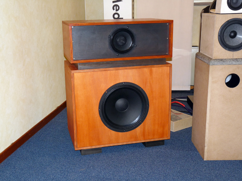

noticed this one yesterday
I like the classic design
apparently its with 8" coax
could be a CD/horn instead
the low mounted woofer could be a problem if you want it to play midrange
but a simple low stand-mount would be easy cure
btw, due to the small coax this one would probably be ok in the MTM you wanted 😀
